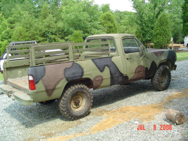

Here is a pic of the beast and my rattle can camo job:
I'm under the impression that the H1 wheels will rub on the SRW front 8-lug axles....the dually front hubs are supposed to be the ticket for running the H1's.
Mean looking truck BTW!!
