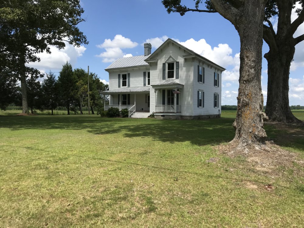

The day we bought it:

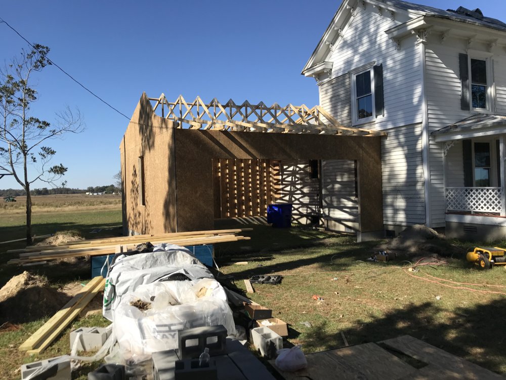

With the layout of the house, we had to put the garage on the left side of the house to work better with the existing roof lines and proposed floor plan.
Garage taking shape:

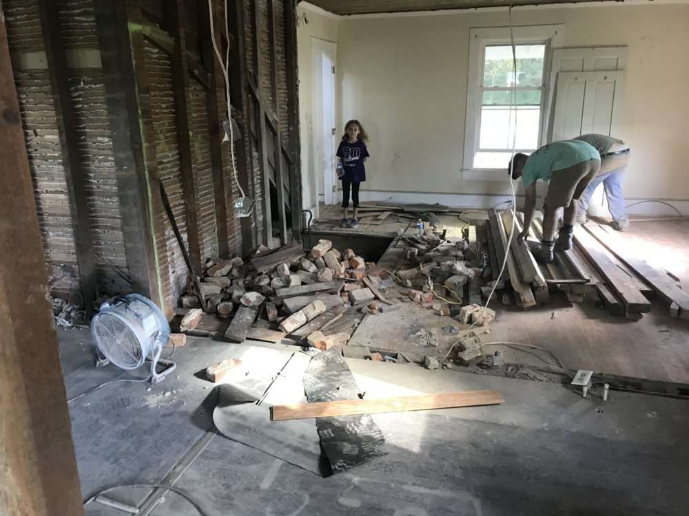

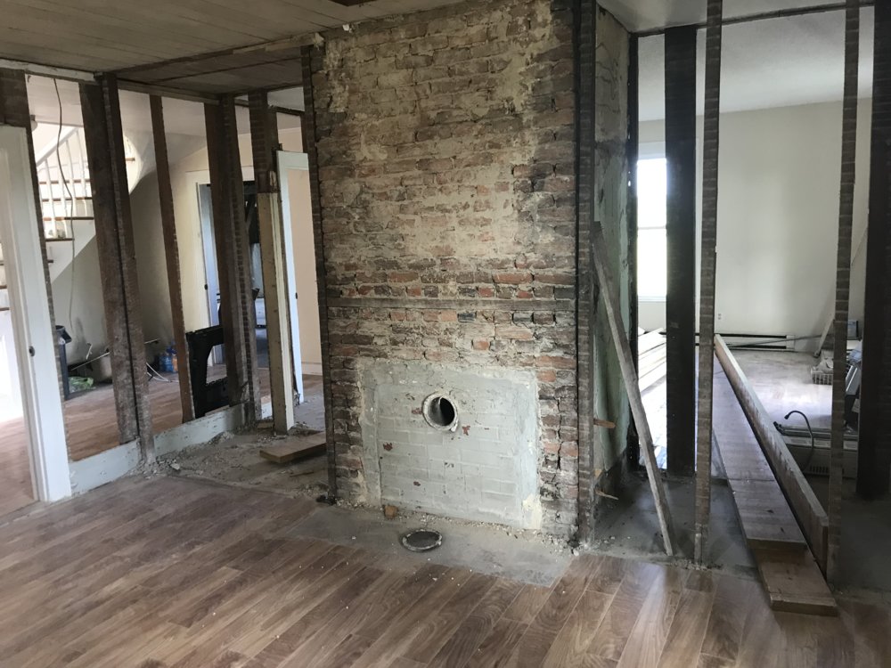

Wall and fireplace demo in what will now be the great room:
Dining room fireplace demo.
I saved most of the whole bricks from the fireplaces so I can repurpose them on the new fireplace in the great room and sidewalks.

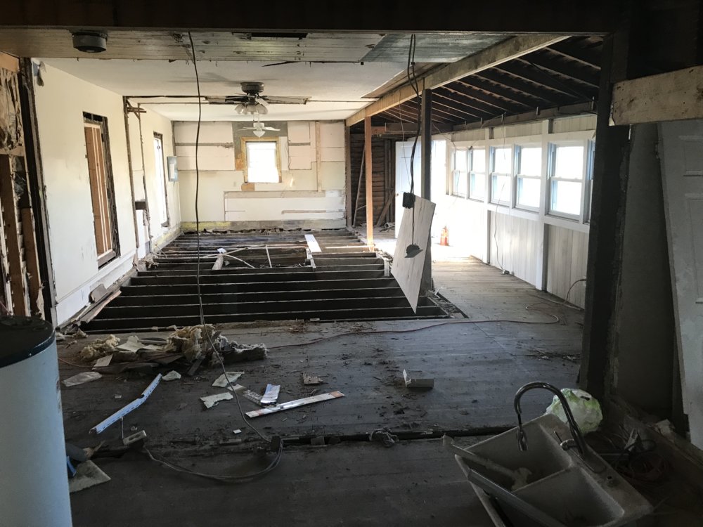

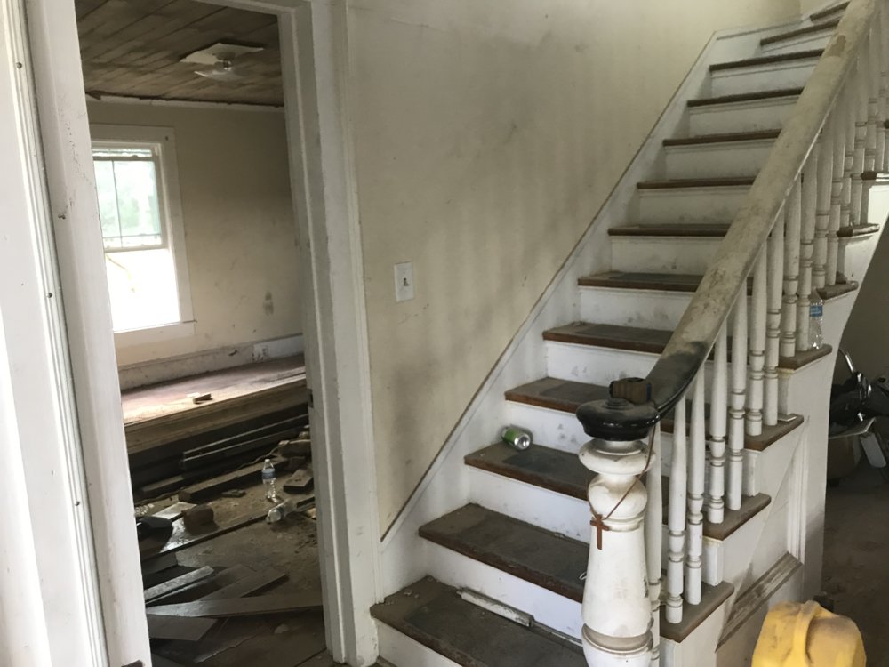

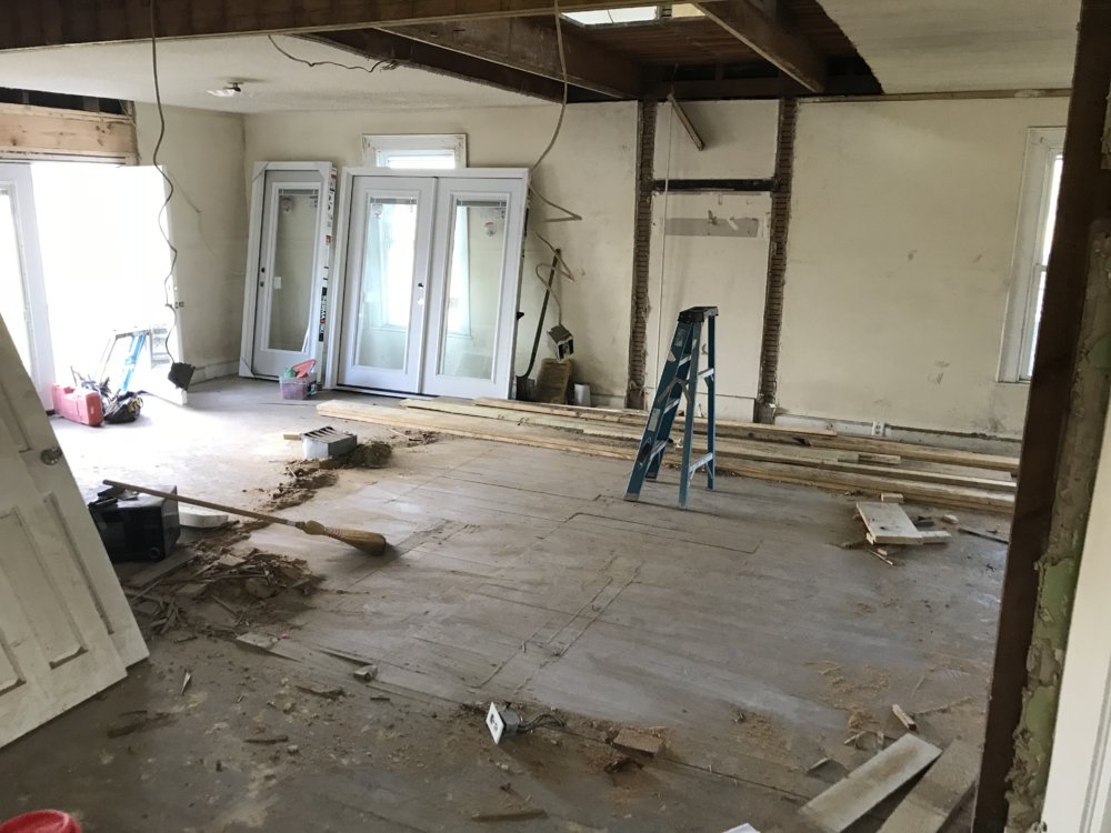

LVLs installed and walls removed for an open concept since that seems to be all the new rage these days. And, getting ready for new floor joists and start if new framing. Looking at great room; French doors ready to be installed for the back deck.
In the new dining room looking towards what will be the kitchen (where flooring remains) and the rest will be master suite with French doors leading out to the back deck.
The make shift kitchen was located on that far back wall. It all had to go.
Believe it or not, the house was in reasonably good shape for the age. It was well taken care of, just ugly and in dire need of updating. We found some roof leaks around the chimneys, which was to be expected as well as in a small portion of the “sunroom”. I think we replaced a total of 7 rotten boards, total. And, none of them were significant structural members. That was a real good sign.

I don’t disagree, but I’m pushed up against the property line and septic tank with just 6” to spare.

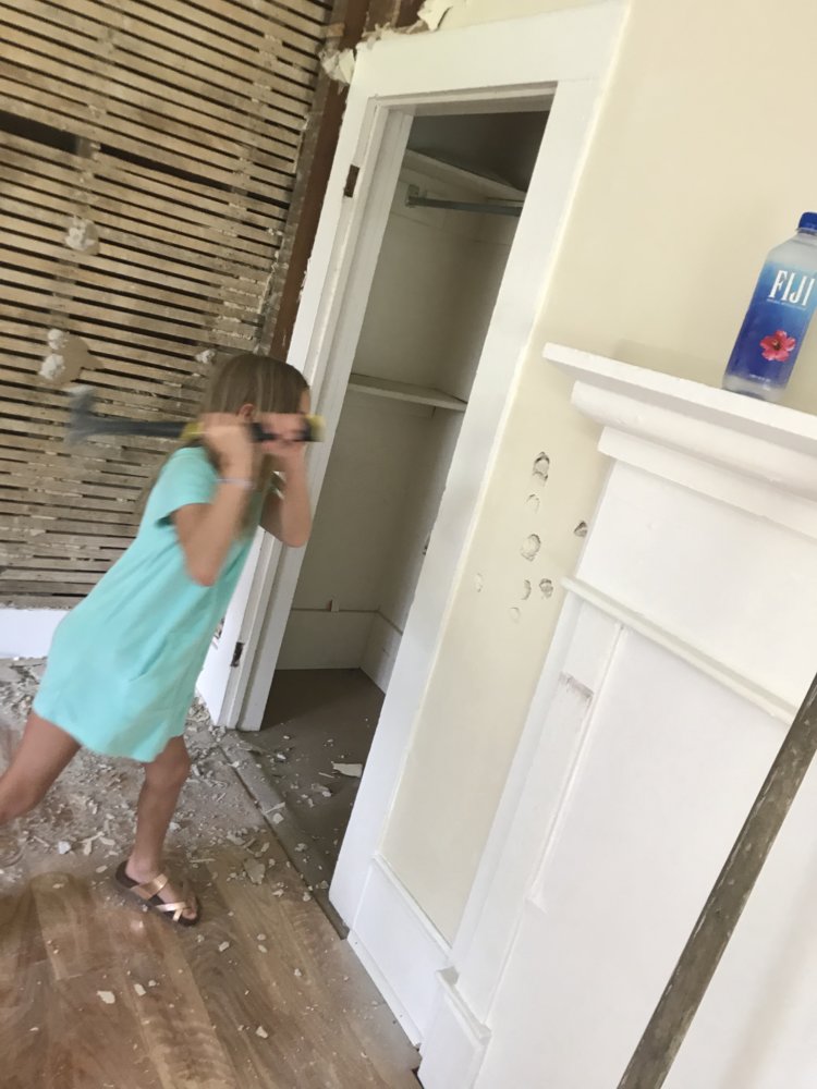

I put the kids to work with the hammers to do some demo of some of the walls. Free labor!
And then a picture of the back of the house. One of the things that makes this house so beautiful are the really large oak trees in the front yard. Bri’s Yukon XL is parked beside the large oak tree for size reference. The large trees up front are at least 4’ diameter. Simply beautiful.

This is the house they all grew up in. At the prime, this house was really luxurious for the area and timeframe. Some of the old locals stop by and tell stories from way back before I was even born.
