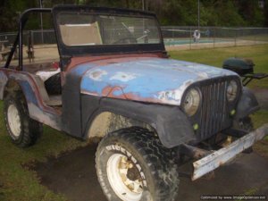

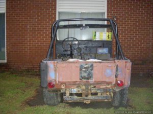

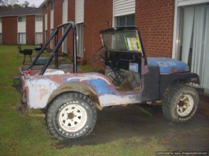

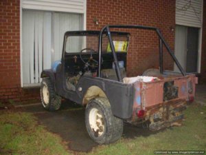

Okay so I finally got to a point where I could sit down and upload everything. I'm new here and to the Jeep world. This is my first build and first major modification project so alot is trial and error. I am to the point now where the Jeep is all torn apart and reduced to chassis and axles. I purchased my engine and tranny and trans case from raven mad and have seen the jeep in person at the early stage and that jeep has set the tone for my build. I want to take parts and functions from different year jeeps, i.e. interior, body, etc. I have alot of ideas but need alot of help. haha. Thank you guys very much and I hope you enjoy. PLEASE i repeat PLEASE give your two cents, i am VERY open to suggestion and my jeep is pretty much a blank slate so ideas are great. Also i apologize in advance for all of the questions i will ask in advance.
These are as soon as i got it
