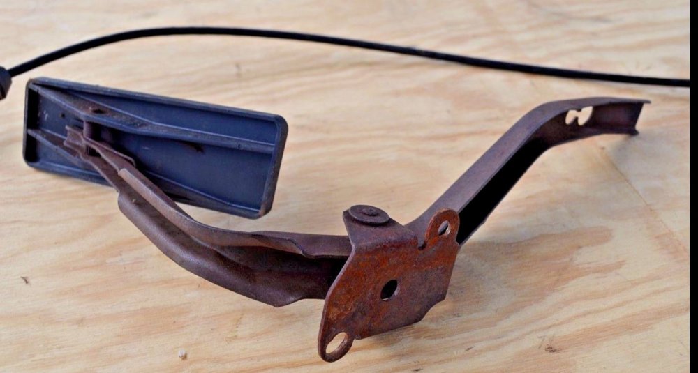

Hi, I am rebuilding a 76 cj5. This is the red-headed step child year. Power drums all around, weird
fuel filler etc..
I bought a cj pedal off ebay. They all look like this first pic. Every one. I need a 2 bolt style like in the second 2 pics. I can't find anything anywhere talking about this difference. Anyone know what i can do, look for?
Tough to say. It almost looks like the bends on the 3 bolt don't match the firewall. I looked in my 74-79 tsm and this should be the pedal for all those years.
The pedal is slightly different. I had to change mine when I added the under dash AC unit to my 86 scrambler. Cant remember where the interference comes in at but it had to be changed.
