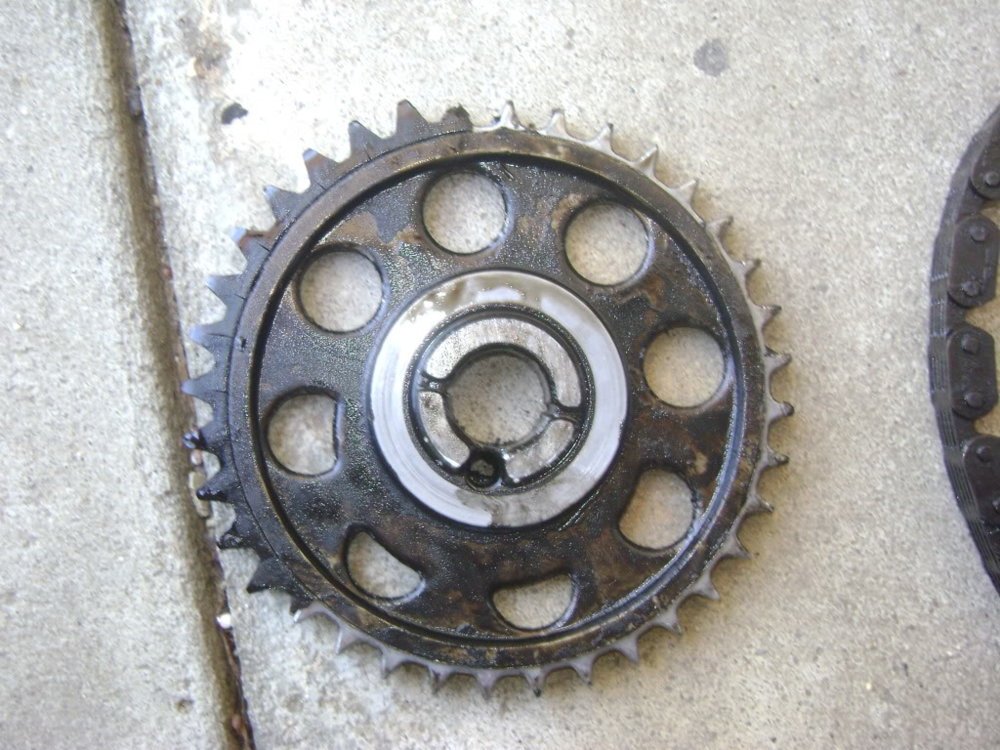

That's not terribly far off if you jumped time...doubtful you hit a valve. But I thought it sounded like it jumped. So 2-3 hours of your time and a $30 chain...you'll be good to go.
My '78 351m jumped more than that & replaced chain & water pump (while it was off) in the driveway on a cold, windy day. Drove it another 15 years
See all that missing nylon...kissed a plug...head of the plug broke off...no serious damage. But did have an interesting little ball of spark plug bouncing around in the cylinder.

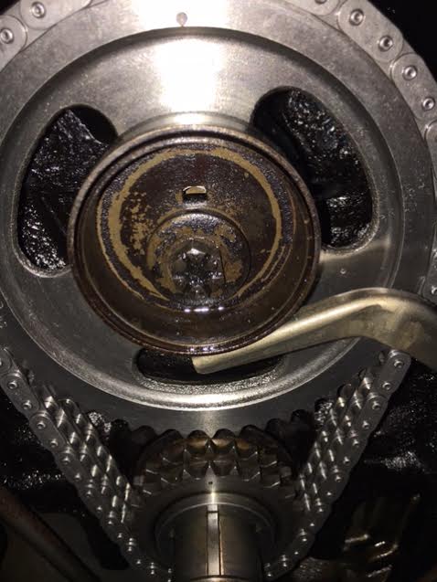

Looks like its jumped timing again! #1 cyl at TDC and distributor rotor not pointing at #1. So the question is what in the world did I screw up????
Uggghh!
OK, what the heck has happened here...???!!??
Dots were together when I installed this damn thing and now they are 180 deg off. I can turn the crank by hand and hear a hissing/air noise from some where in the engine. Seems weird. Do I have a broken cam or crank or what?
Rotate the crank one more full time...your dizzy is probably 180* out right now too. The hissing is probably the air in the cylinder escaping the plug holes.
This. The crank spins twice for every rotation of the cam.
Also you'll hear compression blowing past the piston ring gaps into the crankcase as you turn it with a wrench, that's normal.
OK Ben and Tim C, you guys are of course right. Got the dots lined back up by rotating crank as you said. With dots lined up, #1 cyl is at TDC as I think it should be.
Unfortunately Ben, I cannot take the dizzy pic as it is not installed. I pulled it out to look at it first before I opened up the front cover. I was thinking something might have happened to it so I pulled it to see. It is not broken. However I can say for sure that before I removed it, with #1 at TDC, the dizzy was not pointing at #1 but I don't think it was 180 out either.
So, something happened that was very much like the first time it seemed to have jumped timing. Maybe it wasn't the TC after all, either time. As noted before, it seemed to be running just fine after the last time I put it together. Drove it around for a while and then the "bang" and it dies. Am I barking up the wrong tree all together here? At least I have a nice new TC.
