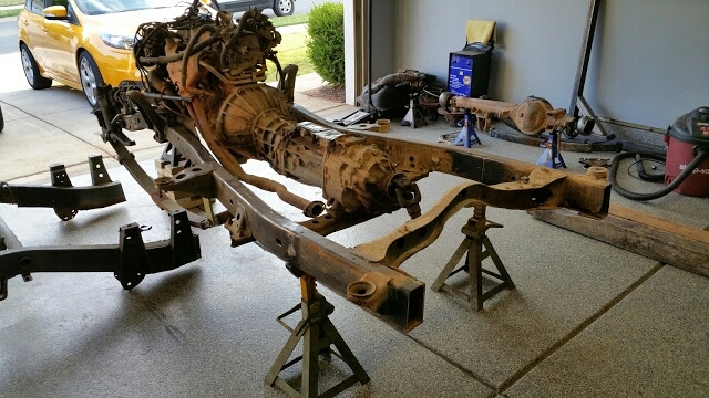

Figured Id start a build thread to keep some pics of the truck together, info that I may forget, and ideas from you guys. Picked up a 1985 pickup roller back in February to get back into wheeling since selling my SAS'd tacoma and Polaris RZR. Got the roller home and sure enough the frame had rot in it, so out comes the sawzall.
Anyway onto pics

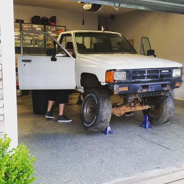

The day I brought it home
ai227.photobucket.com_albums_dd308_86_LX_Mobile_20Uploads_FB_IMG_1446042762498_zpsrt2ppwmz.jpg

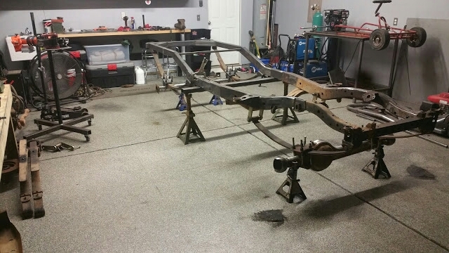

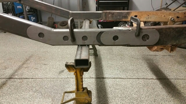

Took the cab off, cut the frame about a foot in front of the rot and started on the new rails.
ai227.photobucket.com_albums_dd308_86_LX_Mobile_20Uploads_6171812923279144898_zpsq6hdxphn.jpg
ai227.photobucket.com_albums_dd308_86_LX_Mobile_20Uploads_6171837231691676674_zps6cqmired.jpg
ai227.photobucket.com_albums_dd308_86_LX_Mobile_20Uploads_6171837131270258834_zps8e6qntbf.jpg
ai227.photobucket.com_albums_dd308_86_LX_Mobile_20Uploads_6171836184568333122_zpsjbrmcroy.jpg

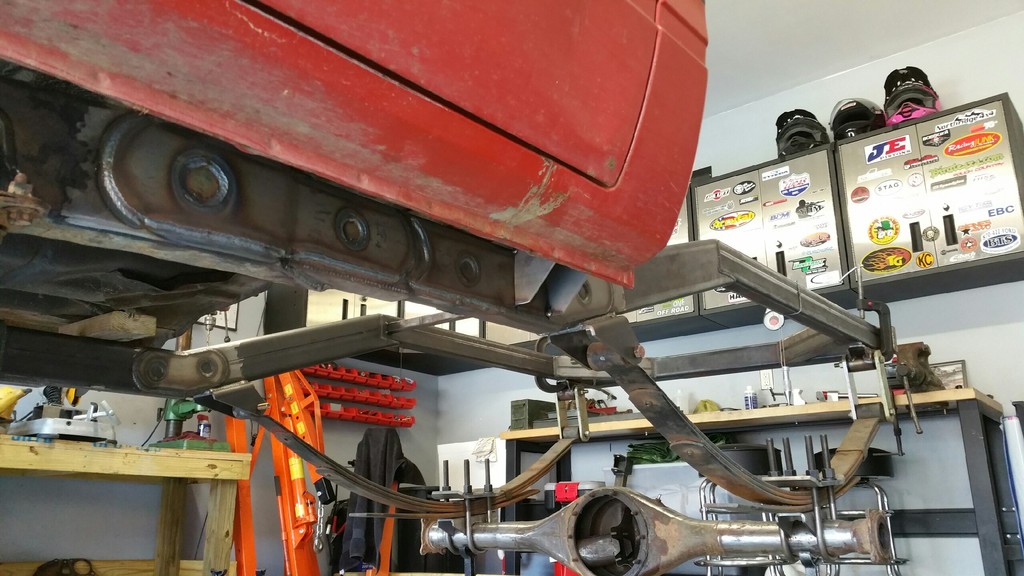

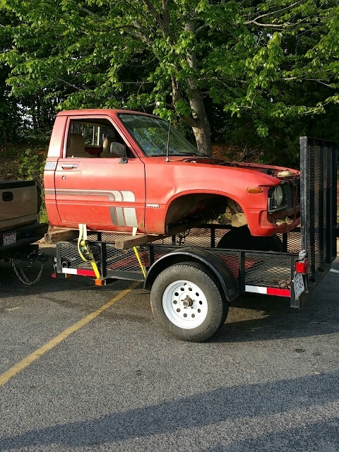

Scraped the white cab since it had a sunroof and had an idea to put a extended cab on the standard cab frame, was told about a local guy that has anything toyota and got in touch with him to go pick up a 89 extended cab. Get to his place and fell in love with the looks of a first gen and picked up a 2wd 1980 rust free cab.
ai227.photobucket.com_albums_dd308_86_LX_Mobile_20Uploads_6171812028661154898_zps4tqxzrrf.jpg
Built some new mounts/body mounts out of poly to incorporate a 1in body lift.

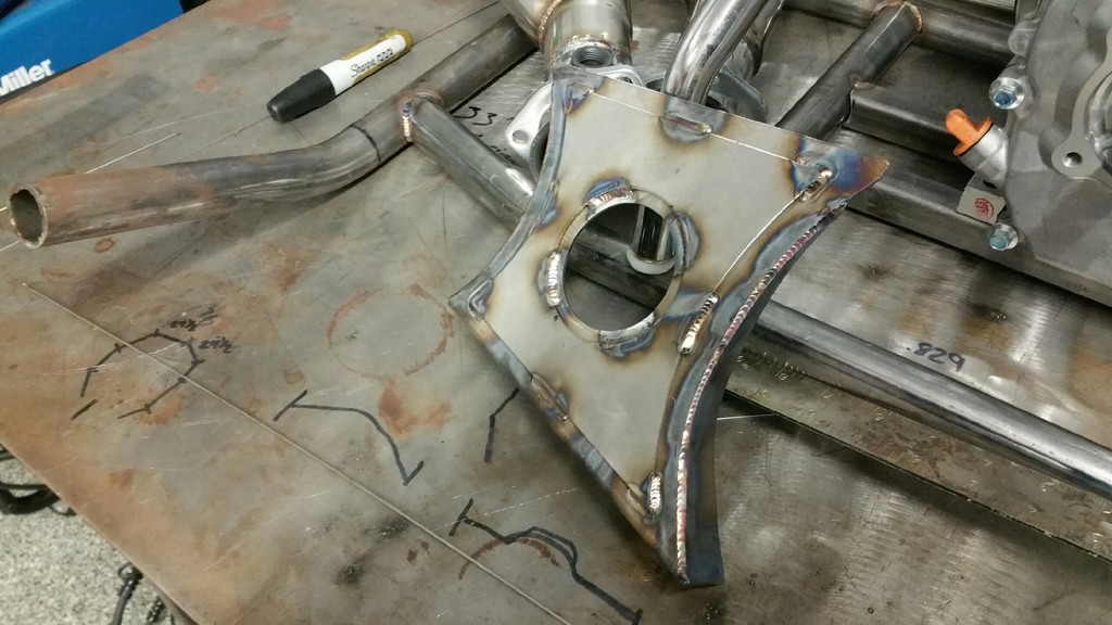

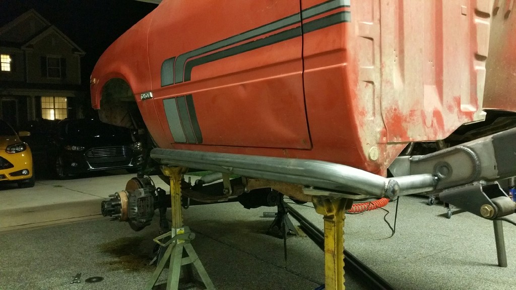

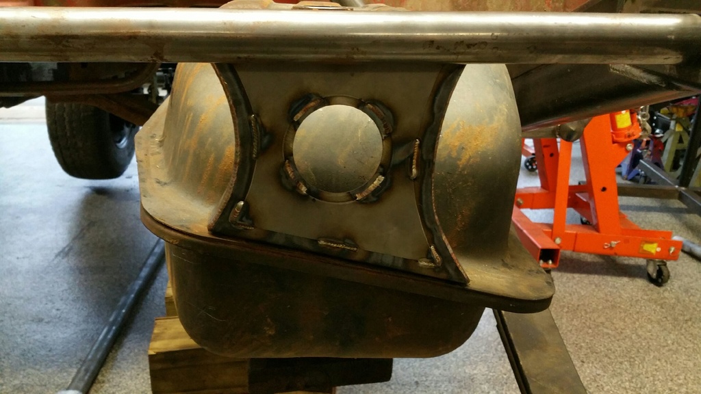

Built a new horse collar, fuel tank mounts, sliders.
ai227.photobucket.com_albums_dd308_86_LX_Mobile_20Uploads_20150808_201926_zpsmvbmujvb.jpeg
ai227.photobucket.com_albums_dd308_86_LX_Mobile_20Uploads_20151002_184823_zpsznpkemyt.jpeg
ai227.photobucket.com_albums_dd308_86_LX_Mobile_20Uploads_20151002_184845_zps6ywrdgix.jpeg
ai227.photobucket.com_albums_dd308_86_LX_Mobile_20Uploads_20150821_215814_zpszmk2bhp4.jpeg

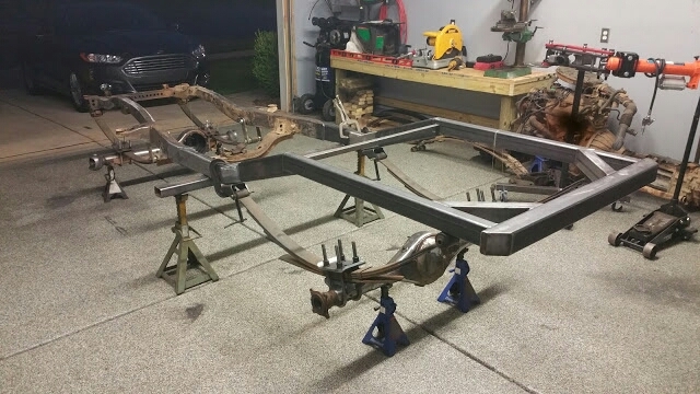

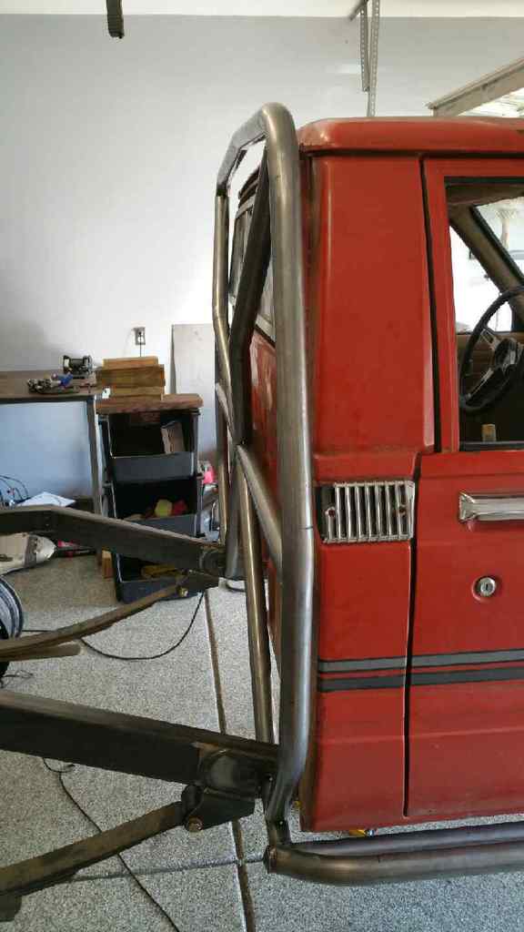

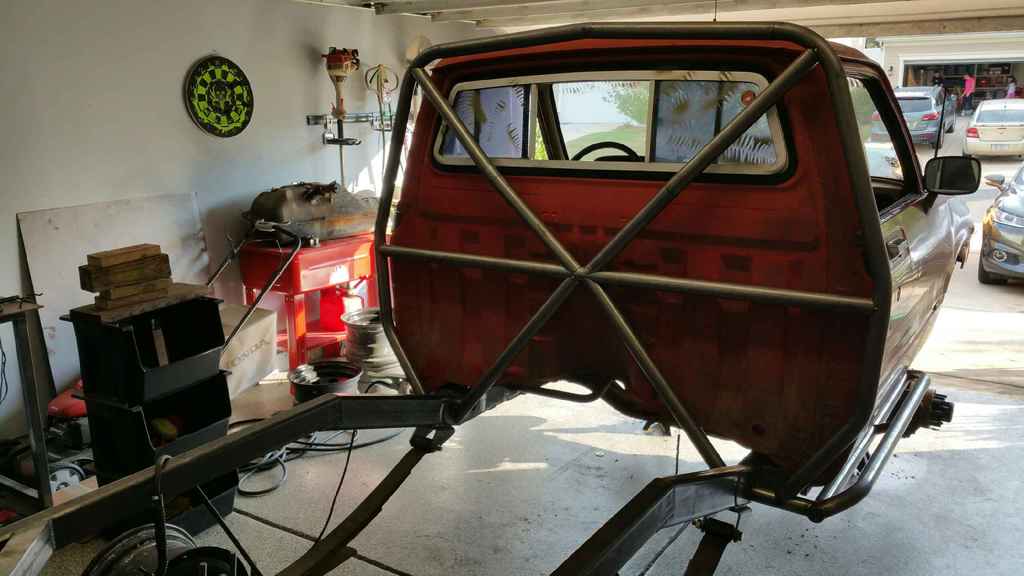

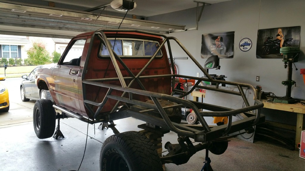

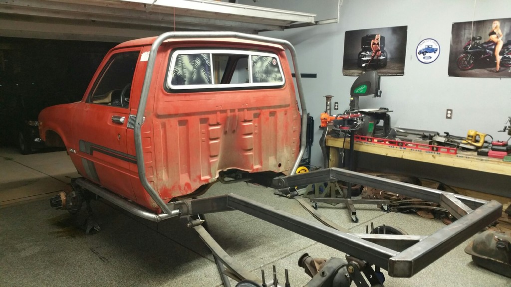

Started on the tube bed building the main hoop.
ai227.photobucket.com_albums_dd308_86_LX_Mobile_20Uploads_20150823_004135_zpsqzzefaze.jpeg
ai227.photobucket.com_albums_dd308_86_LX_Mobile_20Uploads_20150823_181045_zpsukkaoaye.jpeg
ai227.photobucket.com_albums_dd308_86_LX_Mobile_20Uploads_20150823_181106_zpsmlrkt0x4.jpeg
ai227.photobucket.com_albums_dd308_86_LX_Mobile_20Uploads_20151028_134406_zps2hqjyqbc.jpeg

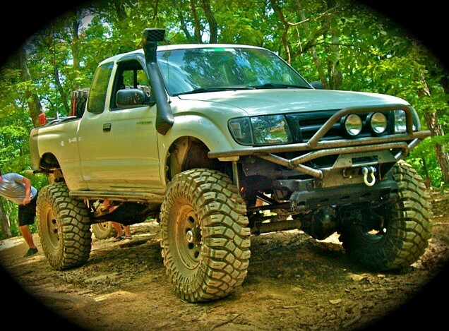

Haha that's funny. Was this what it looked like when it was yours?
awww_tacomaworld_com_media_img_20151029_175058_487679_full_d1995f586d47a3dacdb7dd1782409eec._.jpg

Yup that's my pic at URE

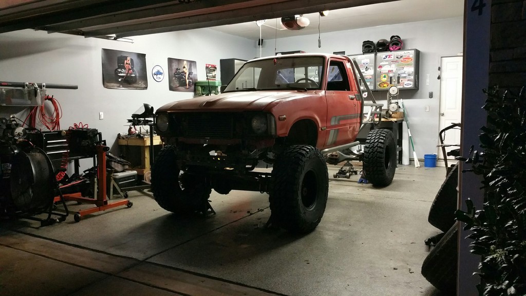

Tires got delivered the other day, still waiting on the rest of my wheels but I had to roll them over and see how they look.
ai227.photobucket.com_albums_dd308_86_LX_Mobile_20Uploads_20151107_174632_zpsepafdmun.jpeg

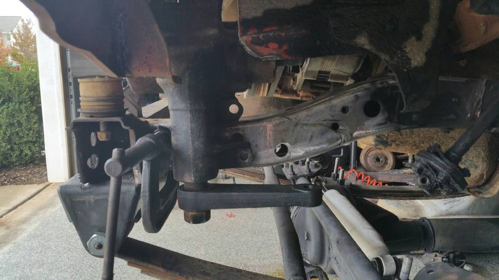

Put the 22r back in and i'm just going to run it for a while, may convert it to EFI if I can find everything. Got the steering box mount made and holes drilled in the frame. Put the front box mounting hole about 1in from the front body mount and stood the box vertical. Will be finishing the plating on the front frame rails this week then it'll be back a roller.

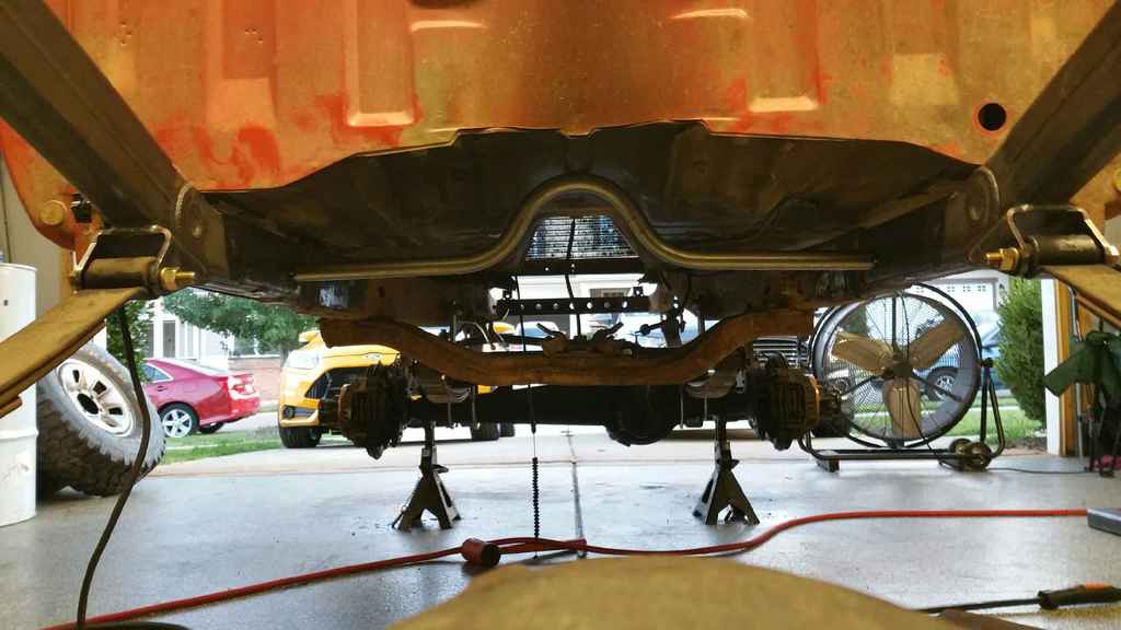

My project kind of stalled out over the holidays other things on my mind and the wifes car got hit while she was pulling into our driveway. Worked a bit on it over the weekend then messed up the strap on my bending die so I need to get a new one. Got some of my transmission crossmember bent up and tacked together, also got my wheels need to get everything mounted up and flex the suspension.
