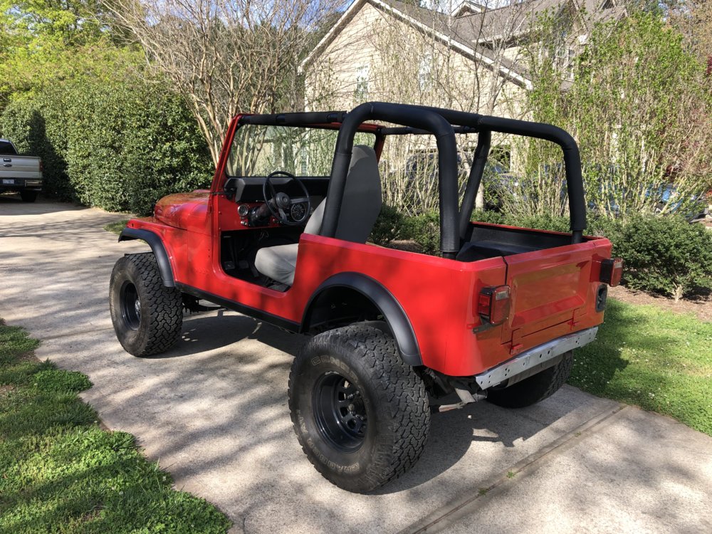

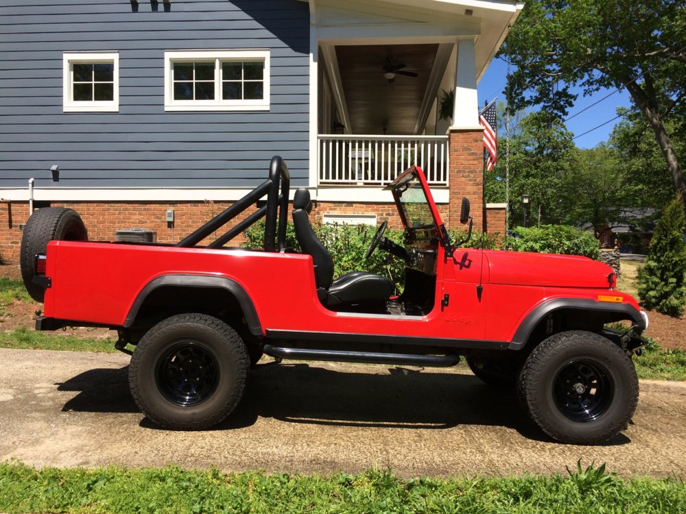

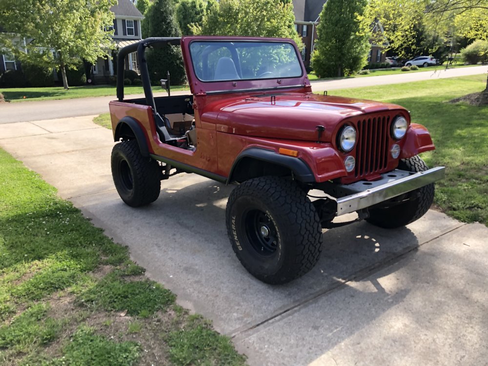

Starting to put it back together...still a few items to install, but made great progress today!
Punch list includes:
Headlight trim rings
Heater box
Replace rear axles
Brake job at all 4 corners
Install seats
Build front bumper
Build rear bumper and tire carrier
Drive it around

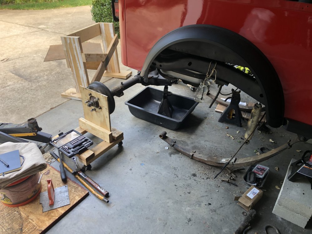

Rear axle housing is out... Normally a 2 man job...but I didn’t have that option so I found a solution (homemade dollies that mount onto the lug nuts and clearances for the front 4x4 hubs). New housing should be here next weekend... reverse of the removal process except I have to burn in new spring perches.
Once the rear is in, I’ll move to the front. I’ll have to also add spring perches and shock mounts.
