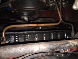

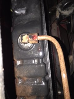

I found the leaking line, took a couple of pics the other night, looks like it's leaking at the coupling, but I wasn't sure if they sold just that elbow piece or if I needed to replace the whole line, and if I did replace the whole line could I used something other than the existing bendy metal lines on there today, it's been tough to find when I'm not sure if the trans is stock or the one that came with the 360 that was dropped in there

Stick with the hard metal lines, they help dissipate heat from the tranny fluid. That looks like a compression fitting on the line, you should be able to tighten it a little. The elbow coming out of the radiator may need replacement or just resealing.
The tranny should either be a torqueflite 727, if it's the one that came with the 360, or a 999 if it's the original from the 258. (if memory serves correctly) I would presume whoever did the swap left the waggy drivetrain together for simplicity.
Thanks for the reply, would I tighten the fitting going into the radiator, tight the fitting with the drop of oil on it, or take them both out, go to my local auto parts store, and see what they sell to put on the threads to repack it?
The fitting on the hard line will not use any sealing compound on the threads. The fitting into the cooler would use sealing compound.

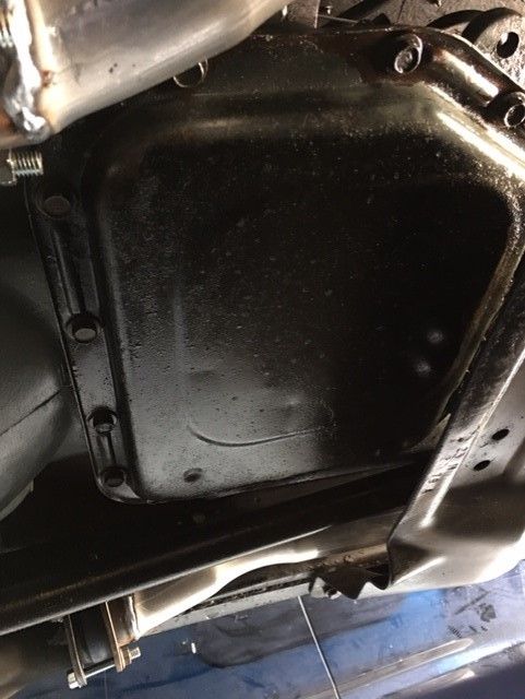

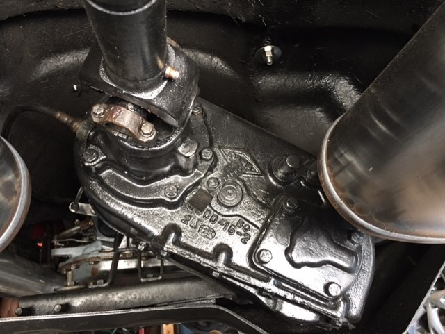

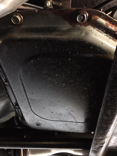

Morning all, here are the pics I took, I really appreciate the help! It's frustrating, you focus on one thing and another pop's up. Took my jeep to Henrys Muffler here locally a few weeks ago....they did great work on the exhaust, the tech mentioned having to 'tweak' the trans linkage to make it all work and now when I put it in Park it still rolls backwards. Part of me is saying take the damn thing to a trans shop and tell them to just take care of all of it. Have left 2 messages for the tech to discuss it and nothing...not sure I would even want to take it back to them but it worked before they got it....ugh. Anyway, here are the pics....thanks again. Transmission 1.png Transmission 2.png Transmission 3.png Dana Transfer Case 2.png
That looks like the 999 transmission with the d300. I do not believe it was used it the grand wagoners with the 360 sonit is likely the stock transmission from your CJ.
