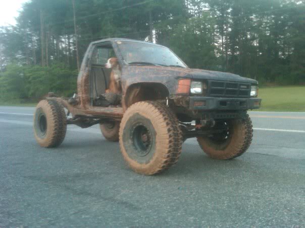

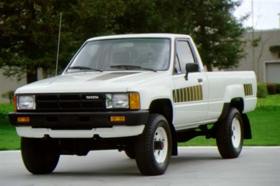

This truck started it's life as a Beige 84 22r powered SR5 longbed, (just like this truck but beige and no wing windows)
ai96.photobucket.com_albums_l194_volvhoe_1984_20Toyota_20littl2fe3723bffabde5a0f15a6fd2ca3eaed.jpg

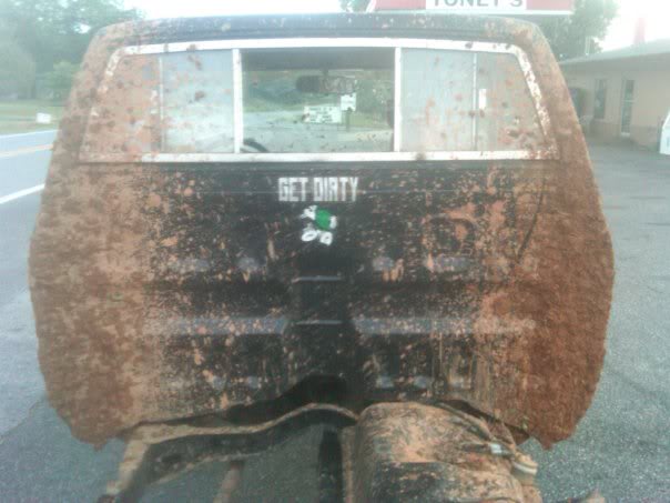

it is still alive after 240k miles
single chain 22R with 38/38 syncro weber
head has been redone
timing chain and new cover
37/12.50/15 early Goodyear MT/R's
14in travel Bilstein Shocks in rear
Marlin Crawler dual transfercase adapter
schedule 40 DOM rear driveshaft
Long Wheelbase no bed, frame has been replaced from the cab back

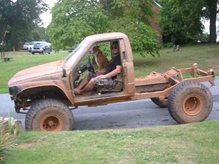

thats a badass runner!!! what kinda pooch is that? APBT?

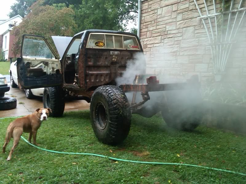

last pic's of the truck when it was on the road, i took it apart because it broke, and because i needed the parts to fuel another project. It will be running again one of these days.
ai96.photobucket.com_albums_l194_volvhoe_1984_20Toyota_20littl75df7c7970355c22a59c3061ecaaf04f.jpg
the head was rebuilt, but the water jackets were corroding away and getting past the cylinder seal ring on the head gasket.
