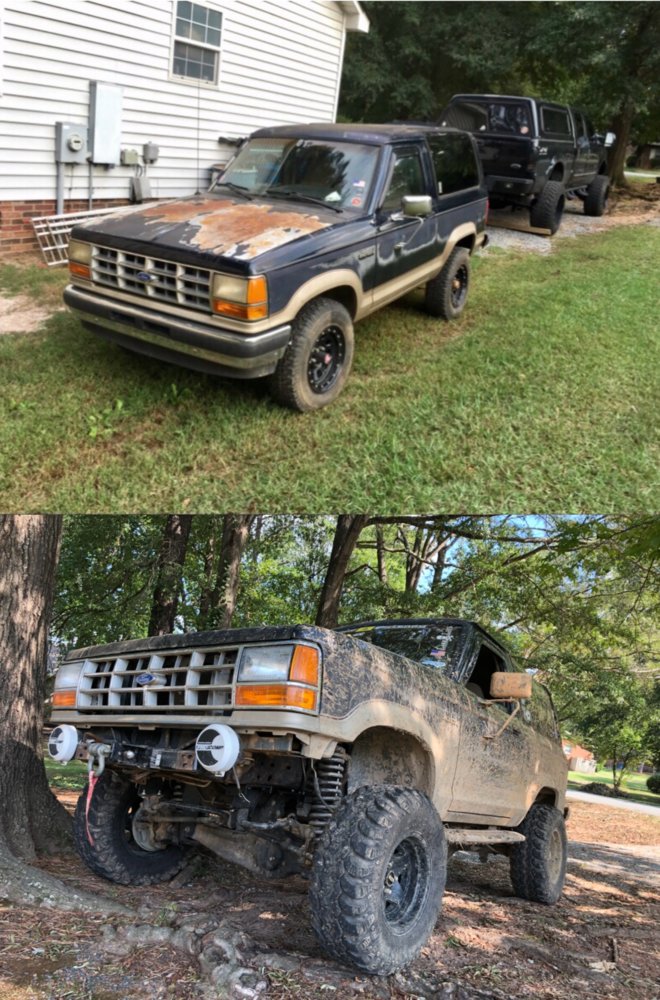

sorry for the no pictures lol forgot about that. top image is the first picture i have of it, august of 2016. bottom is the most recent, september 20, 2018

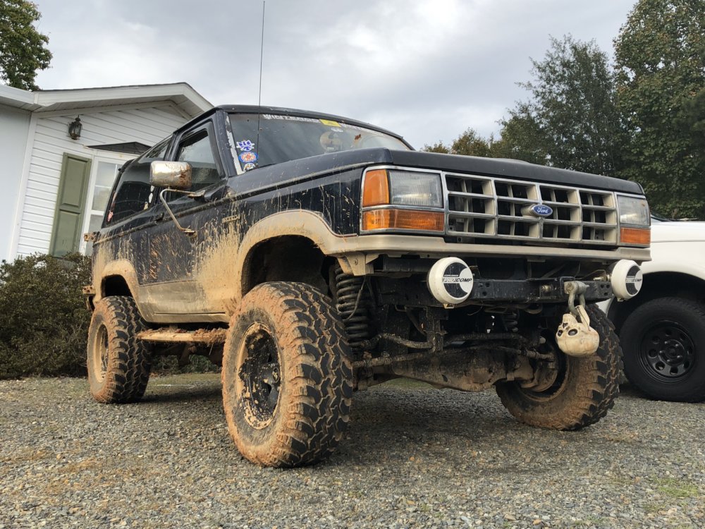

soooo it did great at URE. the trails were more than i thought they’d be, a modified XJ got stuck twice in some ruts, he high centered both times on both axles. an JK got stuck too, but looked to be pretty stock. i almost got stuck once but i got out of it. here’s some pictures, no videos unfortunately.
