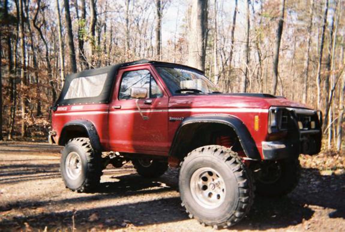

Hey guys I recently traded my old half dead chevy Silverado 2wd 1500 for a 1990 bronco 2 4x4 5spd 2.9L I already love this bronco 2 , im wondering what all years of rangers/F150/explorer parts work with the 90 bronco 2s I basically just wanna give it a lift some larger tires fab front n rear bumpers and definitely change out the front axles. so I was curious if anyone could help me with some of the best junk yard cars to go pull most of this out of to put on mine. thanks! Joey

www.therangerstation.com should take care of all of your questions. Ive had several of the little trucks and loved them all. look at james duff for lifts kits. also, if you can fab, find an early bronco 66-77 (73-76 is better, dana 44) for the axles. its a near bolt in swap, you'll just have to fab a track bar mount in the front and relocate spring perches in the rear.
having the 5 speed is gonna save you a lot of headache as the a4lds that came in them were a bit weak.
all the 4.0 ranger/explorer motors will swap over. 8.8 rear axles are bolt in.
perry fab n fiber make some cool body kits if you are into the pre runner look.
