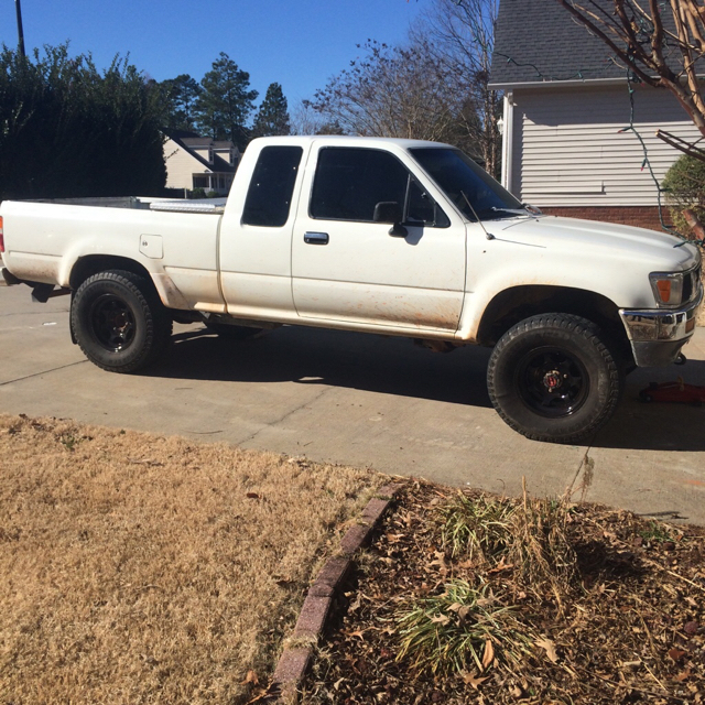

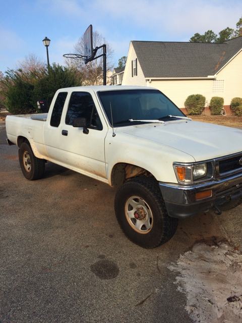

So here's my 1992 Toyota pickup, I bought the truck to be my DD and second build. The second I turned 15 I've been learning about fabrication, taught myself how to weld, and have been building and breaking my trucks. My last build was a 2wd prerunner but moving to the south I quickly realized the need for 4x4 and picked this guy up
quickly got rid of the heavy stock rims and put on some enkies I painted

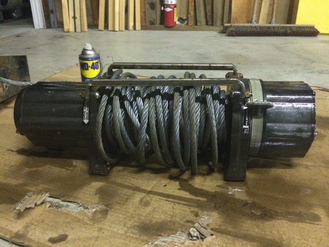

while I was in California over Christmas break I stumbled upon a fully caged Mitsubishi in a pik-a-part, and after further exploration I discovered this gem
found the 8,000 pound winch, the fair lead, wiring, and bracket tray for $28.99. Used my grandpas sandblasting cabinet, checked the 100+ pounds of winch onto the plane and shipped it back here to the south. Had to cut and fabricate a little to make the mount work but the winch works good and was a steal!

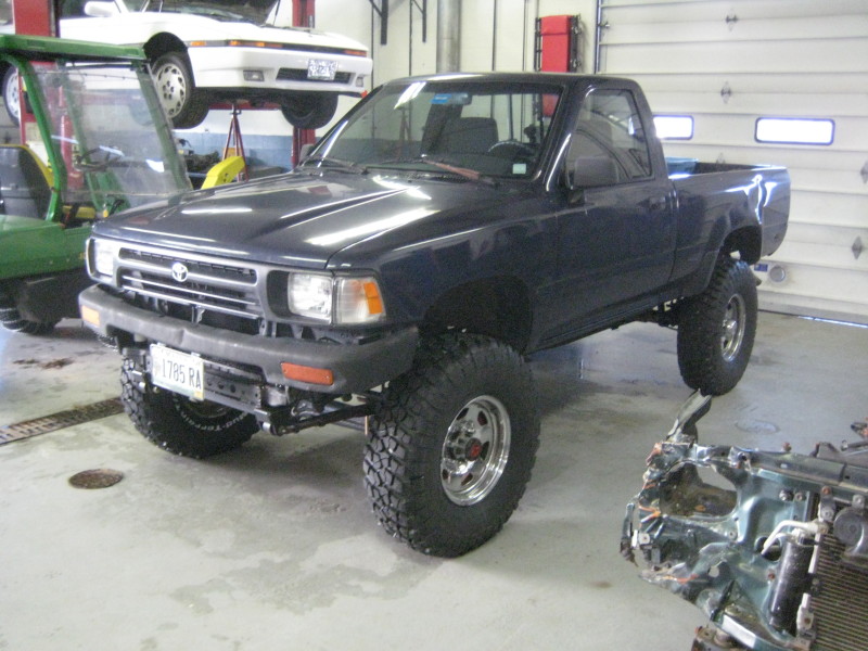

also this was my last truck
full uniball front end with 14 inches of travel, had a ranger f31 dreaver pack with 17 inches of travel in the rear. I built everything but the shock hoops. The truck was supper fun and felt like a part of my family hah but after I started college, bent something in the tranny, and realized I need something more reliable that wasn't built by a learning 16 year old I sold it and bought my pickup. Miss it everyday but the pickup will be more reliable in the dirt and on the road and be a lot more versatile

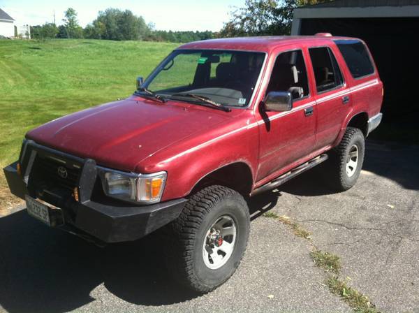

I had an old 4Runner I built. Did a 3.4 swap, frame off build, etc.
http://www.pirate4x4.com/forum/toyota-truck-4runner/984573-95-4runner-5vz-ifs-build.html
I was building a 2wd truck and doing a straight axle up front when I decided to do the 4Runner thing instead. Girlfriends and dogs needed more room. Biggest thing when she left was that I really missed the old 2wd truck. That thing was awesome, should of kept and it and told her to buy something :)
http://www.pirate4x4.com/forum/toyota-truck-4runner/915054-project-ol-blue-2wd-sas.html
Nice man! I'm actually in South Carolina around Columbia but I go to NC a lot. And I got the wheel out of a RAV4 but the supra celiac and dac wheels are all the same, made a huge difference in cockpit feel.
How was the 3.4 swap? That's something I wanna do really bad
The 3.4 swap for sent too bad because it all has been done before and well documented. Plus pretty much everything you need can be bought. I machined and tabbed my own crossover which took countless hours. I also chose an 01' Cali emissions automatic trans donor which had electronic throttle control. If you read my thread, the harness was gigantic even after waddling most of the junk out of it. I welded the 01' fuel tank fittings onto the 94' tank which was not fun. It would is a super sleeper swap that looks factory retaining all the factory gauges. Would I do it again? Nope...power and fuel economy was just not enough for the pain. I would probably either go 2UZ Supra if I had to stay Toyota or make an LS fit in there. Don't get me wrong, the 3.4 is an awesome powerplant. Since that rig was open/open with 31's, I spent most my time on the rev limiter. It actually wheeled awesome if you just convince yourself it can't throw a rod at 6 grand :)

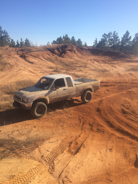

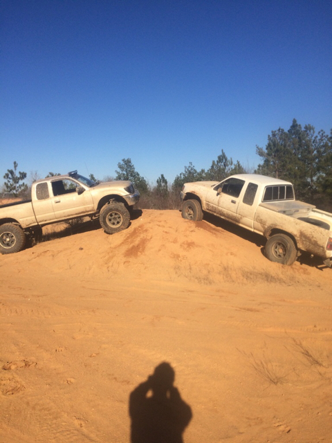

put in about 8 hours today on dirt and really got to feel how the truck handles and what it needs. These yotas do amazing for stock height on 31s. I figured out I have 4:30 gears so I'm going to be going to a 32x11.50 soon. My tires are almost bald so I'll be buying kenda klevers off eBay for my next set. Also gonna be throwing in a locright, I'm not having that many traction issues but the damn open diff won't let me slide around when hauling butt. I'm more into "prerunning" then crawling so sliding is a must! Overall the truck did really well today and I used the winch a few time. My fabbed mounts and solenoid wiring held up good. Super happy with the truck even stock.
