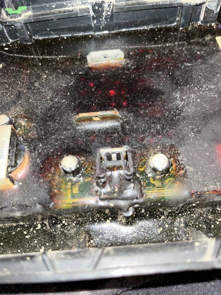

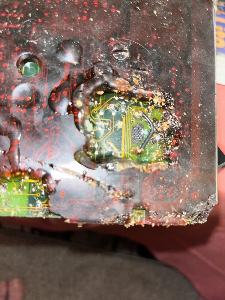

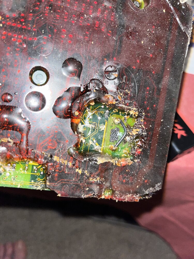

You think after I reversed polarity the jumper cables it could affect the ground straps ? It started up perfectly fine very strong before I fuckedd it up lol I’m thinking it’s ecu related or wiring burnt some where
On a recent episode of Bleepinjeep, Colt had good success with Wrangler Fix, His was a new model Jeep, but from what he said, they can fix all Jeeps, and others as well.
The link on his Video was Wranglerfix.com for your ECU needs and don't forget the discount code "BR549" His Contact was "Mark"
Hope this helps as it does appear you fried your ECU for sure. Not sure if other things could have been damaged too, I'd check all grounds, and the smaller grounds too. In my experience the grounds are the ones to melt down, not the positives,but the do get hot, which appears to be what happened to yours. It doesn't take my heat to melt solder.
