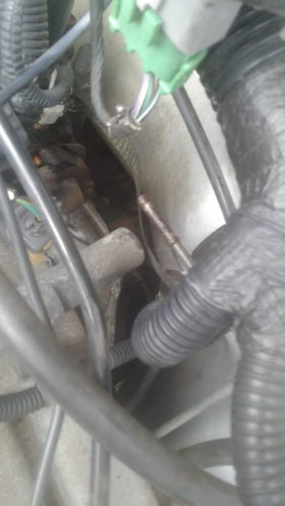

found this other morning goes to fuel tank , where is other end go to ?
You can also scan it with a good scanner and the ChryCo adapter. Way more info than cell method. Almost obd2 amount & live data, though limited by the lower sensor count. Nevertheless, indispensable. My money's on the pump. And the return systems will get hot enough to vaporize fuel if the check valve is bleeding in the pump.. (lowers fuel boiling point, same principal as pressurized cooling systems)
HUH?
You can also scan it with a good scanner and the ChryCo adapter. Way more info than using the engine light to read the codes. My money's on the fuel pump. Check fuel pressure hot and under load.
And the return systems will get hot enough to vaporize fuel if the check valve is bleeding in the pump.. (lower pressure lowers fuel boiling point - higher pressure raises the boiling point)
@Papa_Jon that make more sense?
