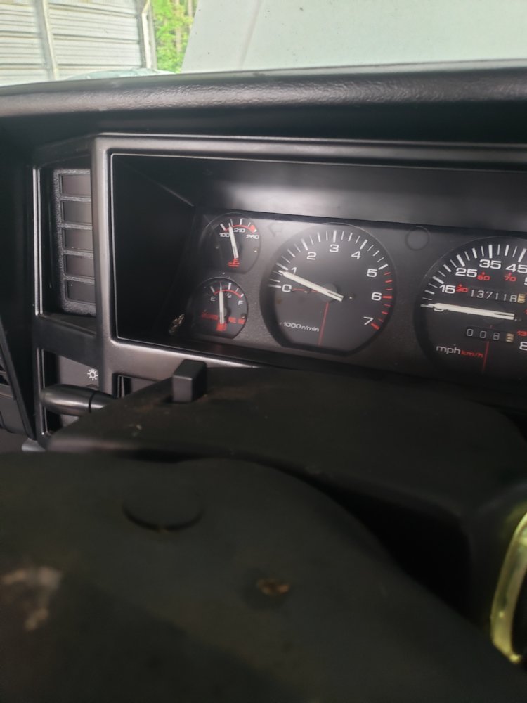

Lowest i can get it. New IAC. How do i comand lower and higher. Don't think my soluis will do a 95
750-800 is normal.
If it's a 95 I can reflash it if you want a lower idle, but that's where it should be..
Commanding it with the scan tool will only result in temporary changes.
