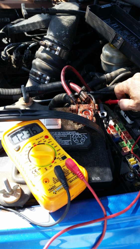

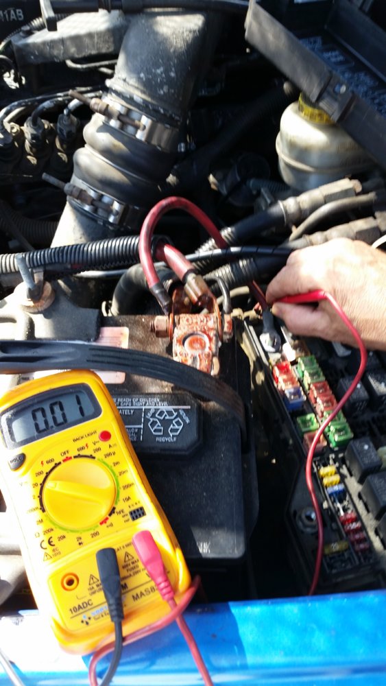

Wow, it's been over 3 months, and I haven't done much. Right now, I'm poking around with the meter, and this doesn't make sense to me.
I have one lead on the negative terminal of the primary battery, then the other end on the ring terminal to the underhood PDC. when I disconnect the terminal and probe the bare wire, I get 12.35 volts...makes sense. When in touch the terminal to the stud where it was bolted too, voltage drops to 0.01. FWIW, ignition key is set to RUN.
I don't understand why it drops almost to zero, and I certainly don't know where to go from here.
I have one leaf on the negative terminal of the primary battery, then the other end on the ring terminal to the underhood PDC. when I disconnect the terminal and probe the bare wire, I get 12.35 volts...makes sense. When in touch the terminal to the stud where it was bolted too, voltage drops to 0.01. FWIW, ignition key is set to RUN.
View attachment 223051 View attachment 223050
That's because the cable isn't capable of carrying current. It's called a voltage drop caused by excessive resistance (corrosion in the end, a broken wire, blown fuse link etc) in the wire. I'd make a new cable and test again!

Underhood, I guess I need to start looking at all my big cables and measure resistance. With such a big voltage drop, I would've expected the wire to get hot and maybe burn up...maybe a fusible link did somewhere else. Man this sucks.
I do have the FSM on CD somewhere, better dig that up too.
Resistance test won't tell you diddly on a big cable, you could have one strand of copper in good shape and show 0 - ohms. No reason to check bigger cables, just verify that the voltage at the battery remains the same when it's connected (make sure the battery isn't dead) and verify the drop isn't in the terminal itself.
I see two or three of those a month with a similar drop across that wire or a battery terminal without evidence of excessive heat.
