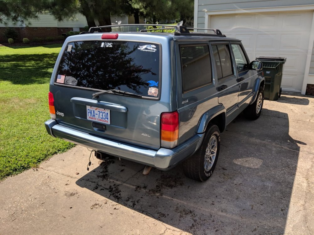

I bought this beaut from a guy in Greensboro 2 years ago. His son drove it until the engine blew, he had the engine rebuilt in Greensboro (can't remember the shop name), but when I bought it the body had 220K, but the engine had a fresh 35K on it.
It's a 1999 XJ Limited, fully loaded (for it's time): 4.0L, AW4, NP242, HP D30, 29 Spline 8.25.
This is probably my fave color for the XJ outside of a clean white and built XJ.

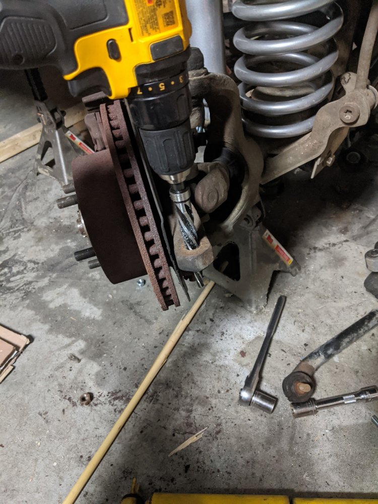

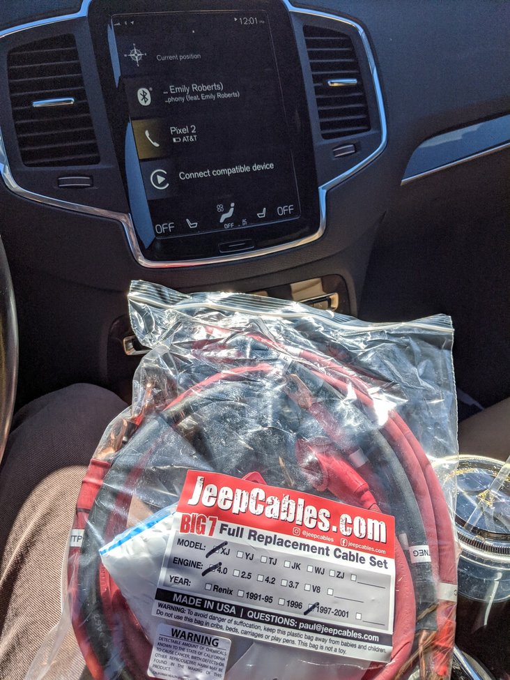

Anyway, first mod was the Big 7 cable upgrade to handle the bigger alternator and winch:

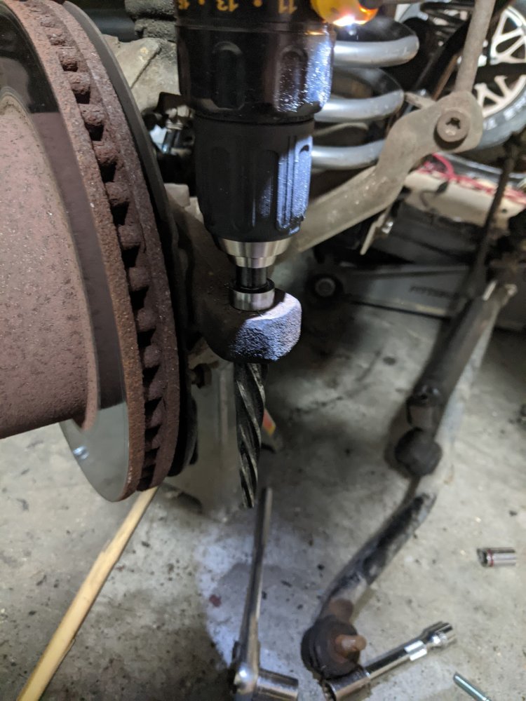

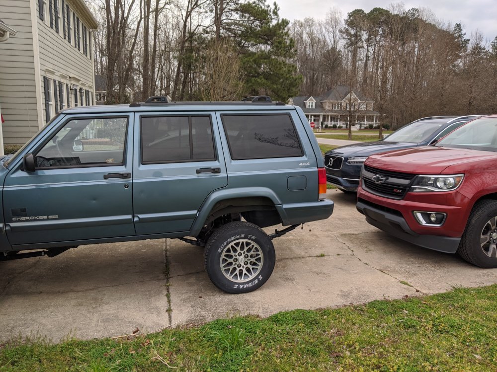

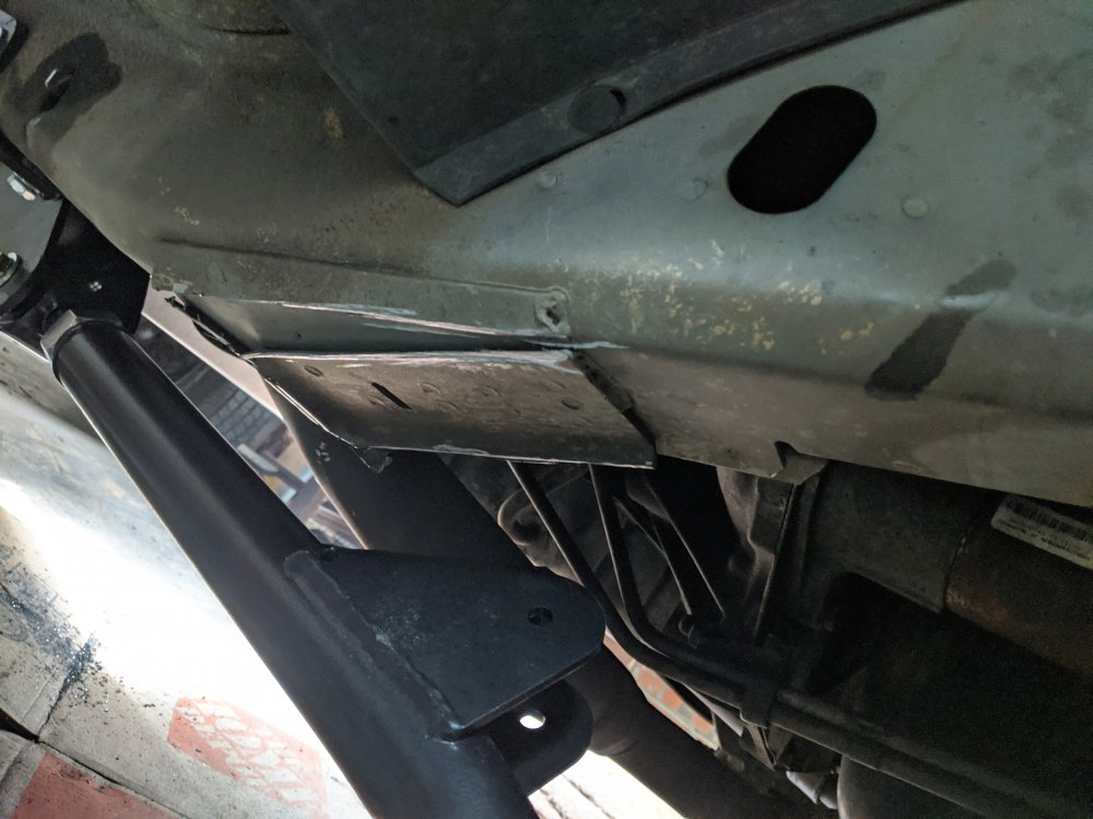

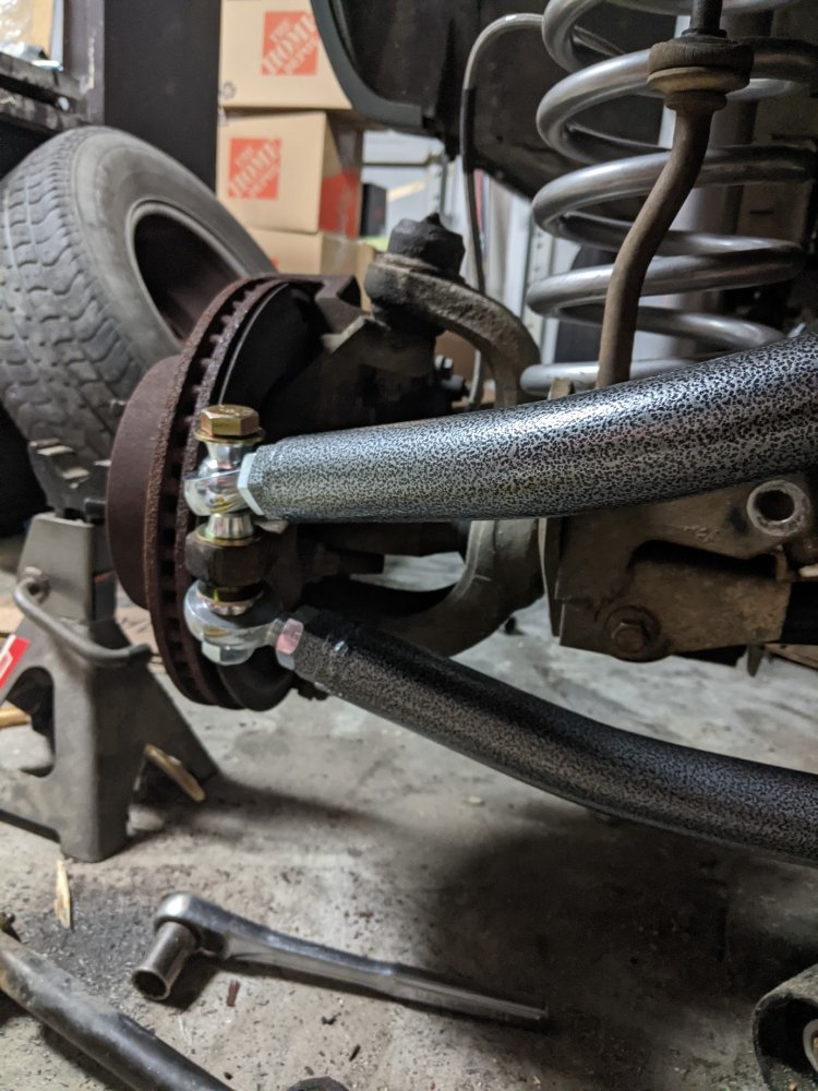

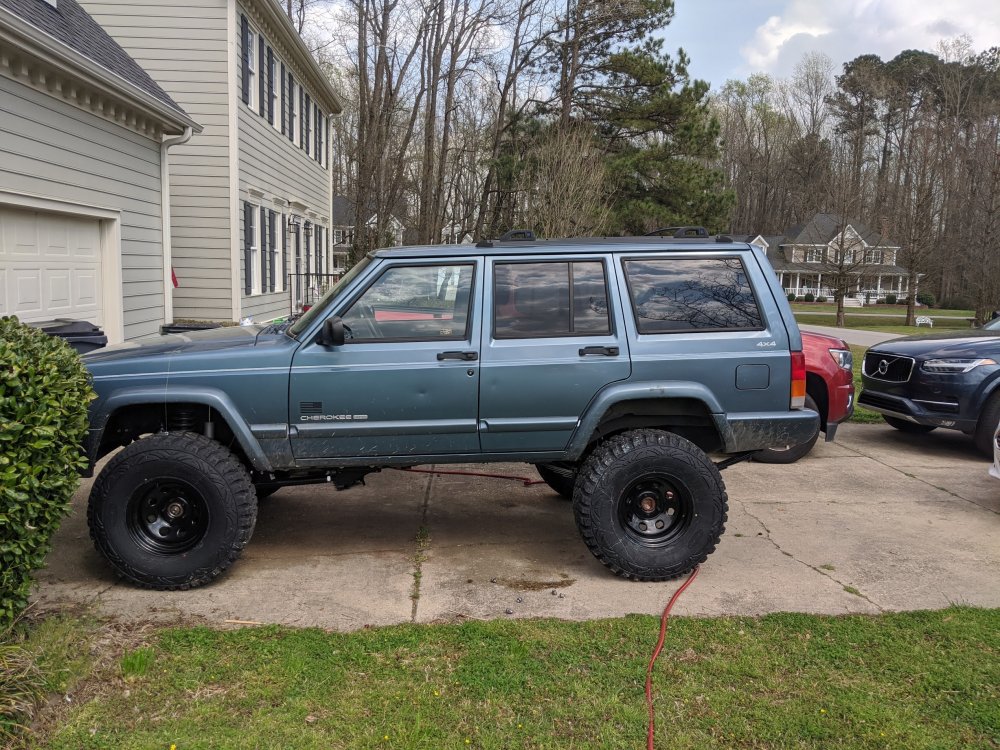

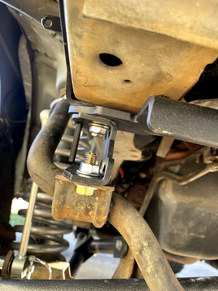

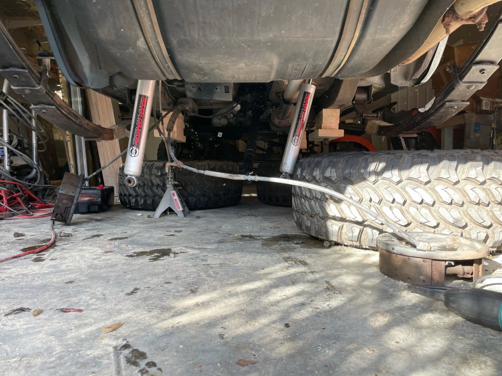

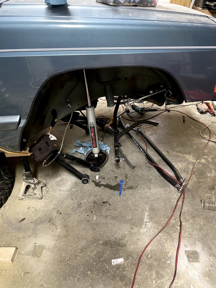

I know...I know people hate on Rough Country all the time but I went with their 4.5" Long Arm Kit. After venturing to the point of no return I chopped off the front control arm brackets and started to install everything. I didn't run into any issues and everything lined up like it should, my only critique of the entire kit are the super crappy design of the sway war disconnects.
Also, I will say living in NC has it's positives with no rust and only one rear lower shock mount bolt breaking. Pleasant surprise to say the least. Once the lift was on she needed some shoes!

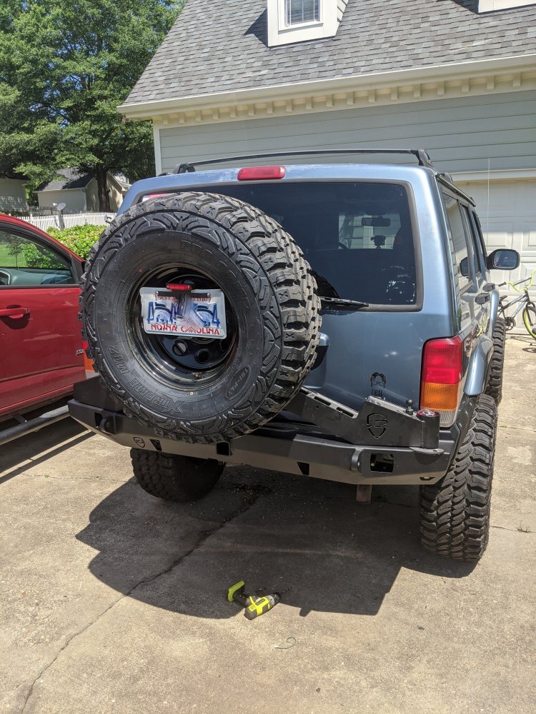

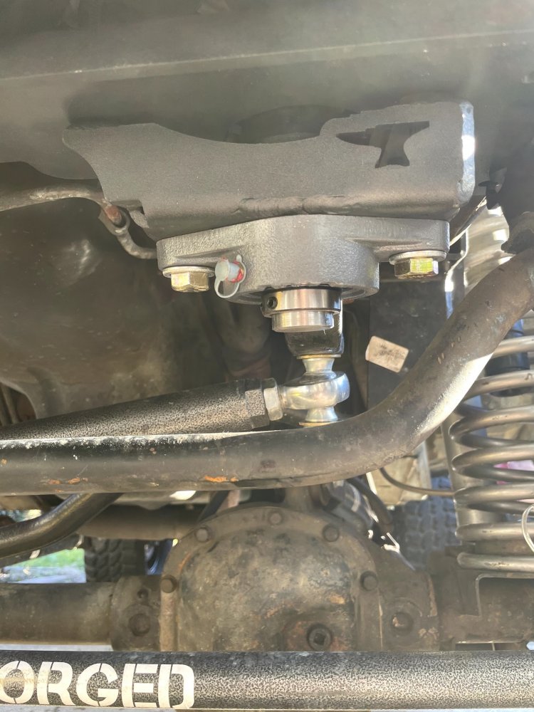

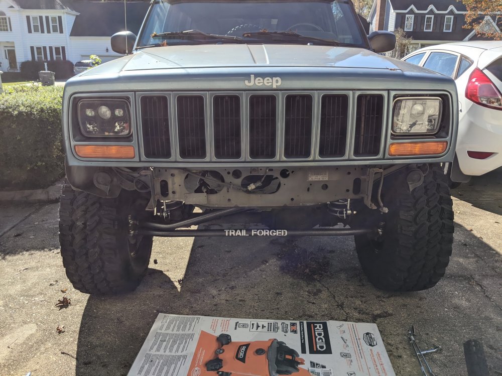

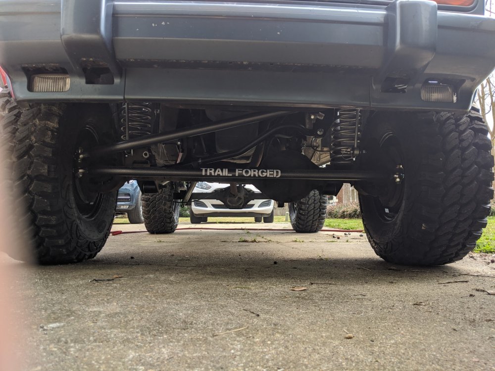

I decided to install some 1-ton crossover steering from Trail Forged. Easy install...the only complaint I should have known was from the heim joints. She seems to wander a bit and my assumption is that is from the minimal play in the heims on the road. I could be 100% wrong, but no matter how tight I put the jam nuts, there's still a little slop in the steering.

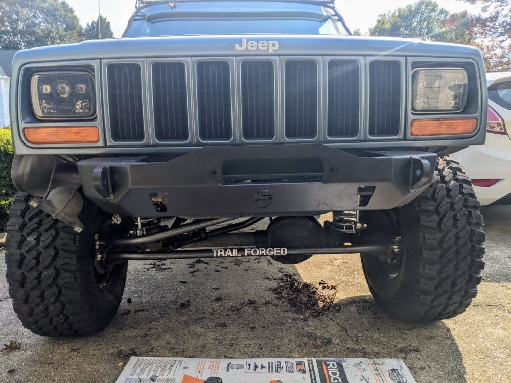

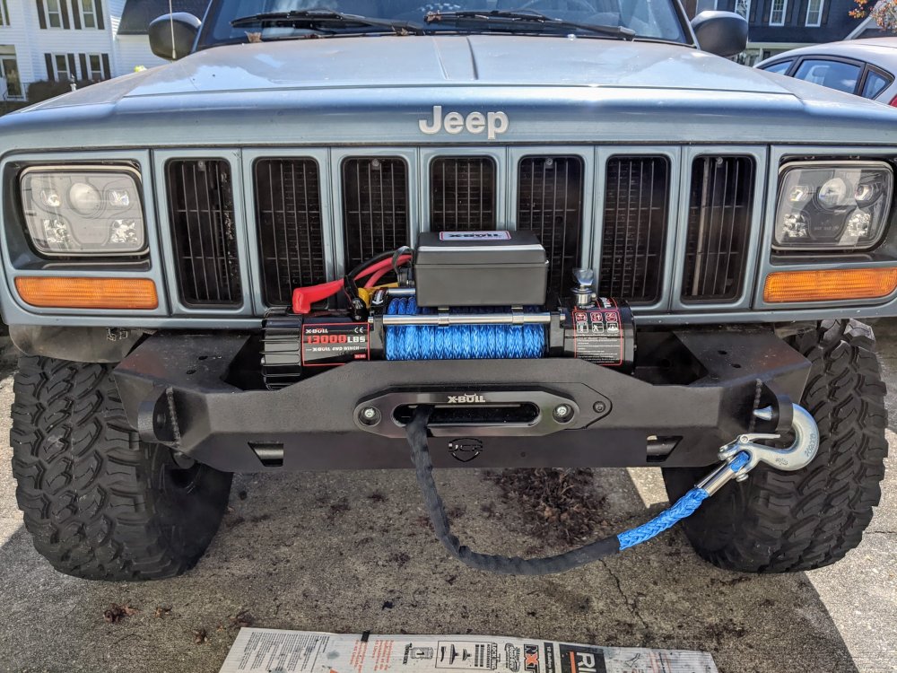

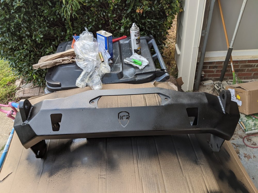

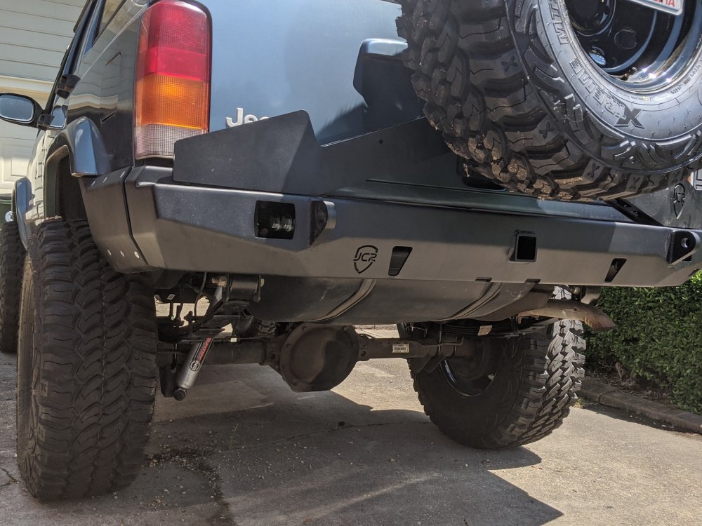

After all was said and done I ordered the front and rear bumpers from JCR. Everything fit like a glove!

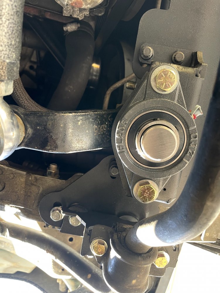

I didn't get any pictures of it, but I also added the Durango 160 amp alternator, I ran out the winch in order to do the initial spooling and going up a slight incline my battery gauge was dropping like crazy.

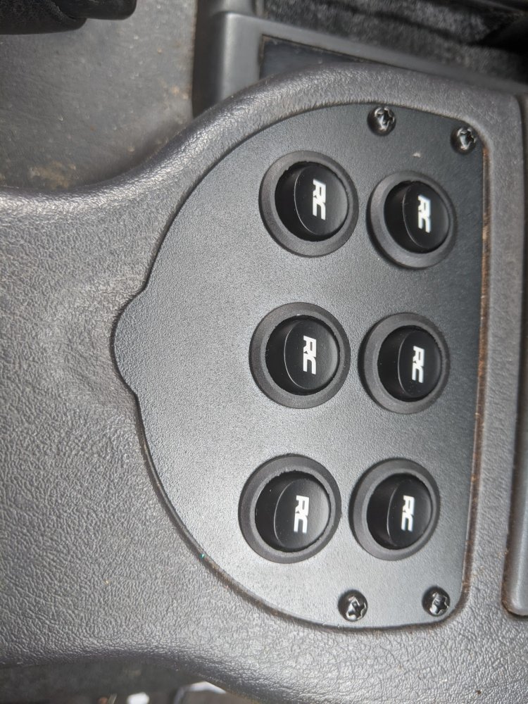

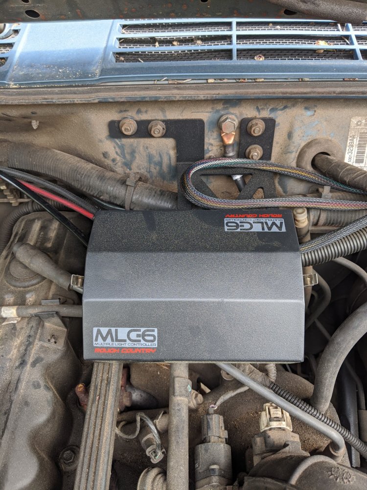

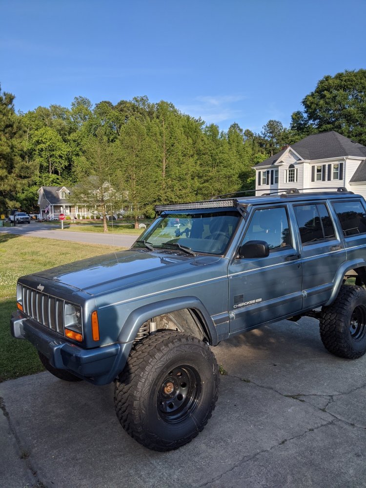

I added some obligatory lights and a controller switch from rough country.

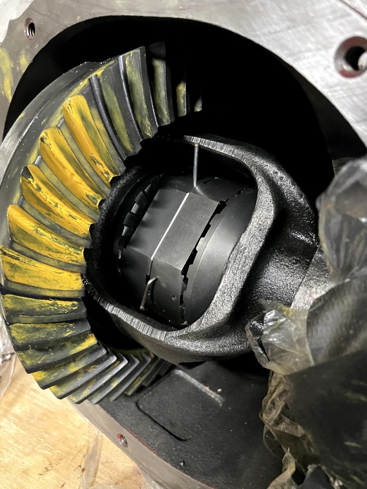

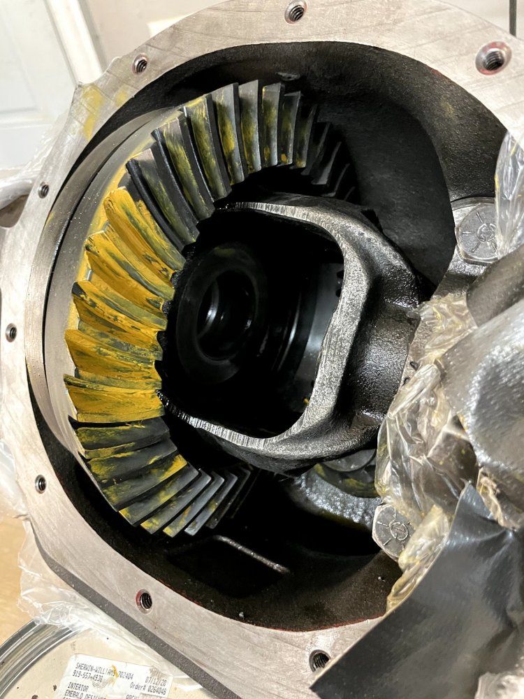

And to bring things to where I am now. I pulled the D30/8.25 and took them to get re-geared. I ordered 4.56s front and rear, new carrier for the D30, spartan lockers for both. If anyone lives in Harnett county, Angier has a great place, Maxed Out Garage, turned around my gear install in 1 day! Guys were awesome and super curious as to what I was installing these in. The owner even said to come back if anything ever feels as it shouldn't and they'll take care of it.

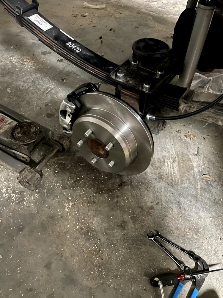

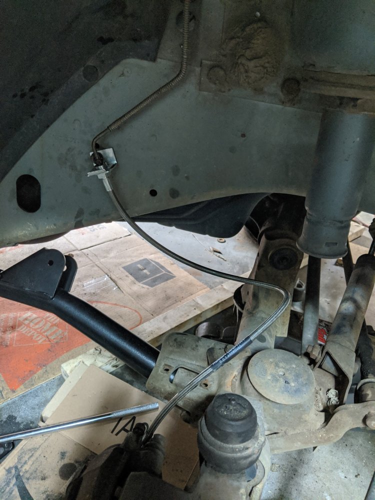

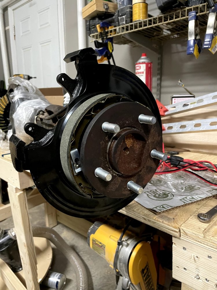

I didn't have them install the 8.25 spartan since c-clips and I am converting the rear to discs. So I knocked that out last night as the kids were crashing from their Christmas high.

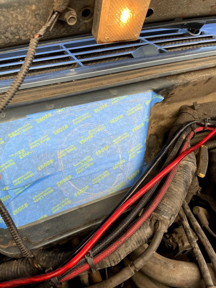

Added the THOR intake tube and filter. Super easy install and frees up so much damn space under the hood! I haven't driven much with it yet, but it's pretty loud on startup but calms down after it gets warm. When I make the Jeeps weekly drive down to Bragg I will see how the noise is.

Nice build! I'm doing similar mods to my 99 XJ, albeit at a slower pace. I'm curious about your disc brake swap on the 8.25 - did you buy a kit from somewhere, components, or grab used stuff from a junkyard? I definitely want to upgrade my 8.25 to discs also.
I had a 96 XJ years ago before I had a good job. I did the liberty swap and it was just as good, just took time to piece it all together. This kit was the crown conversion from Quadratec...in all honesty I did it out of convenience. I still need to adjust the e-brake, it doesn't grab at all.

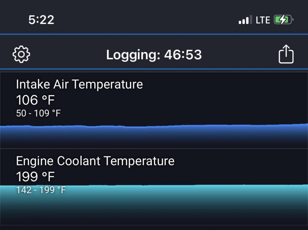

It's awesome, I have the BlueDriver USB OBDII scanner and temps are at least 25 degrees lower pulling from the cowl. Initial startup it's pretty damn loud, but once you get to temp it's audible but 100% bearable.

It's a lot better. I did 4.56s since that's as low as the 8.25 can go, and I do have 33s, I also have spartans front and rear. Overall it keeps me in in the powerband better and my RPM range is much better. I live basically in Fuquay and commute to Bragg (not in the Jeep), but there were spots on HWY210 where it would be a dog and then drop down a gear or two up to 3500-4000 rpms...only going 55-60mph. Now it shifts more predictably, etc.
Its purely from the lockers, but I do hear a slight axle hum when coasting down the road. Once I am back on the gas it goes away. I think once these tires are in need of replacing (a LONG time from now) I will go to 35s..

I have a BlueDriver OBD2 reader and on the road:
While going 55-60mph Intake temp was 75F-80F, sitting in a parking lot at idle for 20 mins it peaked at 109F. I am probably going to wrap the tube to see if it drops it even lower.
