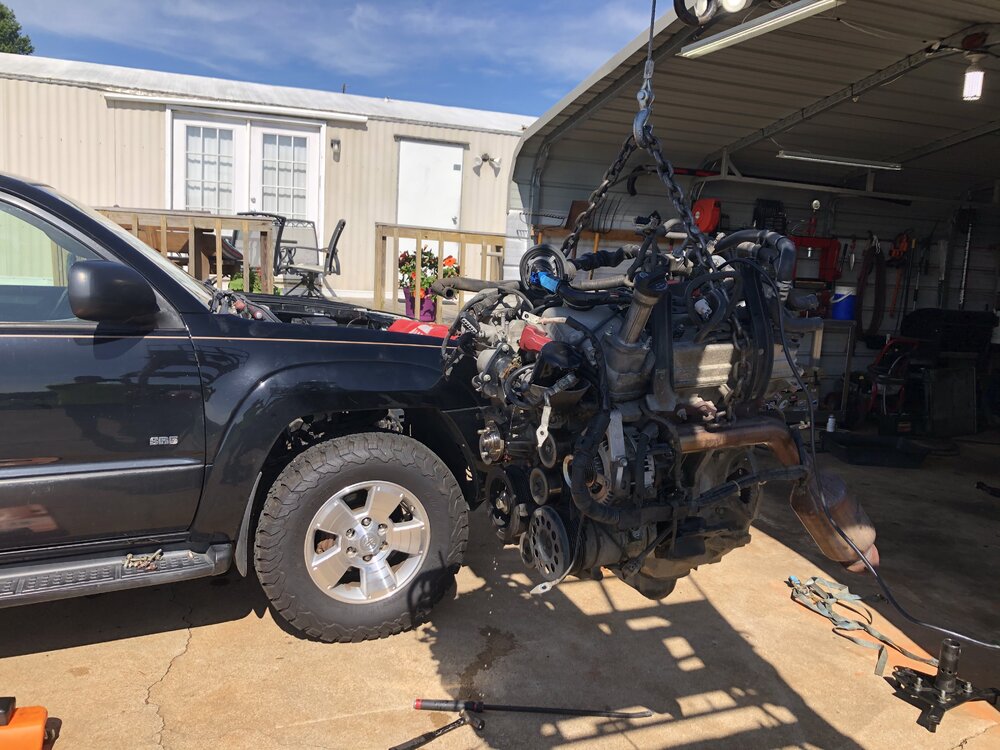

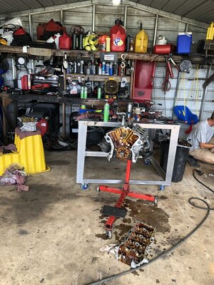

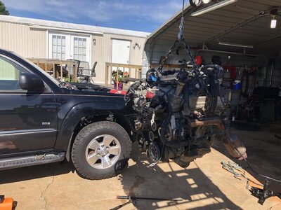

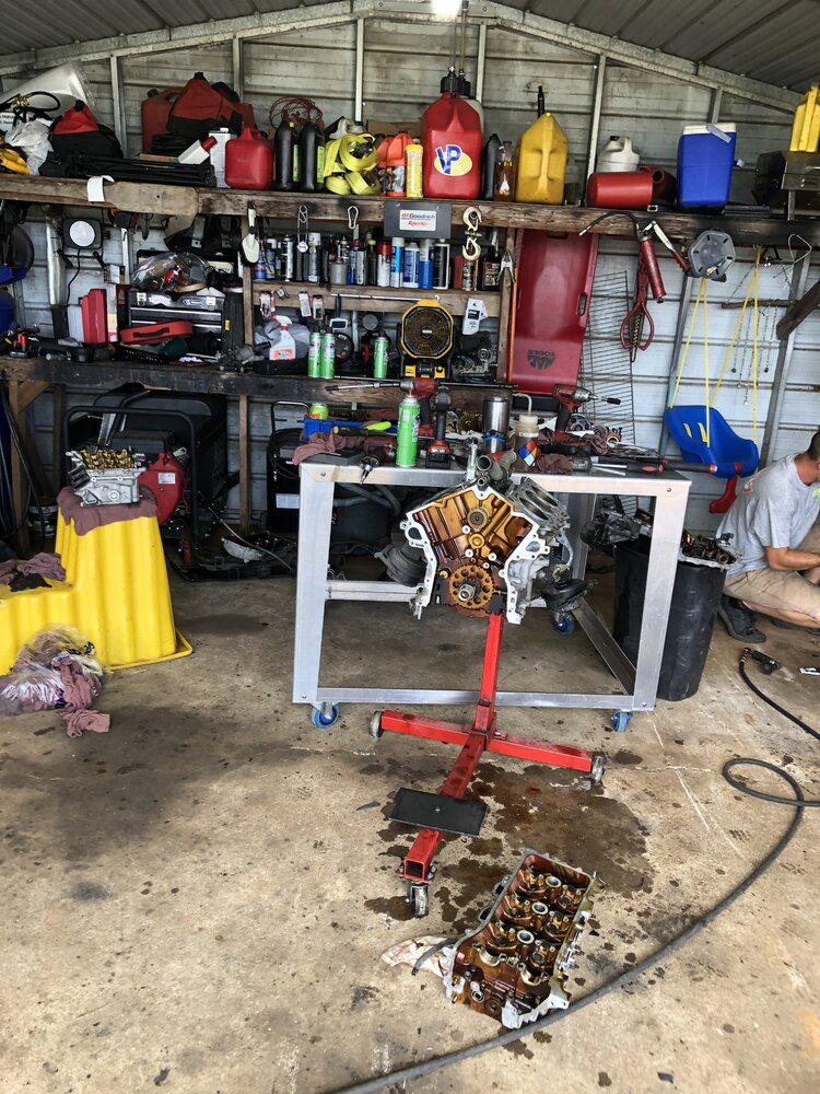

My wife’s let go about 180000. Did it myself with the help of a buddy of mine that worked at a Toyota dealer. All I can say is this ain’t no ol’ jeep motor.
DOHC, cam phasers, 4 timing chains, and all the covers and pans are machine fit and just use rvt so they have to be perfectly clean. It’s not a small undertaking in the least, and that doesn’t include any machine shop work. I don’t know what it would have cost at a shop but I’d say that’s in the ballpark.
