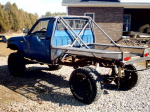

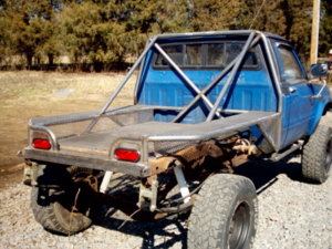

Few Pics of my 1st gen Build----Thanks To Unbreakable Fab and M&M Off Road (PJ)
Very nice! Did you buy it like that? '82 or '83?
82
Its a 82----------------And NO was a Stocker 4 weeks ago
Have added--
Power Steering
Cross Over Steering
Complete Rebuild on Front alxe with Lock Right
Weilded rear 3rd
Dual Cases 2.8 &4.0
Flat bed
Front Bumper
Propane next week
37 Iroks on Eaton Beedlocks

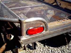

before paint on bed pics
a couple of pics before it was painted.

77 in to Top Of Roll Bar--------

Specs
Added Power Steering & IFS Steeing Box
Cross Over Steering
Complete Rebuild of Front Axle--- Lock Right & MarFeilds
Dual Cases--- 2.8 & 4.0 In the 2cd Case
Marlin Front Lift Kit
Weilded Rear 3rd ( left 4.10 gears)
All the above by UNBREAKABLE FAB
Flat Bed, Front Bumper and Rear Springs & U Bolt Flip Kit ByM&M OFF ROAD
Propain Kit From Got ProPane
37 Iroks on Eaton Beadlocks
Custom Driveshafts Olivers Drivershafts
Still Needs Winch & a Few other things
Out of all off this -Adding Power Steering was the most trouble(all of the Bolts that go in the Head where BROKE OFF)
