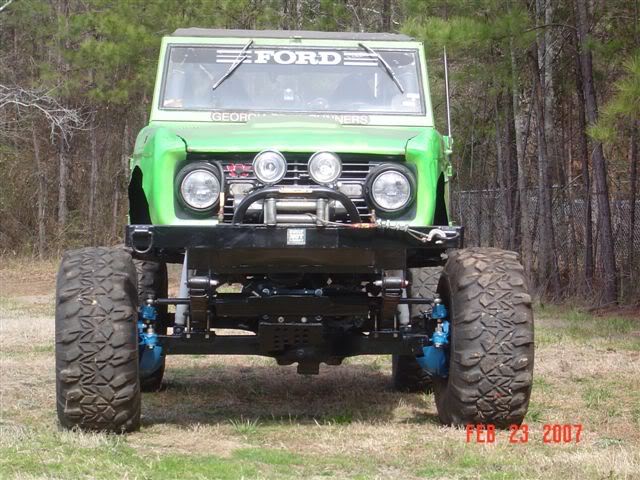

Bitch please. :rolleyes: how tall is yours under the frame?
What do you think of the clearance you've got with the 42's? I may go for the 40" creepy's then.
Plenty OK at Harlan.. yeah, I got hung on the diffs a few times, but that just means you have to work at it, and not just float over all the holes.
22" under the belly and 76" tall & a few inches lower aired down.

Nice score on the rocks.. but damn I'll be happy if I never have to tear down another stock rockwell.. Fawking nasty work.
Yeah I had a feeling....but thanks for taking all of the suspense out of it for me. I'm gonna leave one alone for a while, but I will probably tear one down to figure out how to remove the breaks and "flip the hubs" so I can get it under the front to set up the motor position. I still haven't had a chance to read through the whole rockwell thread SSWaters started. I'm sure you guys had some great information and sources in there.
Oh and I notice there is actually a boot guard on these rocks, or what looked like one anyways. Did yours not come with one or is that one not worthy? Obviously something I am missing there.
