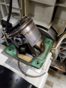

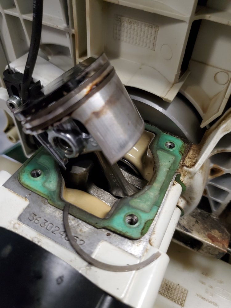

Pulled the jug off. Bottom ring spins freely, top ring is definitely stuck on the exhaust side. I snapped about 1/3 of it off trying to free it up. Looks like ring and piston kit for me.
