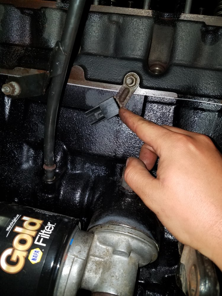

does anyone know what this sensor/connector is and its proper location? Its a single pole and just has the one bolt hole pictured.
I think that is just a ground with a connector.
Or, that is just a connector that hold a harness in place.
It's an ignition noise capacitor. It helps stop ignition noise from interfering with the radio or sensitive computer circuits like the crank sensor or wheel speed sensors.
