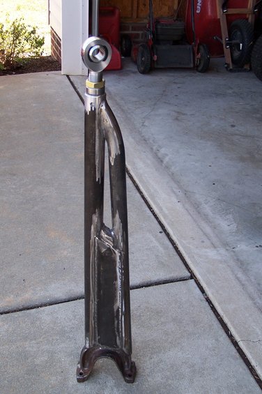

Old drop and radius arms:
New arms:

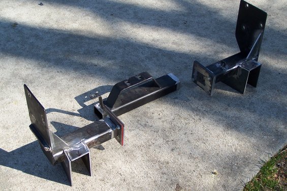

New crossmember:

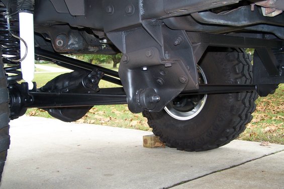

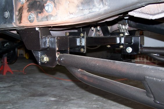

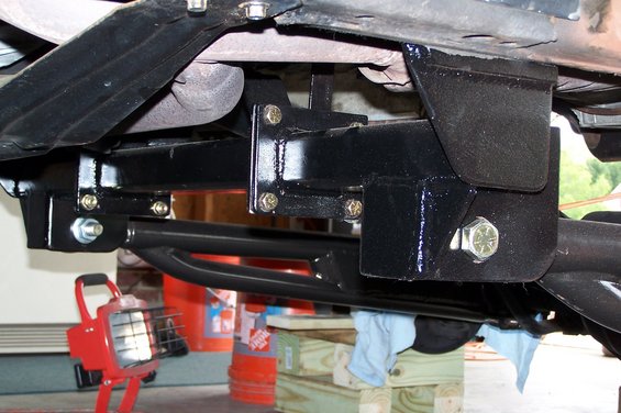

New arms and crossmember installed:

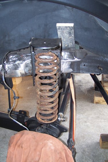

New adjustable coil buckets installed:
