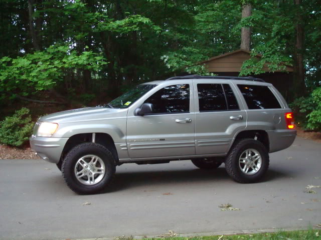

Here's my old 01 w/ some 265x75x16 BFG AT's w/ new OEM Up Country springs and 2" Budget Boost (approx. 3" lift)... Never had any death wobble w/ it like this.
