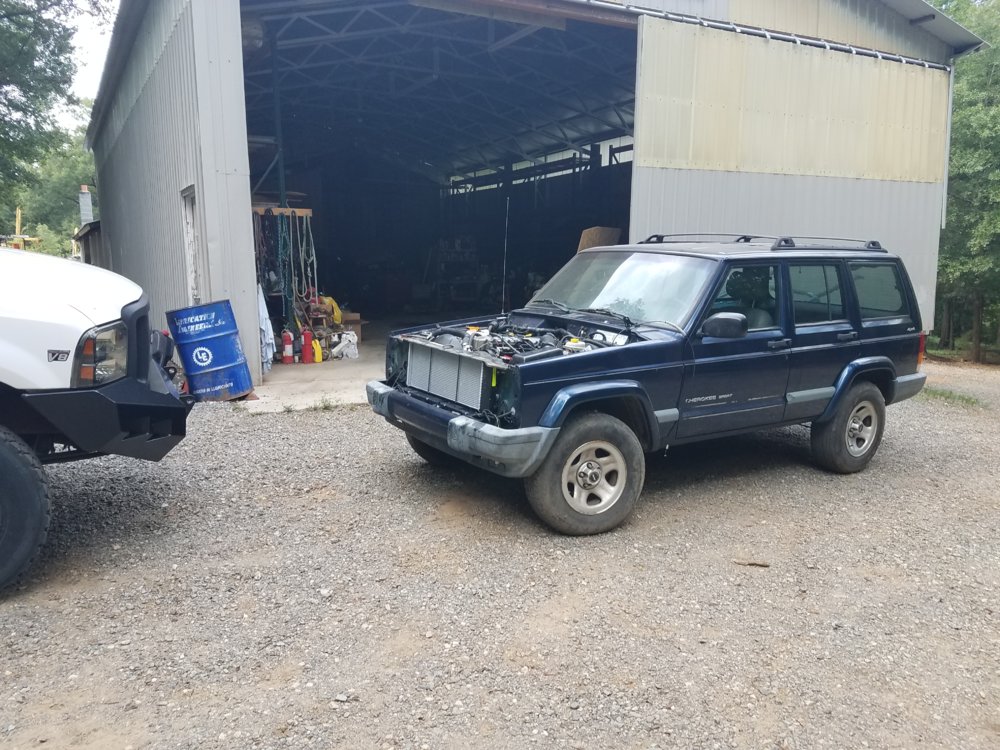

Figured ide start build thread since ill be making some headway now

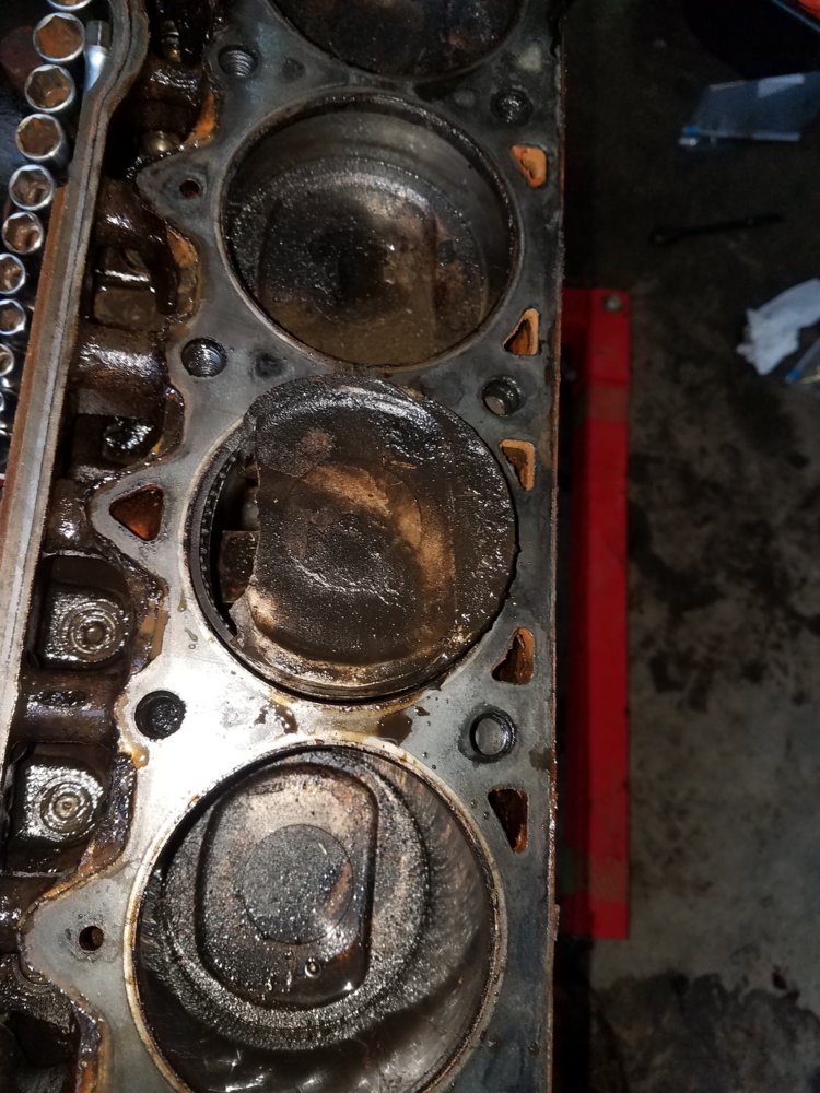

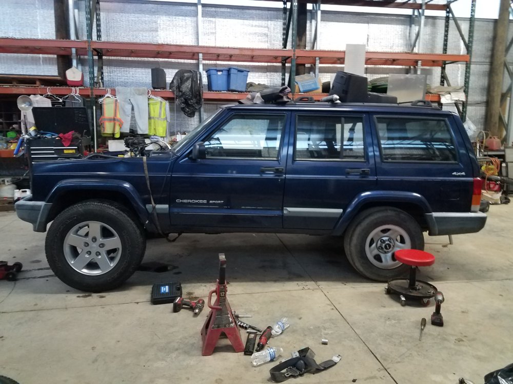

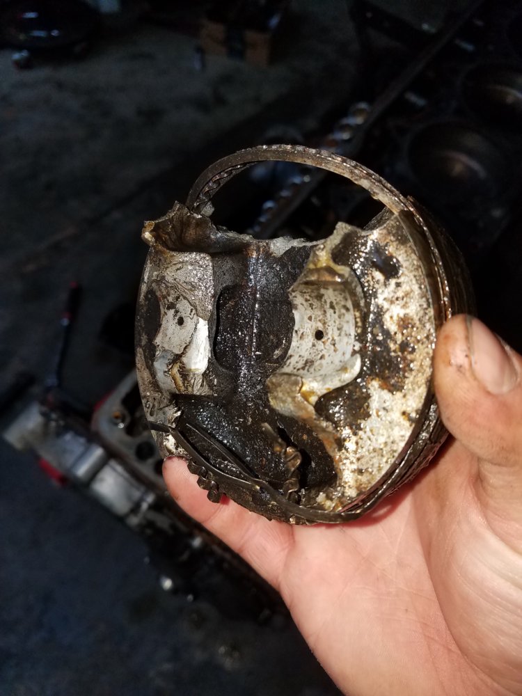

Starting with a 2000 xj sport that i got for free after the motor got a bad knock and the previous shop to work on it paid the blue book value to the owner. Building it to be a driver, mild wheeler, and huntin rig. Right now its a bone stock peach
120k

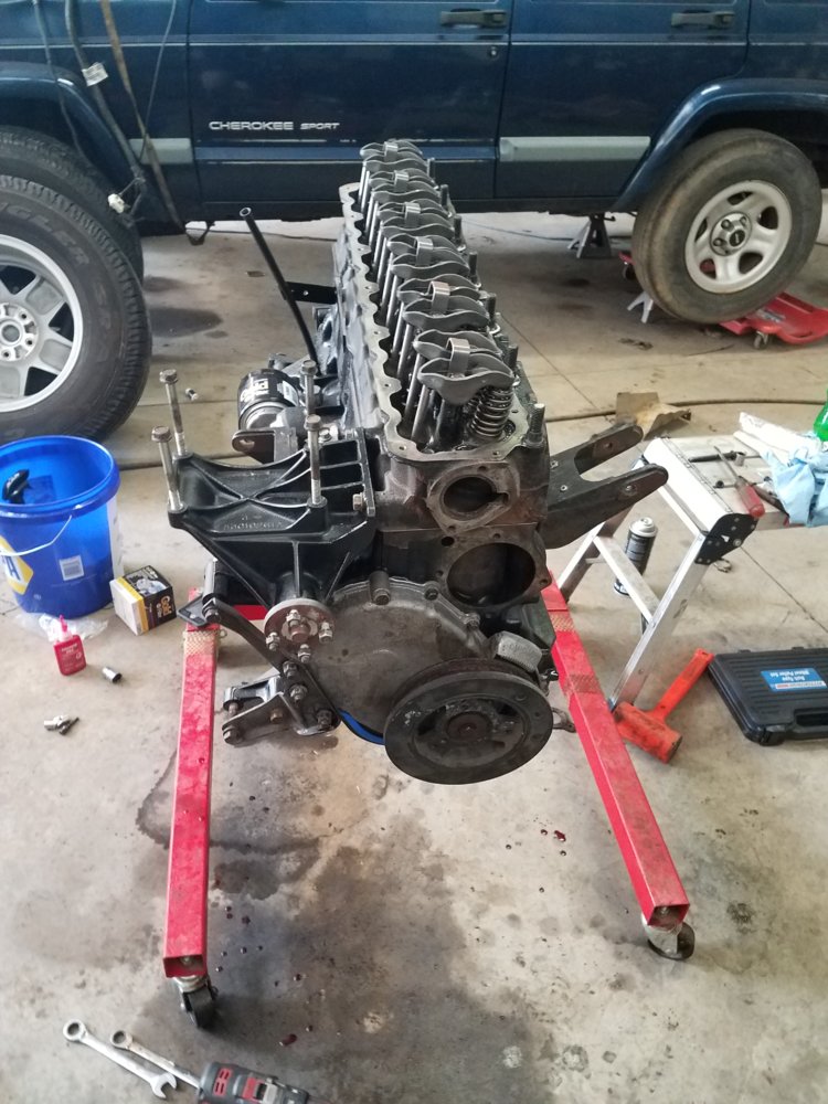

Motor is coming back from the machine shop saturday

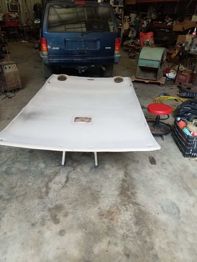

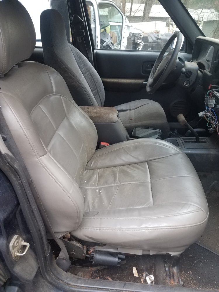

Cleaned up the interior since po kids liked to spill alot of sticky stuff

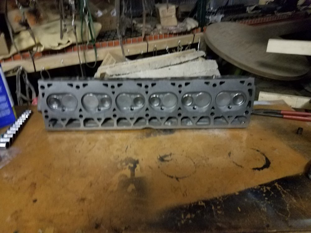

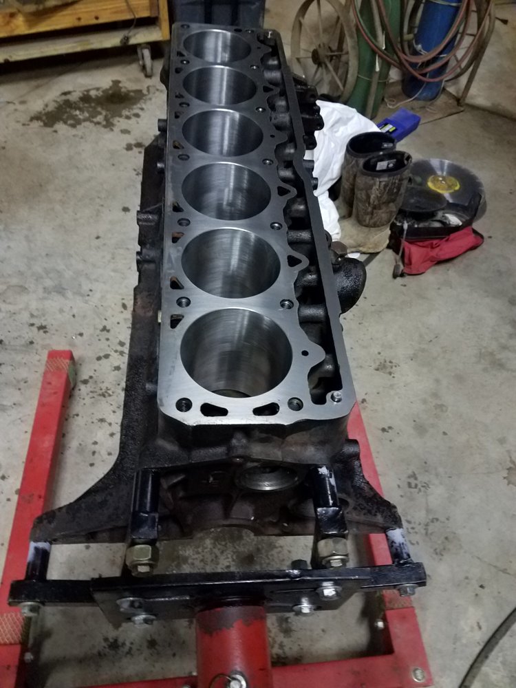

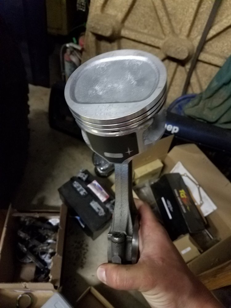

Pretty much a new motor other than the head casting, block casting, and crank core
Had to sleeve one cylinder, and went with ls valves and a 0630 head.

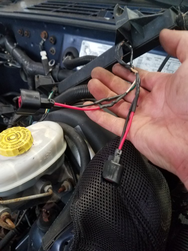

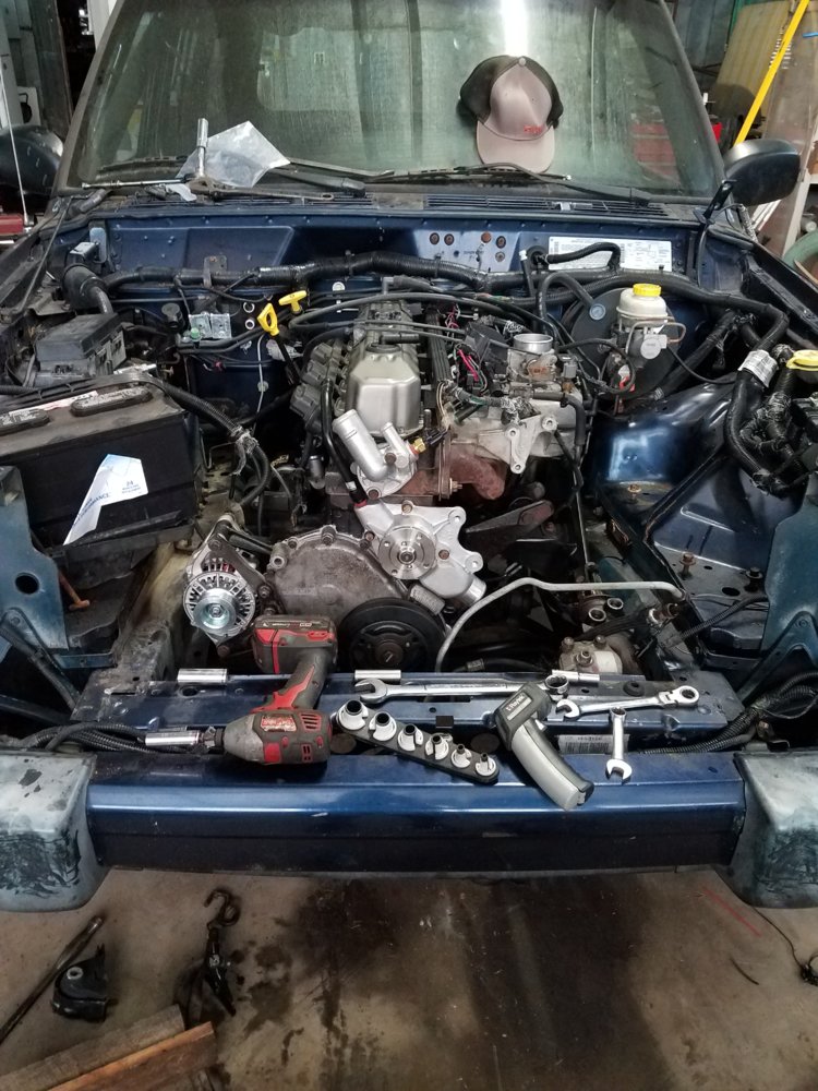

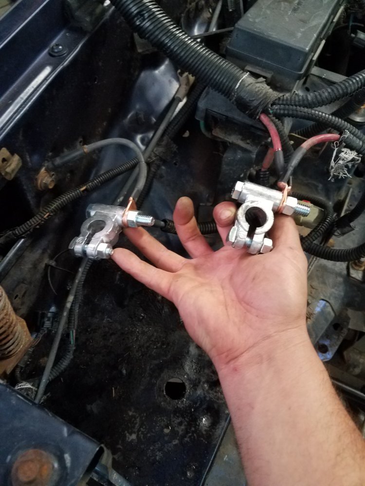

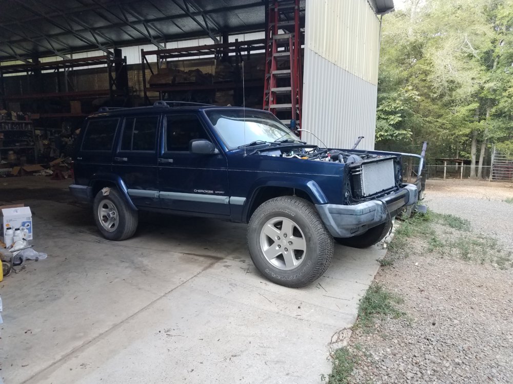

Finally got the motor back in the flood and a shop with no power but i did get new battery cables and injector plugs over the weekend
Not real sure, havent messed with jeeps much before this. Ide gues 285s or so

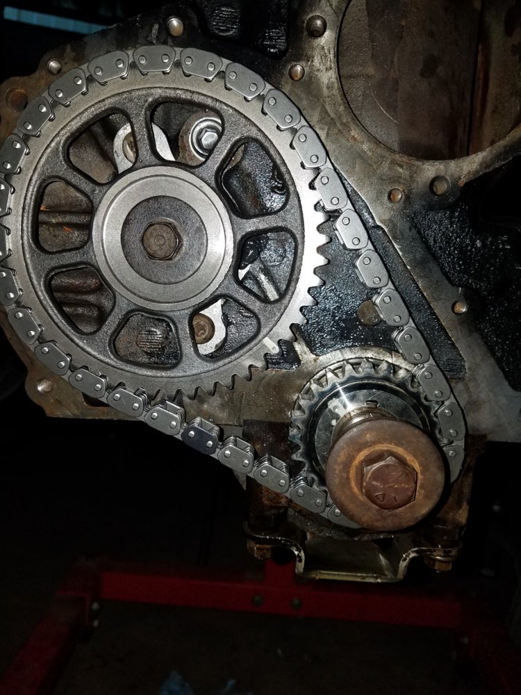

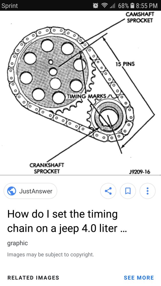

does this cam timing look correct? #1 at tdc and the dots aligned on center line but the other picture is way out in left field

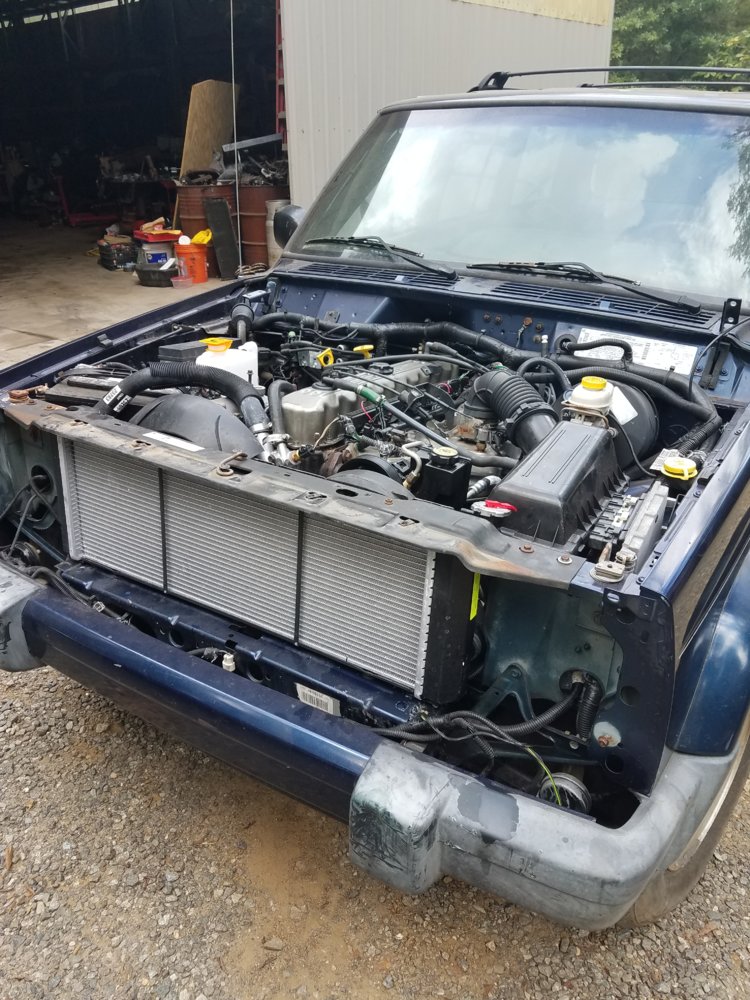

back in and test fired great. Once i get the rest of the parts on ill be able to break the cam in and start driving a little
today i got the cam broken in and drove it out of the shop under its own power. Still have a alot to do but atleast its moving now
