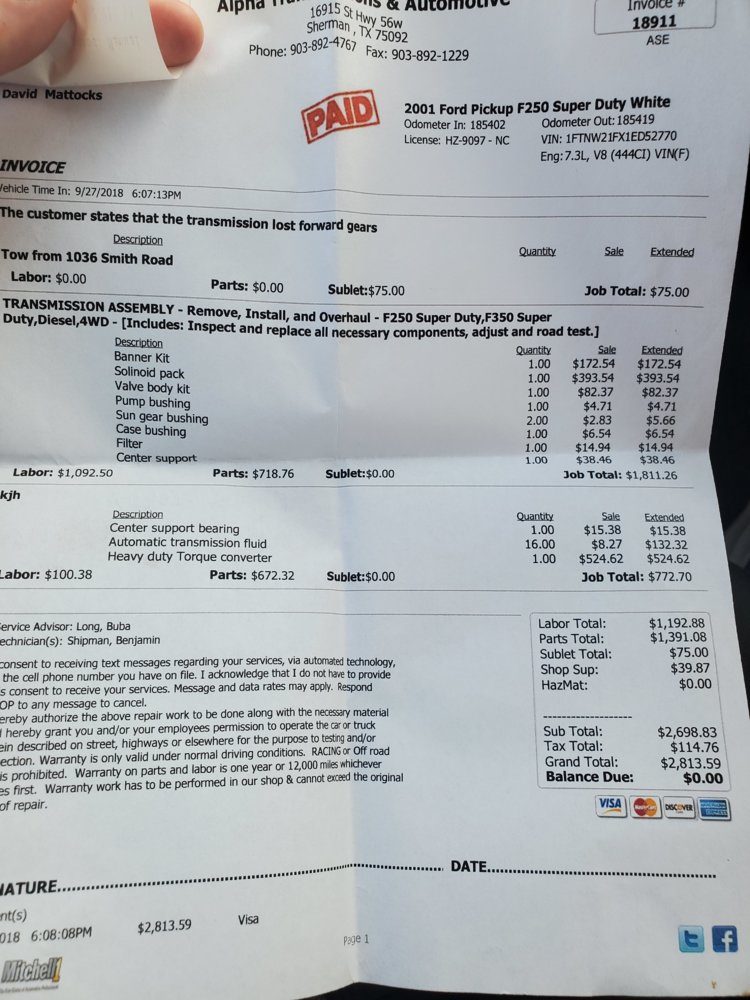

I have an 01 F250 auto with the 7.3. Last Sept the transmission went out in TX on a road trip towing a trailer. I had a shop in Sherman, TX called Alpha Transmission rebuild it. The price was $2800 with a heavy duty torque converter, brand unknown.
The truck has drove and shifted great for the most part every since. However, this winter I started doing some fishing and I noticed when the truck is on a steep incline of a boat ramp it will not move unless I give it a lot of gas, like the transmission is not engaging or something. I checked that the fluid level is at the top of the high mark. I put the truck on a hill at my house and it always takes about of gas and with a sudden jerk it starts moving. I am obviously not going to take the truck back to TX to let the shop look at it. Is there anything I can check on my own? Should I take it to a local trans shop and let them look at it? I am in Hoffman, NC.
I would be curious as to what stall they put in it. Does it still drive fine everywhere else, only issue is on a grade? How is the fluid?

I just called a transmission shop in Aberdeen. The guy I talked to said it sounds completely fine to him and that it sounds like it has a "high stall" torque converter. He says he is not worried because when on incline, once the truck starts moving it keeps pulling fine. He said he would be happy to drive it for me to be sure so I am going to try to get there Friday afternoon.

Also who puts a higher stall converter in a diesel? Doesn't make too much sense to me..
