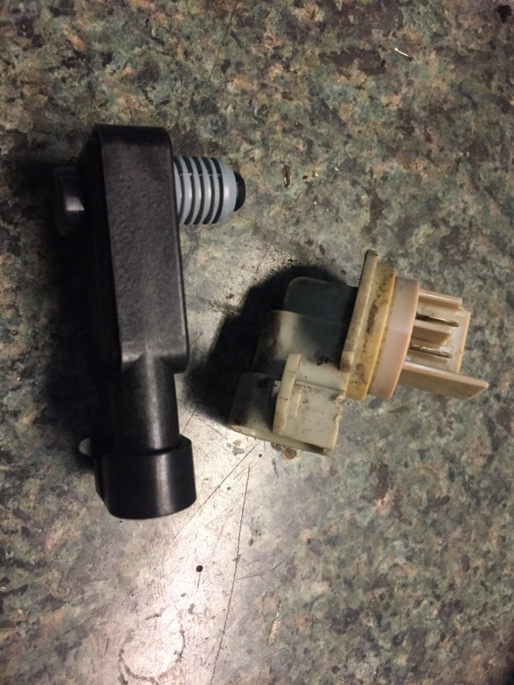

So I picked up a fuel pressure sensor thinking it was in my fuel tank got the tank dropped to throw in sensor and this is what I had instead of what they gave me...? Black one is the new part no clue what the other one is tho!?

Some didn't use the ftp sensor and some did.
Double check wiring for shorts going to the tps.
Holy hell lol why’s CHEVY gotta do this to me lmao ok gonna run down wires to tps! I didn’t know not having fps was a option
