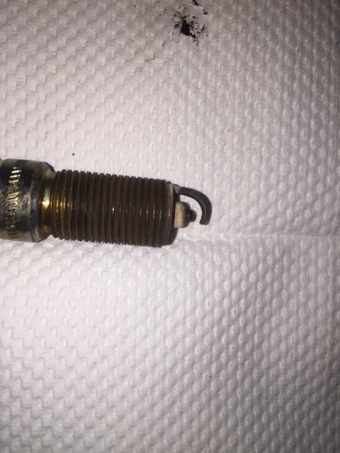

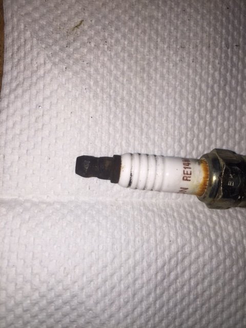

Plugs!!!!! Replaced the plugs, plug wires and ignition coil and it runs like new best I can tell. I searched around and actually found a TSB for the 2003 wrangler with 2.4L. The plugs and plug wires seem to have been failing especially in cold climates. This was a TSB back from 2004, so I guess mine being in NC all that time the plugs and wires must have done better for longer. It said something about a thermoset plastic in the wires but also they changed the plugs to a different champion number so I am not quite sure what the problem was but it seems it was never right from the start but I made it 70K and 12 years. Noteworthy is when Jeep came in they did the R and R without asking but NEVER did a formal recall. So if you came in for whatever during warranty period they just replaced but after the warranty, scew it I guess. The plugs were original based on the champion numbers. This 2003/04 wrangler SE 2.4 L 4cyl is an odd duck of the TJ era. It is the neon, PT cruiser engine. It has been great other than this little episode and this wasn't that big of a deal. The fix was <$100 and I probably replaced more than necessary but you have to remove the air box and throttle body to get to plugs 2 and 3 so I figured screw it I didn't want to mess around again if I didn't get the entire problem.

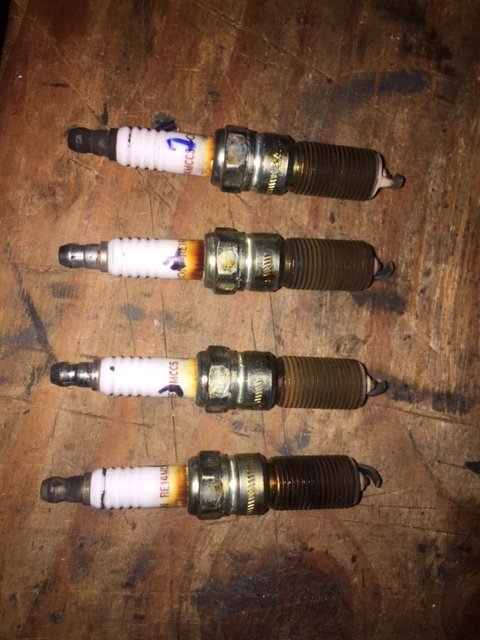

Old plugs. #1 and #4 the connection ends were very dirty. Champion number REMCC5 is the original number. The TSB called for a REMC replacement. Not sure what all that means.
I think these were done for

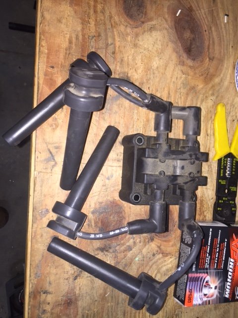

Replaced this half-octopus.
