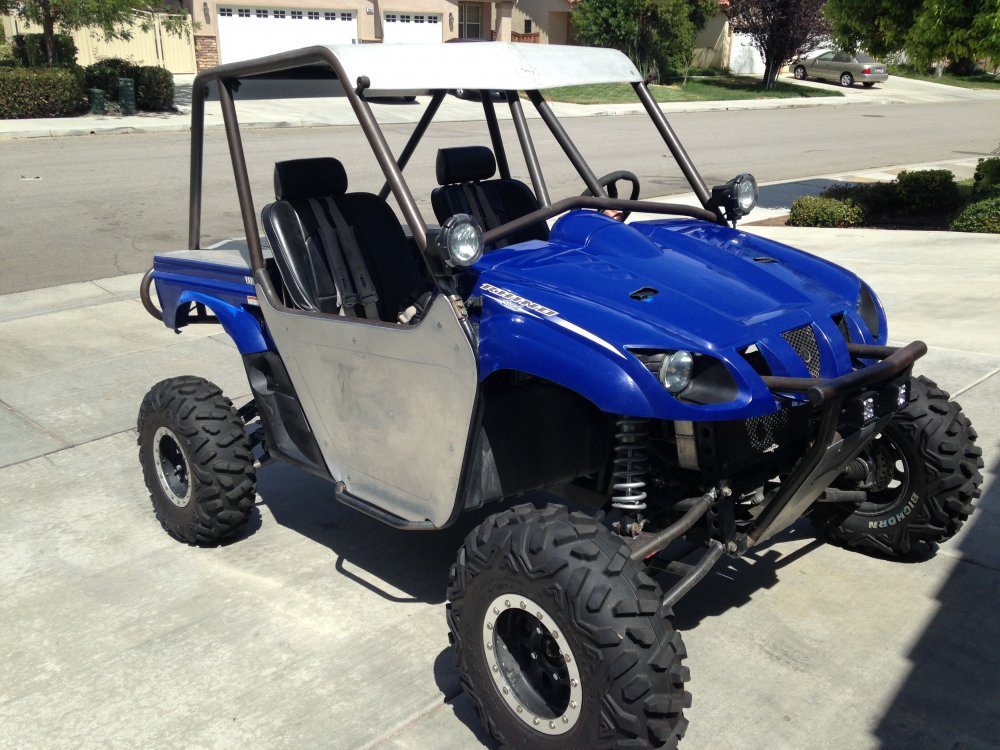

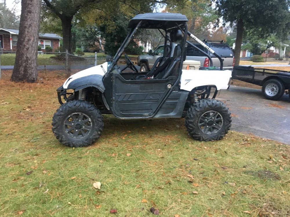

After years of riding shotgun I decided to sell off several project Seadoos (I used to flip 90's 2 strokes in college and had a few sitting around) and bought what I could afford to get out in the woods - a 2004 Rhino. This entire build has been done on a shoestring budget and in my carport as I don't have a shop yet.
This was the day I brought it home. It has a +6 HCR LT kit, 2.0 Kings, 686cc stroker motor, and a pile of other stuff. It was a solid foundation to start out, but had a lot of hard miles on it and the PO wasn't the best mechanic. The first trip out was to Top Trails in Talladega and the thing did remarkably well, walking up everything I pointed it at. The trip went great until I clipped a stump at speed and broke my left wrist, leaving me in a cast from my knuckles to my shoulder for 12 weeks and only kinda able to work on small projects. Power steering, new radiator and electric fan, new exhaust, radio, added lighting, water temp and fuel gauge were all added.

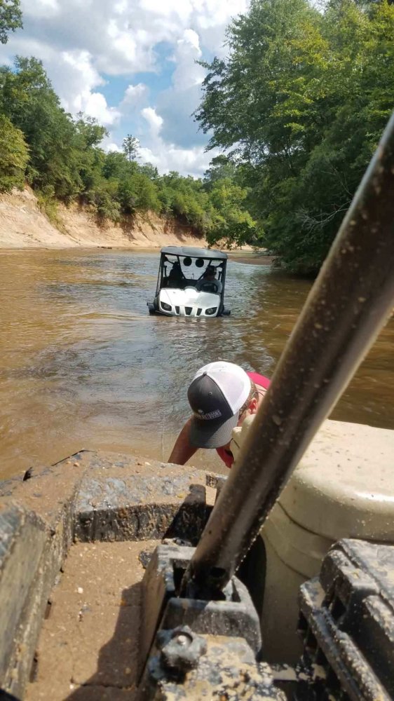

Mulberry Creek in Plantersville, AL (rock crawlers don't swim)

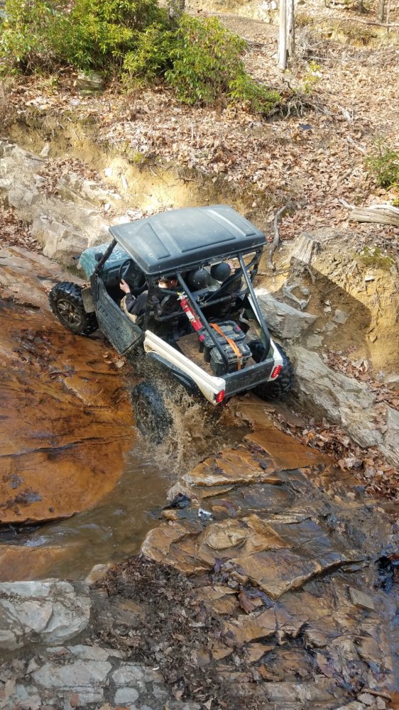

Copperhead at MMORV

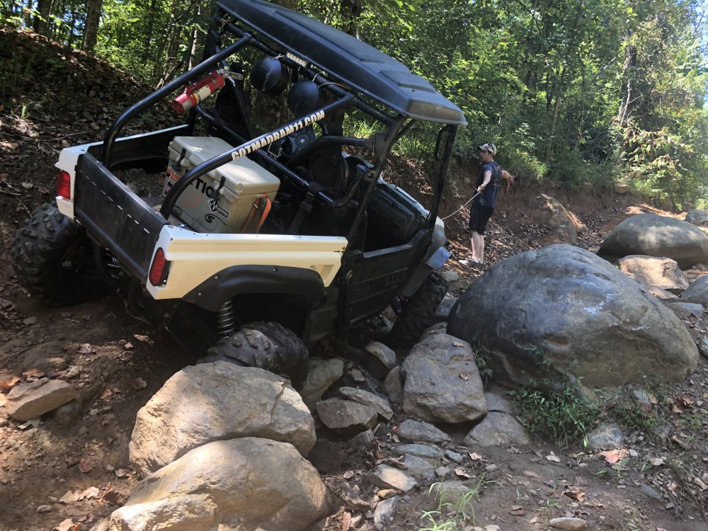

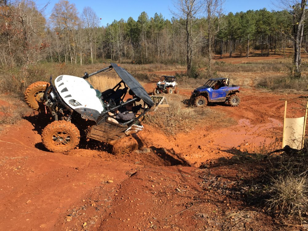

And no, I didn't make it up Boat Ramp . The last picture of me pulling cable was 15 mins into a ride and another broken axle, which almost lead to me selling this rig in December of 2019.

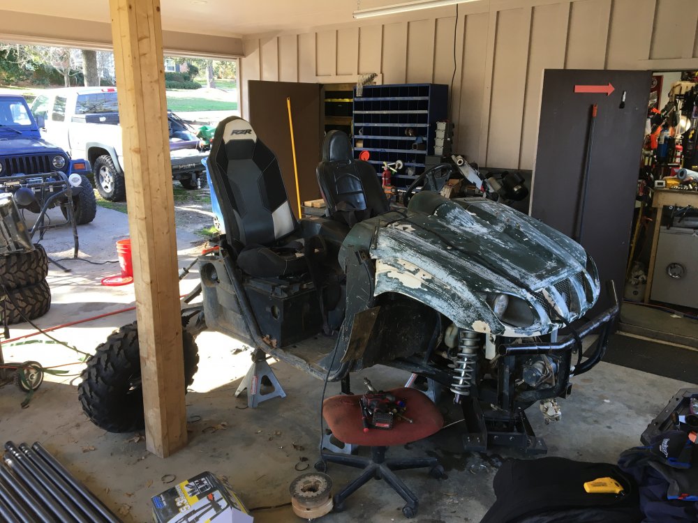

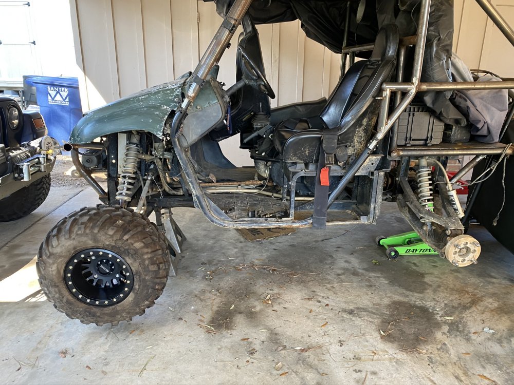

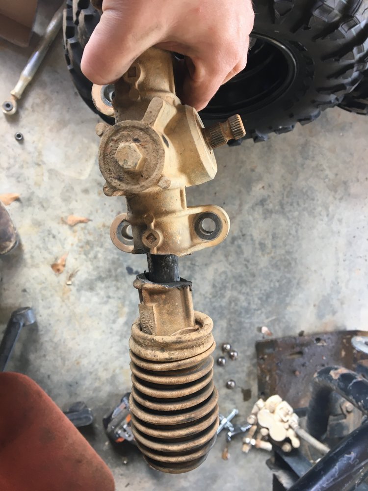

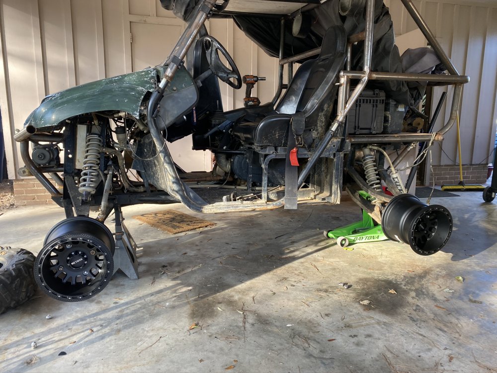

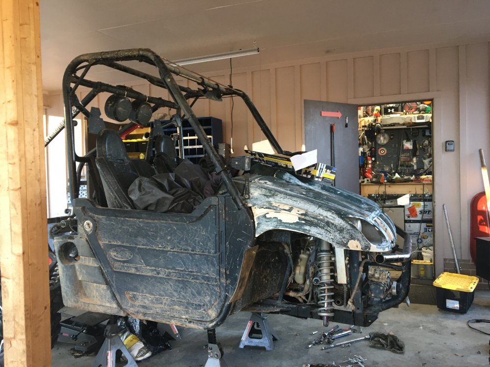

I flock to beaters (if you know the reference, we can be friends), so after a lot of thought and an improved budget (read: wife finished grad school and got a job), I decided to blow the Rhino apart and fix all the issues and wear items. The end goal is to be bulletproof reliable and improve the rear bed situation to have room for enough gear to support a Windrock level ride. There won’t be much tech in here since none of this is groundbreaking, but I wanted to show the process if nothing else.

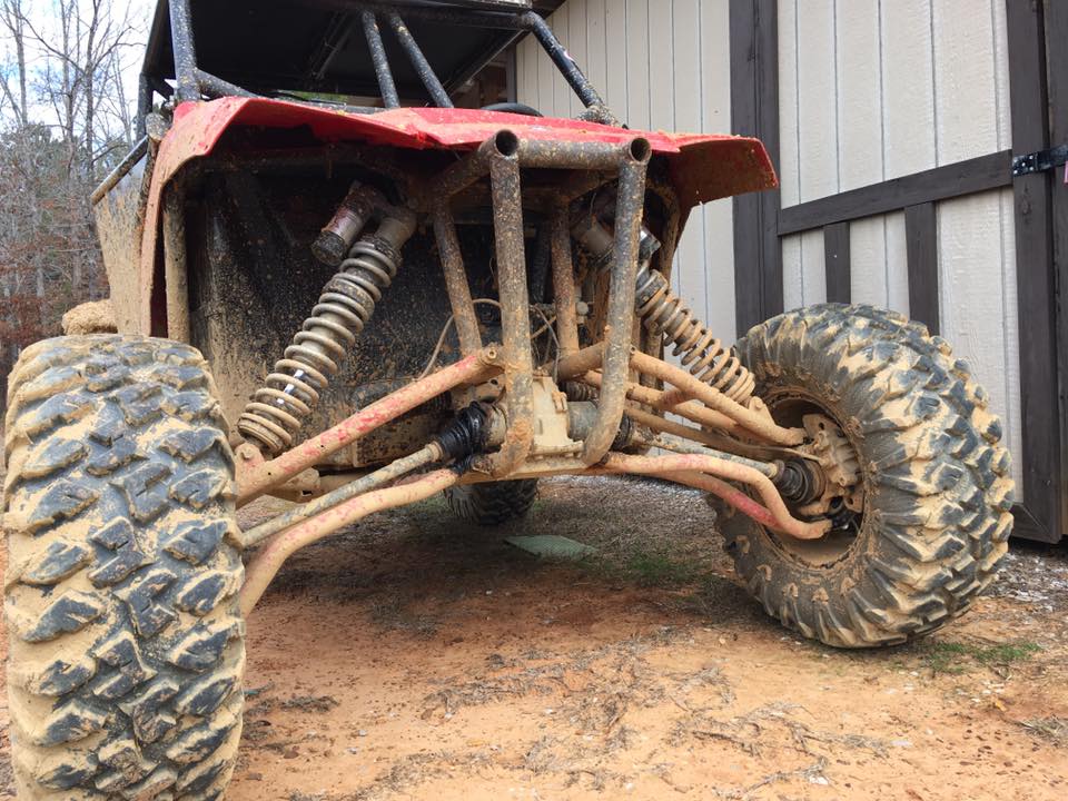

Everything that moved was beyond worn out, so every bushing, bearing and rod end was replaced, along with downsizing tires to 27” Ranger takeoffs to hopefully help the axles live. Also a new steering rack, belt and all fluids were replaced.

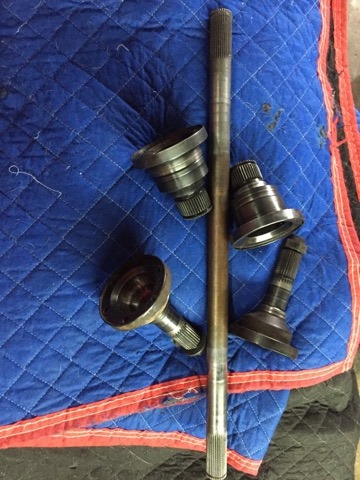

The main issue with the axles stems from the use of factory CV joints, which severely limits the shaft size. I have used (and broken) 4340 and even stepping up to 300m shafts hasn’t solved the problem yet. I know custom axles that replace the factory CVs are inevitable, but that is a significant investment I'm trying to avoid as long as possible. Another option I’m exploring is the use of VW axles. Back when R6 swaps were popular in Rhinos Gear One made a conversion kit to allow the use of VW Type 1 axles .

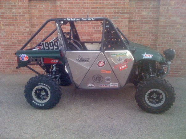

Gear One VW Tye 1 axle kit.

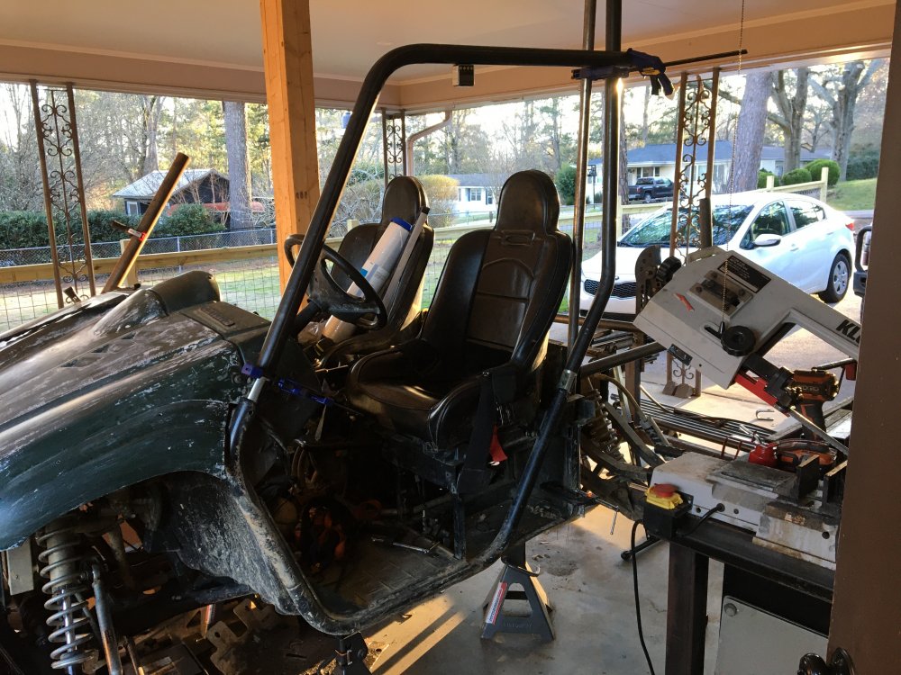

Since I was in it this far into this project, scope creep took over and out came the bender and notcher. Cage time! :D

I guess using RZR axles/diff in the front is not possible?
Or what about a 930CV conversion? The CVs are pretty cheap and can get upto 30 spline..
I've contemplated the axle issue six ways to Sunday and haven't really settled on anything yet. I hope with the suspension now being tight, smaller tires and the addition of limit straps the axles will hold up and the problem is solved.
If that doesn't work, the easiest option is to order Gorillas or Turners for all 4 corners but I've heard they're getting difficult to purchase (and $500+ each).
For the not so easy option: Rhino diffs are actually pretty stout and will tear themselves out of the frame before they grenade, but stronger axles would only put more of a load on the diffs. I am big proponent of using off the shelf stock parts, so the thought of cutting the frame off at the firewall, tubing it out and swapping the diffs and suspension out to accept stock RZR/ YXZ1000 parts is appealing, similar to what a friend did to repair his XP900.

I made a list of things I wanted to incorporate into the design and spend a few hours making sure what I wanted wasn't going to end up in a fail thread somewhere. What I landed on was:
1. Keep stock mounting locations.
2. Lower the cage height to allow wearing a helmet plus 2” to any tube.
3. U4 cars look cool. Make it look like one of those.
4. Integrate a tube bed with storage, but maintain access to the rear of the machine for service.
5. Cage (or doors) needs to be wider than my shoulders (it’s not currently).
Here is what I was aiming for:

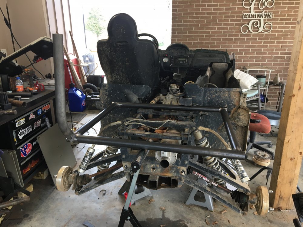

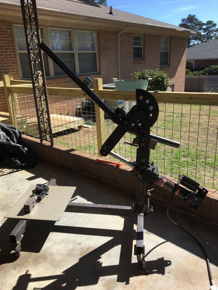

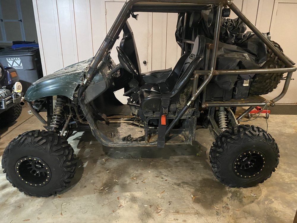

I picked up 120' of .120" 1.75" HREW (because not racecar) and started bending tube with my Protools 105 bender. For anyone holding out the SWAG air/hydro conversion is worth its weight in gold! The welder I’m using is a $100 Harbor Freight parking lot sale Vulcan Omnipro 220, which replaced my 110v Lincoln 140 machine. So far, I have been very impressed with the HF welder.

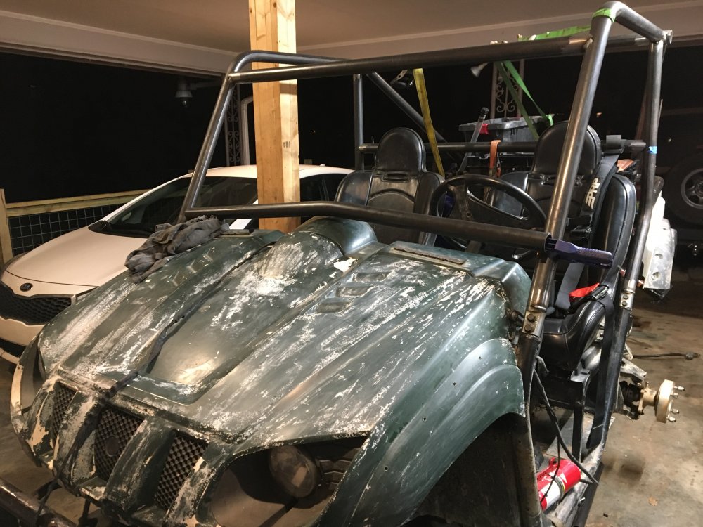

Off came the factory 'cage':
I started with the A and B pillars
Looks like a cool project. Check into Cobra Axles out of Texas I believe. They have pretty much replaced Gorilla as the "Go To" axle.
I also believe I have a Superatv power steering kit that's new in the box for a Rhino in my storage.

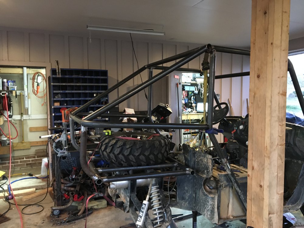

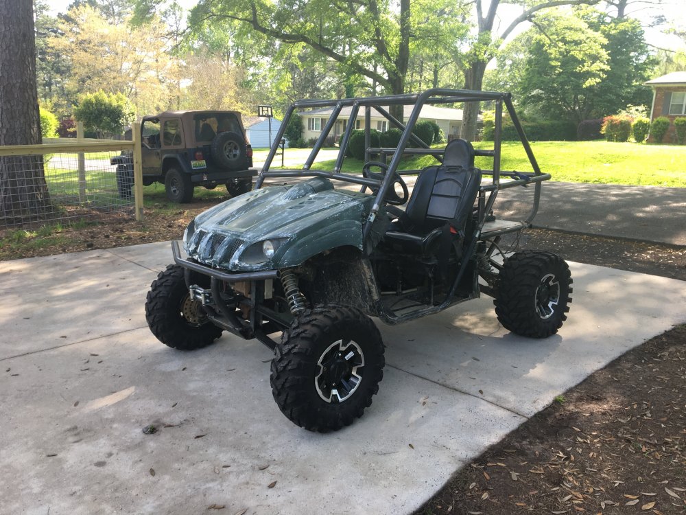

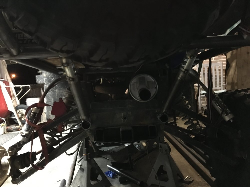

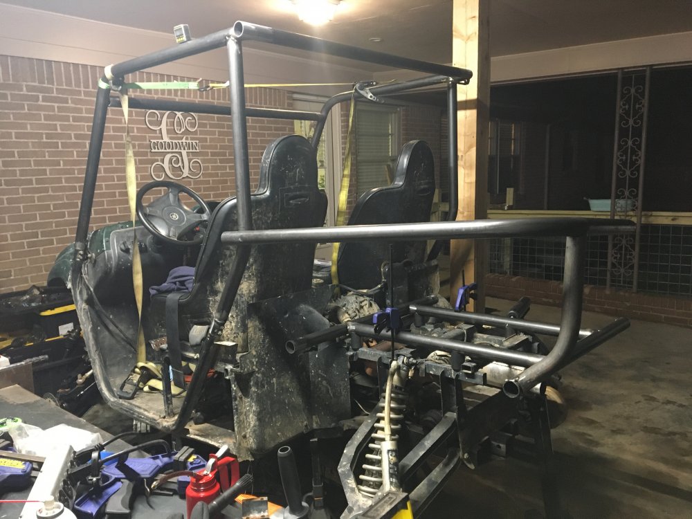

After getting the passenger compartment roughed in, I moved on to the bed area.
Bed roughed in:
Bed tied into the frame:

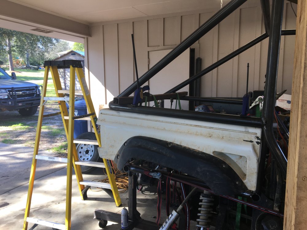

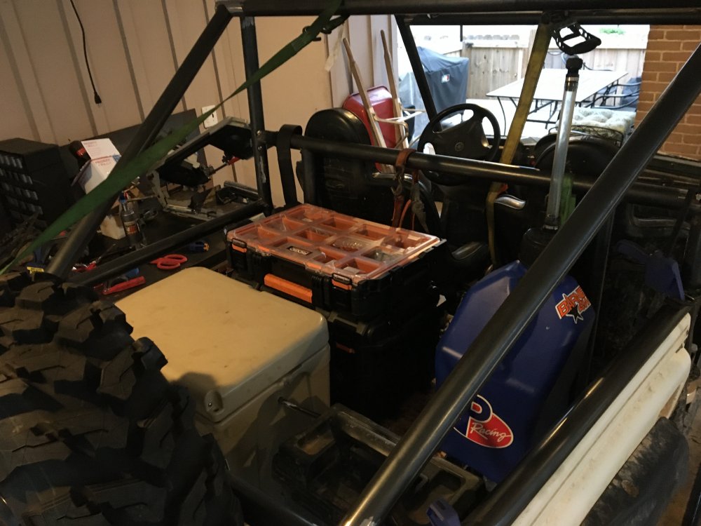

I am planning to attach the factory bed sides to the bed. This was the first mockup.
The bed was dimensioned around this gear specifically, with a little room to spare.

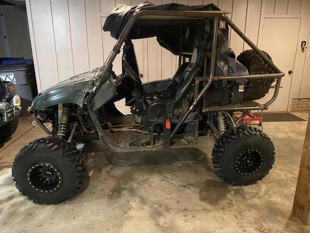

Slowly catching up to current day.

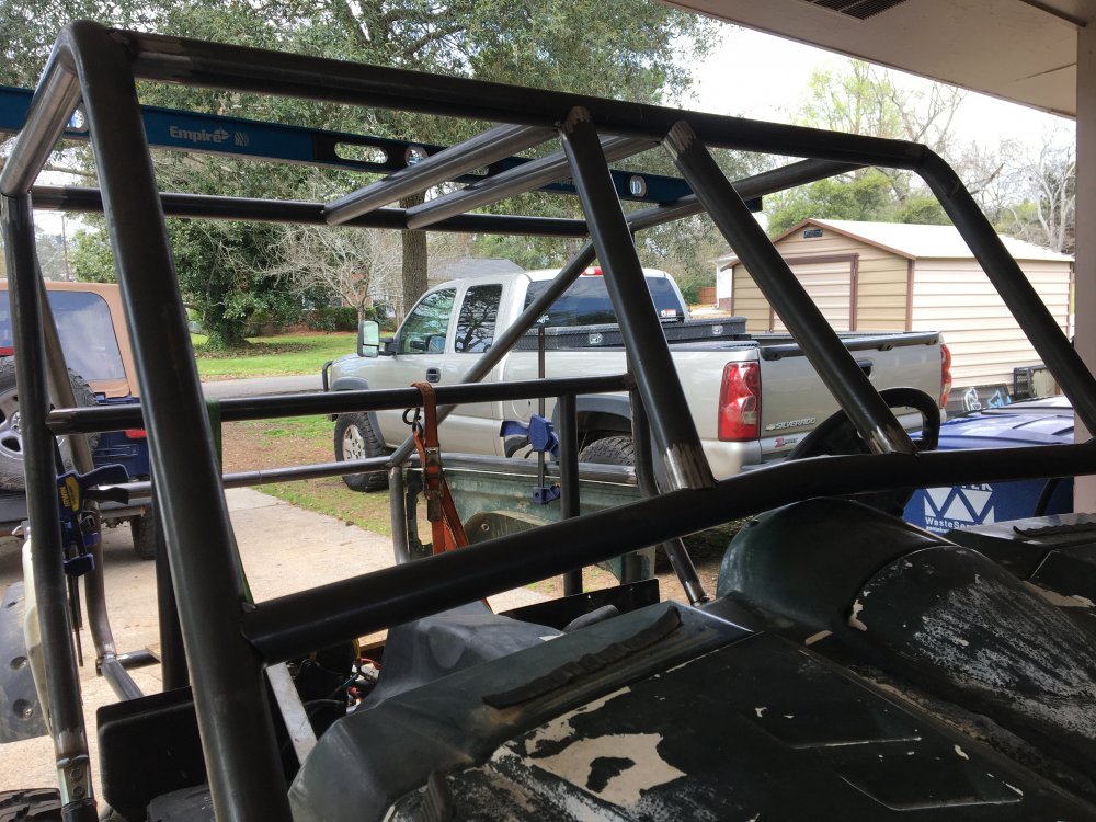

Windshield bar installed.
Now, before you tell yourself 'This idiot doesn't know what a triangle is' fear not. Triangulation is coming.

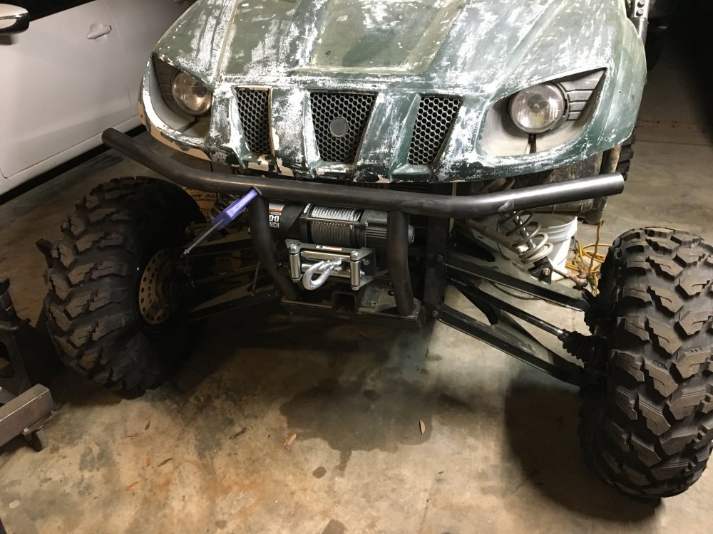

The stock bumper on a Rhino leave a lot to be desired, so a new piece was in order. I never liked how low the winch was from the factory, so the winch was mounted further up and the bumper itself tucked in tighter to the body. I replaced the old ebay 3500# winch with a Badlands 5k unit from Harbor Freight. Several guys I ride with have had great service out of these units, so I decided to give one a try.

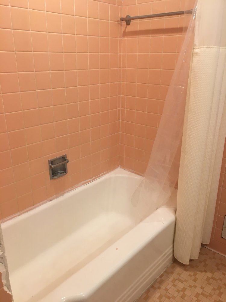

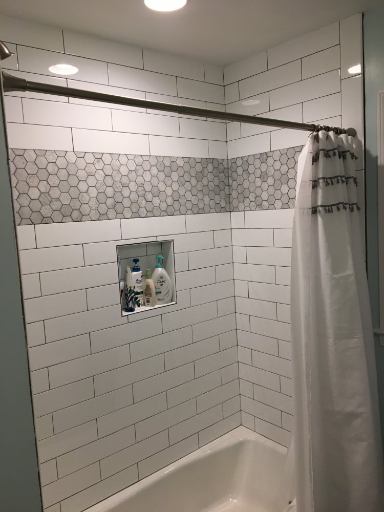

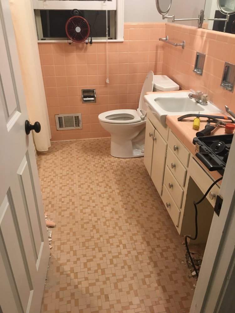

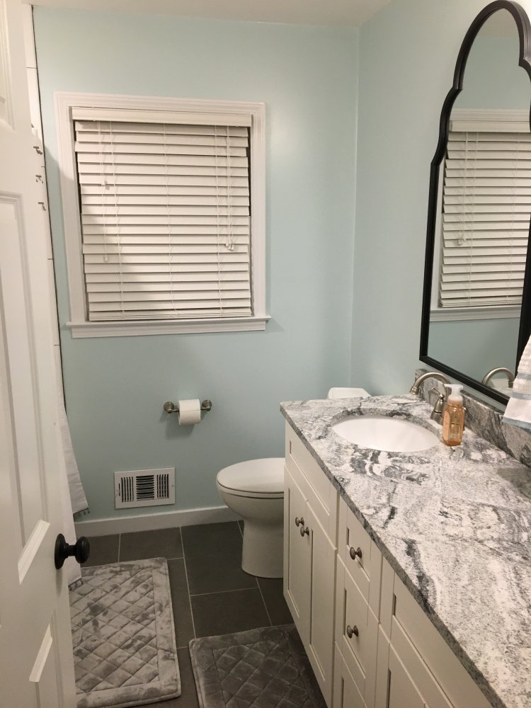

My wife and I bought our house summer of 2017 and have been slowly putting our touch on it. It was built in 1960 and has been well taken care of, but hasn't been updated. Our hall bathroom was a beaut:
Memorial Day weekend brought out the weapons of mass construction and the bathroom was torn down to the studs and subfloor. With the help of my dad, we did all of the rework ourselves with the exception of the tile. I wrapped this up a few weeks ago.

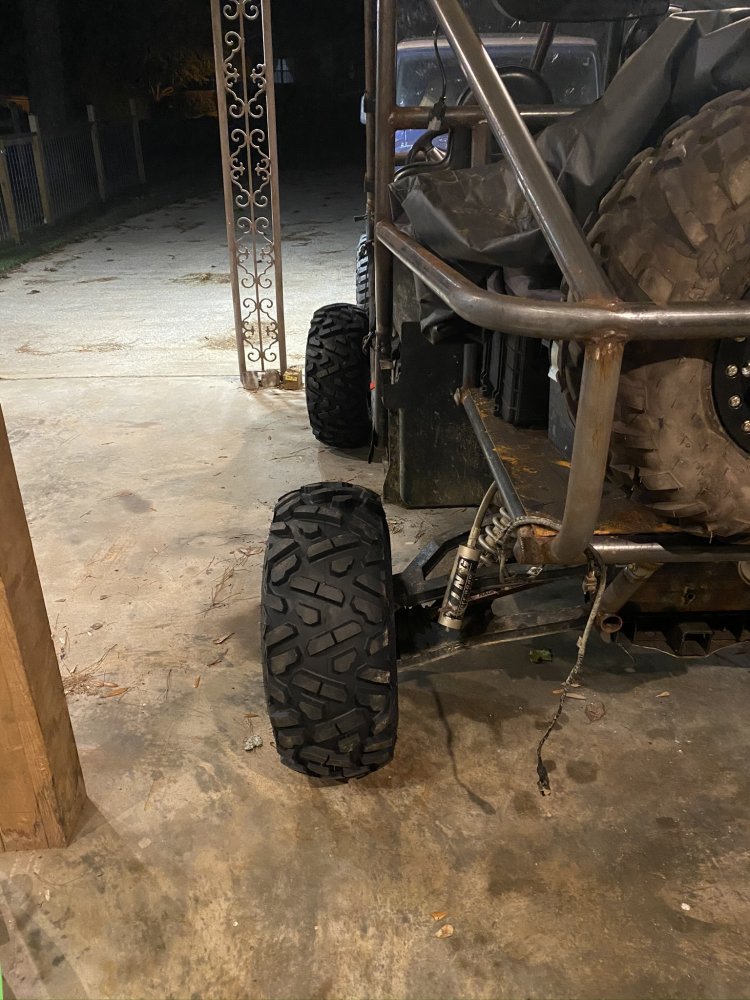

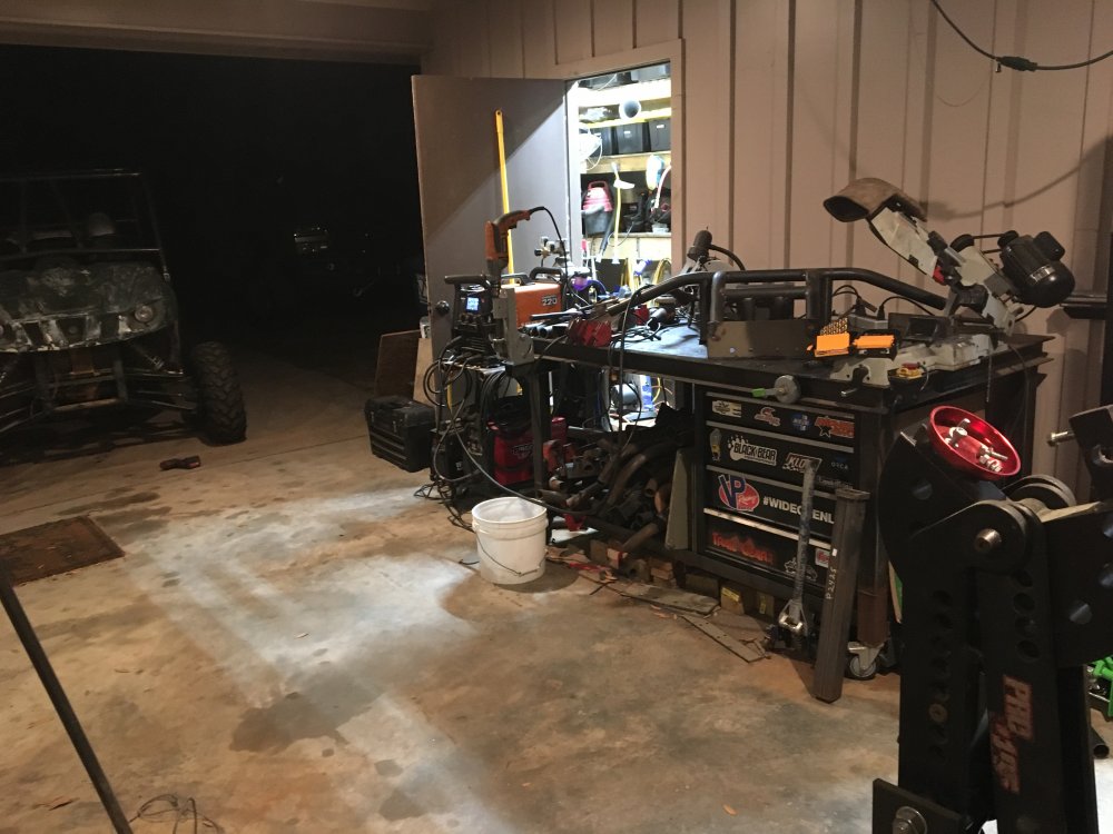

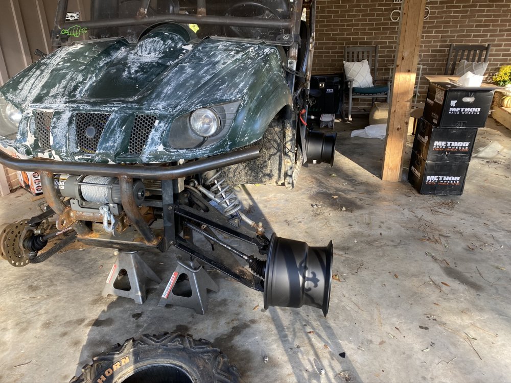

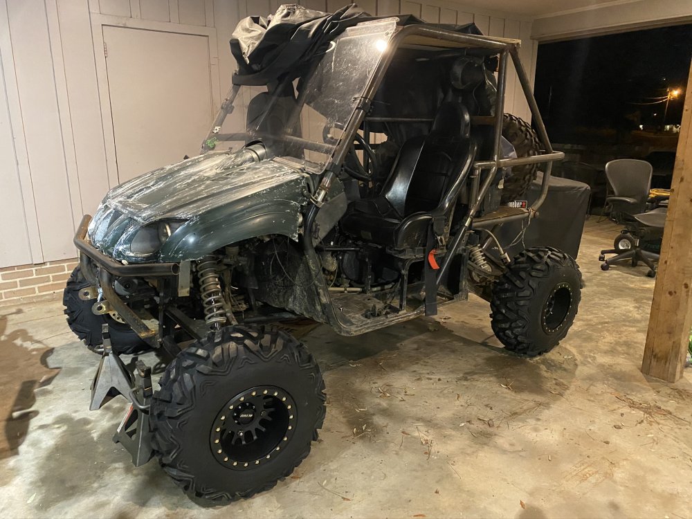

Unfortunately, I haven’t made any progress in a while because most of my project funds and time have gone into setting up my new shop. I’ll post shop updates later (for anyone that might care). The only real update is a set of new wheels and tires. I got a ridiculous deal on a set of new 12x10 Method 406 beadlocks that I got for $22 each. (Retail is $229 each). They’re wider than I would have liked, but for that price I like them just fine.
I'm impatient and couldn't wait to see what this would look like so on went the spare 26x11. It looks ridiculous and I love it. I have a set of 27x10x12 Bighorn knockoffs on order and will have them mounted this week so of course I’ll post pics of those.
Got the tires mounted and kinda bolted up (new lugnuts were on the way). The 27x10 tire size looks perfect on this rig, even with the wider wheels
Nothing quite brings back motivation (and temptations for financial irresponsibility) for a project like new tires and wheels.

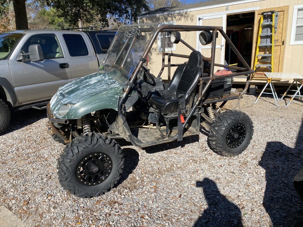

After a week of the new tires and wheels I realized I liked them...because they were cheap. I threw them up on FB to at least get my money back and ended up selling them for $850 :rockon: (had $520 in them). I settled on a set of 14x7 System3 SB-3 wheels on 27x11 Wanda tires. This allowed me to ditch my wheel spacers and have a MUCH larger tire selection (even though I still went with the China cheepies).
I got a text last week that our riding group was going to my favorite town at one of my favorite parks: Boggin on the Plains (formerly Great American Park), so I've decided to zip tie this thing together enough to go wheeling this weekend. Prep started Sunday night to get the essentials in order.
