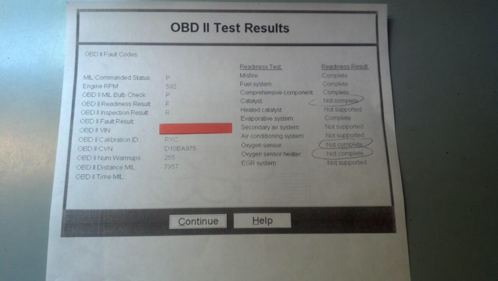

Ok. Replaced both fuses. He took it to get it inspected and this is what he got back.
ai1367.photobucket.com_albums_r794_woeiscoryd_b8e366ccb989624c6251738cf34a919c_zpsd48ae6a0.jpg
Last night it was throwing the p1000 code and the p1233 but neither showed up on this scan.
Is the "not complete" telling us this part failed or there isn't enough data to complete the task?
You can get the drive cycles for each monitor and set them like that. Like transman said sometimes it takes a long time to set them driving normally depending on your "normal" the station can print them out for you or you can find them on the web. I can get them and email them to you If you can't find them. just pm me.
Disconnect the battery for a few minutes. Reconnect, start it and let it idle for a few minutes. Get in it and drive an 8 mile loop: one mile at 30mph, one at 40, then 50, and 60. Then turn around and do the reverse, 60, 50, 40, and 30, all one mile each. With out turning the truck off, drive normally to the inspection station and tell them to check it. DO NOT SHUT IT OFF, doing so could reset a status to not ready. I worked for 3.5 years at a ford dealer, this was my quick method for setting readiness after doing a CEL job.
