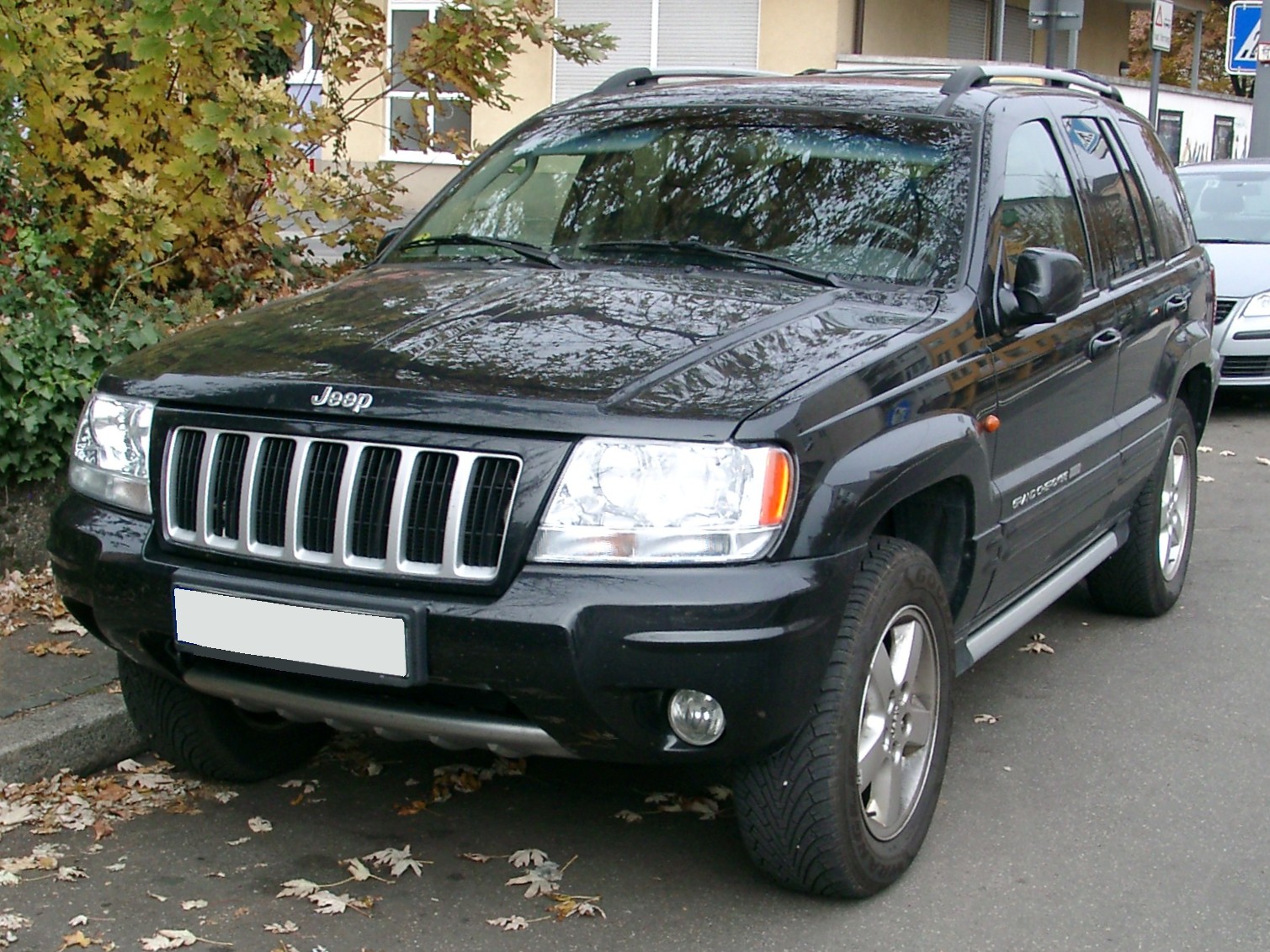

Look at his headlights, if they are flat at the top it's a 99-04 WJ, if they have the humps at the top it's an 05+ WK.

SFA stopped in 04 with the WJ, 05+ (WK) are IFS. A Dana 35 is a rear axle, you had a Dana 30 up front.
WJ:
aupload.wikimedia.org_wikipedia_commons_2_20_Jeep_Grand_Cherokee_WJ_front_20071102.jpg
