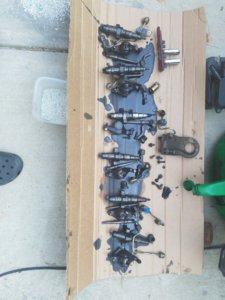

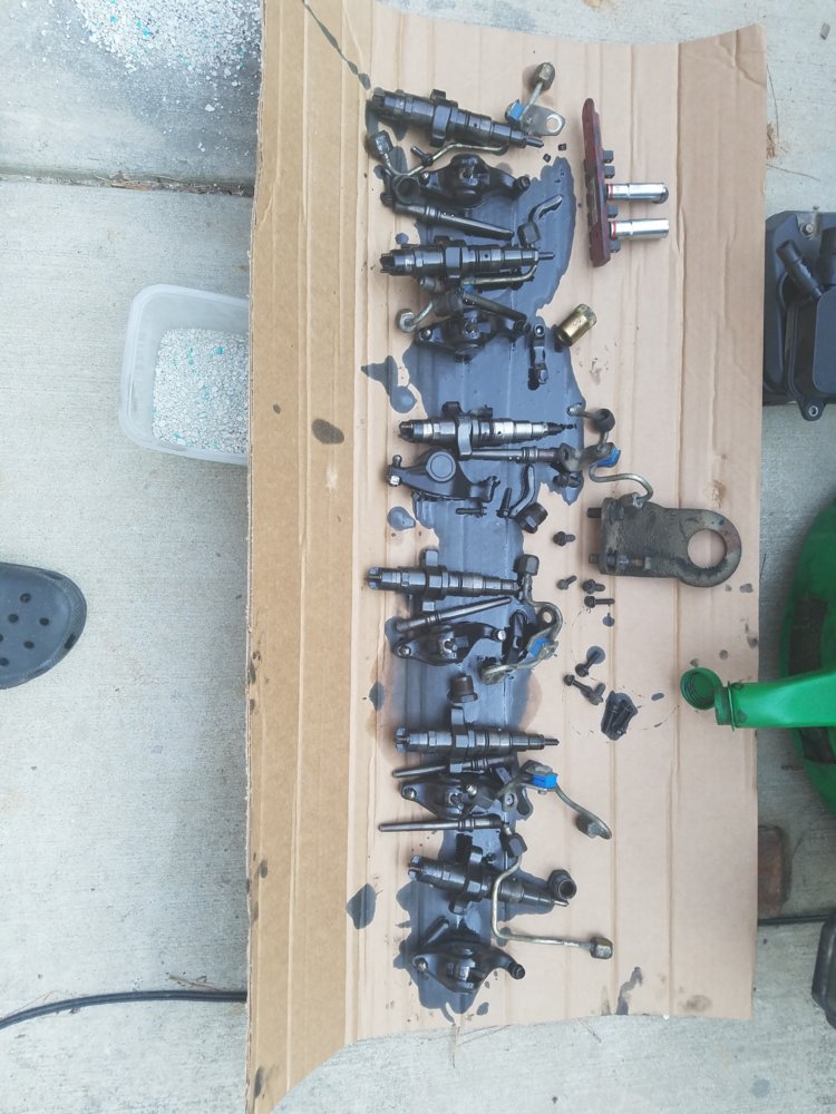

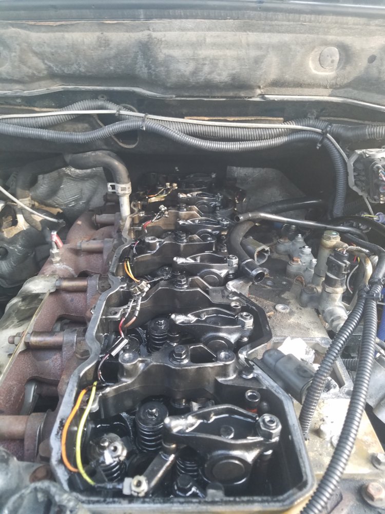

This weekend will be adding 50HP New BMS injectors and a PacBrake exhassut brake and on board air.
Pics to follow.

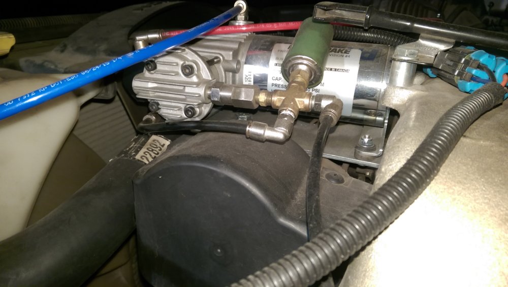

The PacBrake compressor is a massive PITA to install. Two bolts, but you can't get to one of them with a wrench.
The compressor looked pretty easy. Mounts right to front of engine. Will find out tomorrow. :)
I thought the same thing.
It might be easier if you have one of the trucks with the accelerator position sensor mounted down on the frame, rather than on the side of the head.
Got the new injectors installed. Got a bad one in the new bunch so had to replace on of them. Vendor, DAP, sent me a replacement were real good to work with. Now it is running great and all my injector noise is gone.
Also got the exhaust brake installed. It works great.
The pacbrake is the single best thing we've done to ours. Use it all the time.

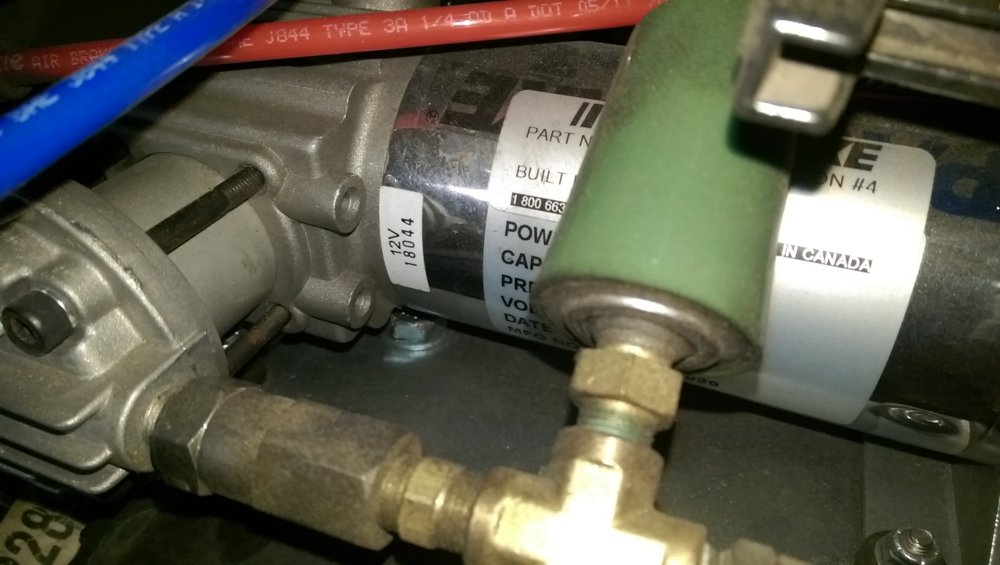

This is the bolt I was talking about. 75% off the total install time was spent on this stupid thing. And the APPS got a dead spot immediately after the brake was installed. I don't think it was a coincidence. :shaking:
Edit, added a wider angle for context.
View attachment 244915 This is the bolt I was talking about. 75% off the total install time was spent on this stupid thing. And the APPS got a dead spot immediately after the brake was installed. I don't think it was a coincidence. :shaking:
Yeah that bolt was a pain. I chased the treads in the manifold with a tap first and I do not have an apps there. Mine is all in the cab.
