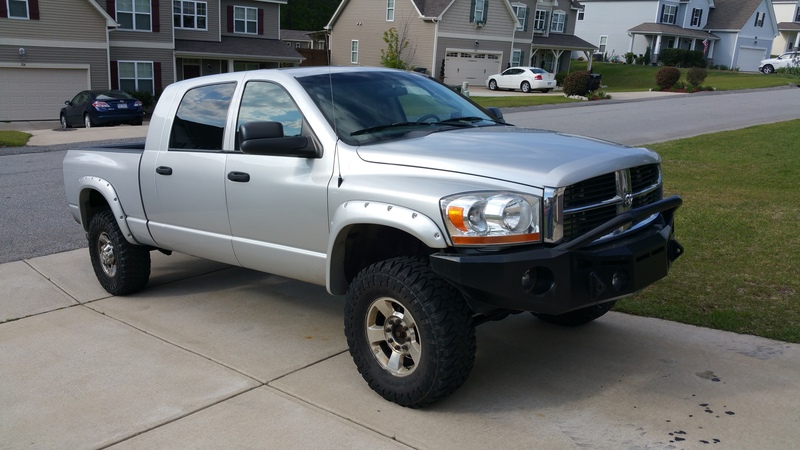

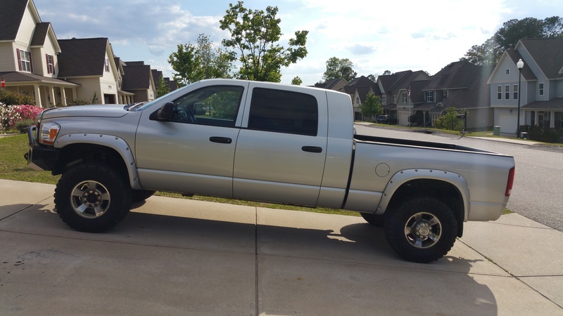

I am in the Army stationed in North Carolina and hit 20 years this past February and going strong still. I have been on the forum for a couple years doing as much reading as I am planning my expedition build. I was originally going to build my 2000 WJ, however I decided to change direction. I been looking at the Dodge ram and I am a member on Dodge Truck Xtreme. I have seen the potential of the Dodge Ram 2500 and 3500 SRW and decided to go that route. I am a scuba diver and on the county public safety dive team and an EMT and the extra cargo room is great for all my equipment is great. We have 2 kids do a lot as a family, road trips, camping, and fishing, etc. So I wanted something with more room for the kids and cargo space as well.
I got my 2006 Dodge Ram Mega Cab in February from Northern Alberta Canada and after talking to the wife the build sort of changed again from an exploration build. After reading threads going back a couple years in this forum and seeing the incredible rigs y'all have or are build has inspired me to do my build. I am building the truck to be able to do 45-50+ MPH down any bumpy dirt/fire road I am on, to crawling over rocky trails like you find in Moab UT, Uwharrie NC.
Here is my truck's current info and future mods and pictures.

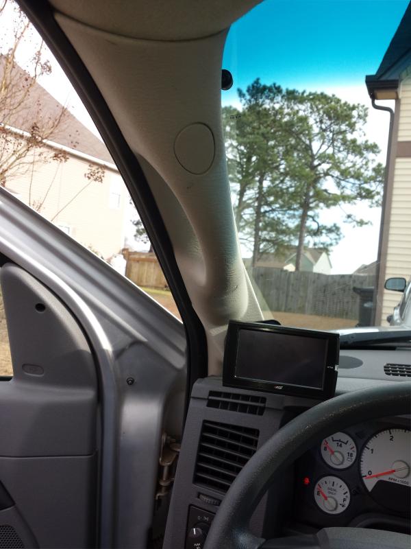

Added an Edge CST Evolution for gauges and a little extra power till I get my EFILive.

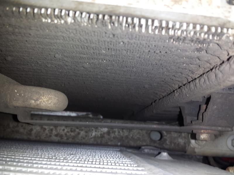

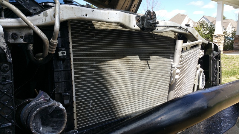

I was having some engine temperature issues and I found out my radiator was a little dirty.
ai19.photobucket.com_albums_b194_AQHACowboy_2006_203500_20Mega_20Cab_20150304_204612_zpsxfcadwdg.jpg
So I got a couple cans of Gunk Gel and sprayed it down then took the pressure washer to it. I was careful not to bend any of the fins.

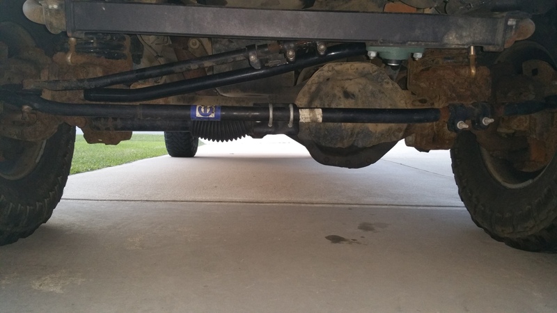

Added a Synergy steering brace and Thuren track bar.

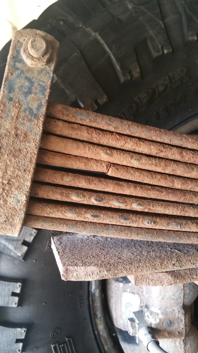

Was taking some measurements for my on board air system and I found this. New spring will be ordered in the next few months.

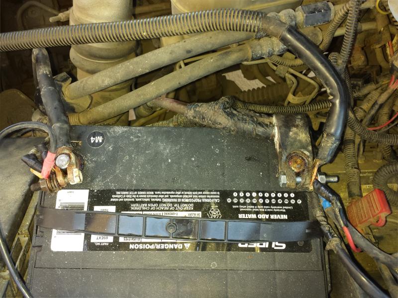

Have some wiring issues that the previous left me with.
ai19.photobucket.com_albums_b194_AQHACowboy_2006_203500_20Mega_20Cab_20150215_110716_zpsgq2r4php.jpg

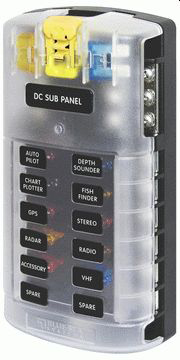

Already have a ST Blade Fuse Block - 12 Circuits with Negative Bus and Cover to put in the truck.

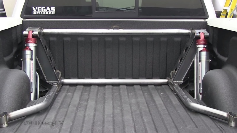

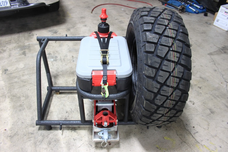

So I am planning on going with long travel leafs in the rear with a bed cage and removable tire carrier that mounts to the bed cage.
Here is one of the ideas for a bed cage.
ai19.photobucket.com_albums_b194_AQHACowboy_2006_203500_20Mega7f9a7e765042805aa65e4ecb2457aab9.jpg
Here is the idea for the tire carrier to mount between the bars of the bed cage.
ai19.photobucket.com_albums_b194_AQHACowboy_2006_203500_20Mega6114bdf5508af2936ec82debd8390e71.jpg
I am up in the air between a 37" or 38.5" tire, I have some time to figure it out while I am deployed overseas.

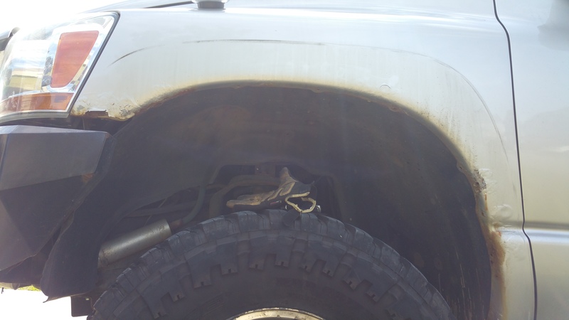

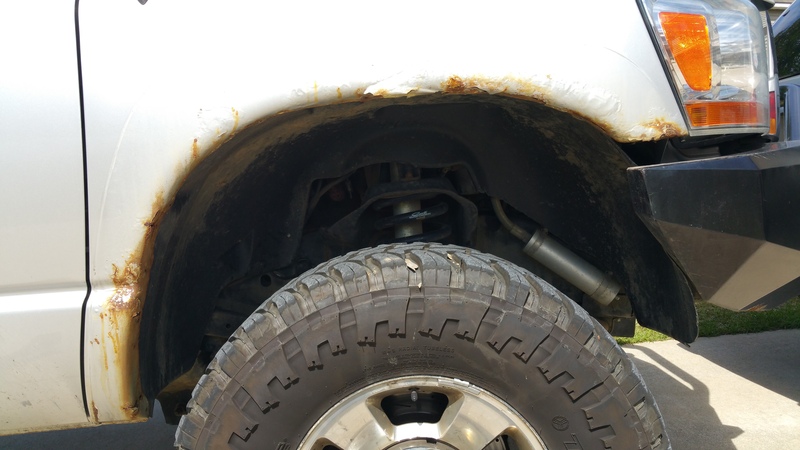

Well it looks like I will be buying new front fenders when I get back from deployment.
ai19.photobucket.com_albums_b194_AQHACowboy_2006_203500_20Mega14566b68db5fe28450d47f85d4bc4f4c.jpg
ai19.photobucket.com_albums_b194_AQHACowboy_2006_203500_20Mega9a047ccd2c5dc000e82bbf4fd3088d6b.jpg
Good looking truck. That's one of the main reasons I hate fender flares. How's the bed? There's been a lot of 3rd gen beds rusting out around here in the past few years.
Well the truck spent 9 years in Northern Alberta till I got it. The passenger side is brand new, I have not pulled the driver side yet. I will be pulling the driver side flare this weekend before I rewire my stereo.

Blue Sea ST Blade Fuse Block

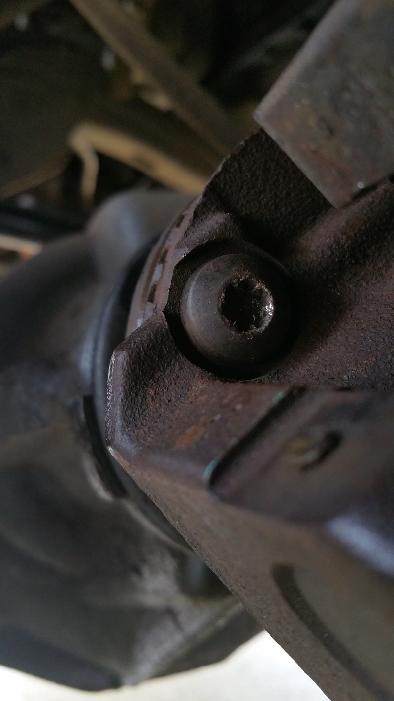

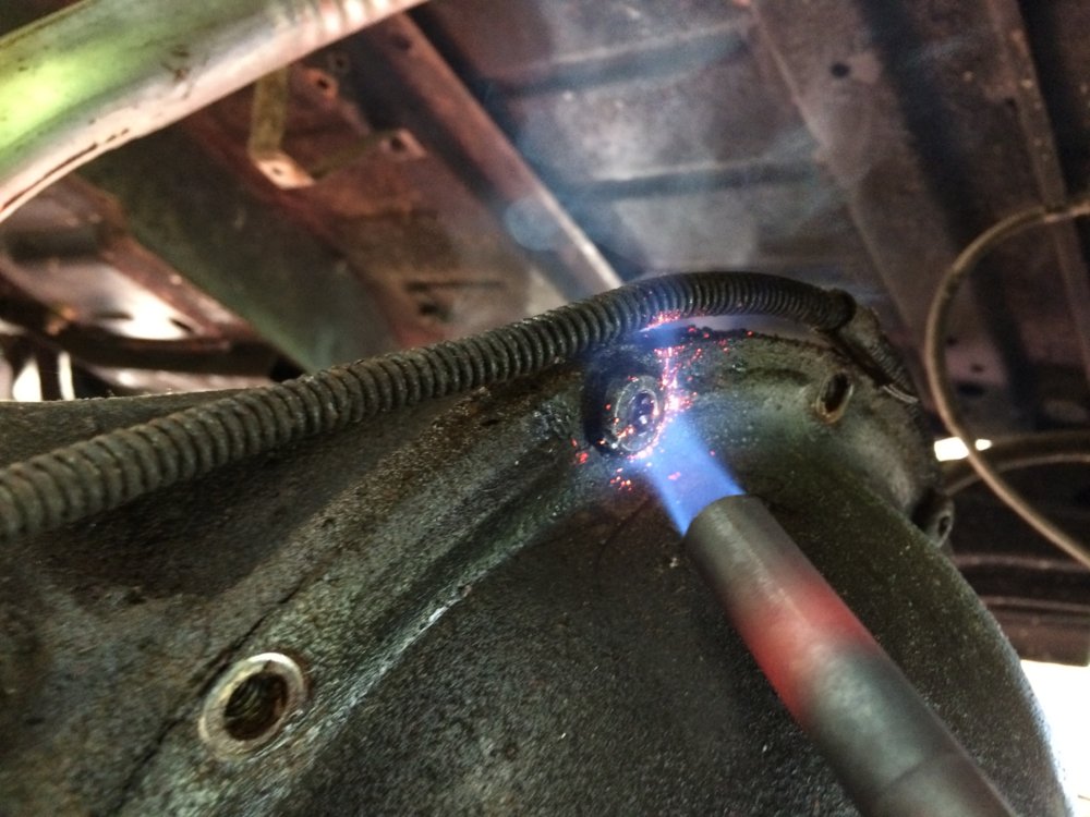

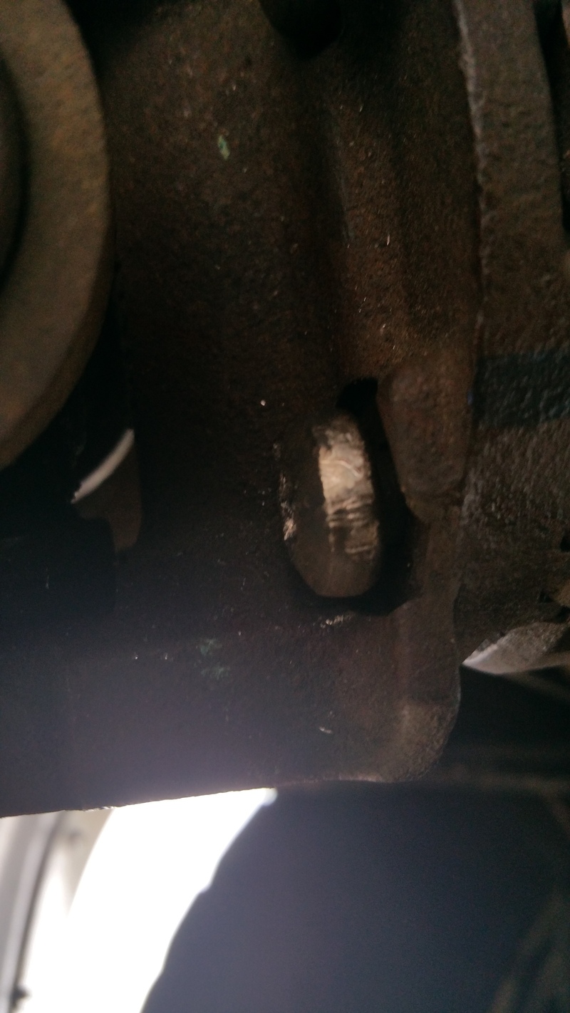

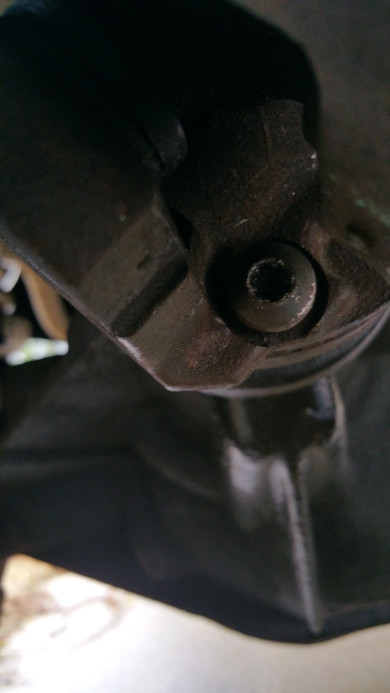

So here is my problem and you can see from the pictures 2 of the torx are pretty messed up.
ai19.photobucket.com_albums_b194_AQHACowboy_2006_203500_20Mega7d15267902fddfb6ebbc8613d908203a.jpg
ai19.photobucket.com_albums_b194_AQHACowboy_2006_203500_20Megab6fe22ba92b9ab66a4c3d4882567586f.jpg
Also you can see one of the stripped out bolts is not all the way in.
ai19.photobucket.com_albums_b194_AQHACowboy_2006_203500_20Mega84979c5bba4e94eebfbf6a63b94728a2.jpg

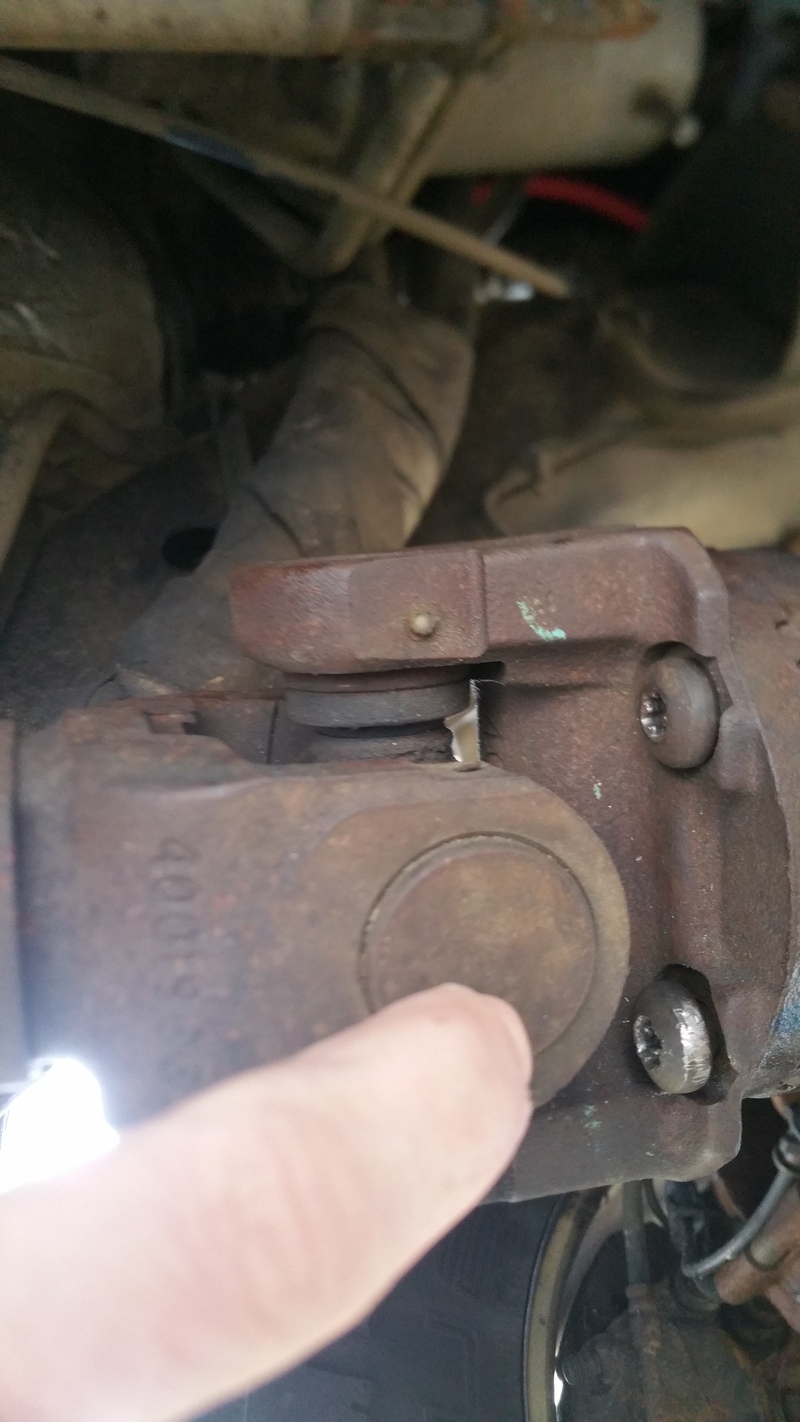

I am wondering if I can use a press like a ball joint press to push the u-joint out and if so which side of the u-joint do I press at.
The one that is on the flange?
ai19.photobucket.com_albums_b194_AQHACowboy_2006_203500_20Mega2e0fcb468ccdd7852aeb9ee06e698c0d.jpg
Or the one that is on the drive shaft?
ai19.photobucket.com_albums_b194_AQHACowboy_2006_203500_20Megaa37b27985e620cb4856cce948b9901f4.jpg
I am thinking the one on the flange so the shaft can move as the u-joint it pressed out.
Also found that who ever pulled the shaft never lined the index lines up so I was getting a front drive shaft vibration. Also with the one bolt missing and the other not all the way seated is another cause of the vibration.
Any help would be great.

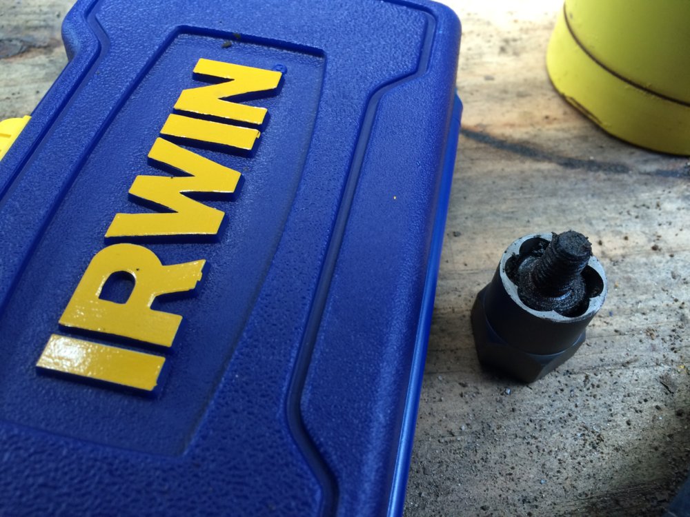

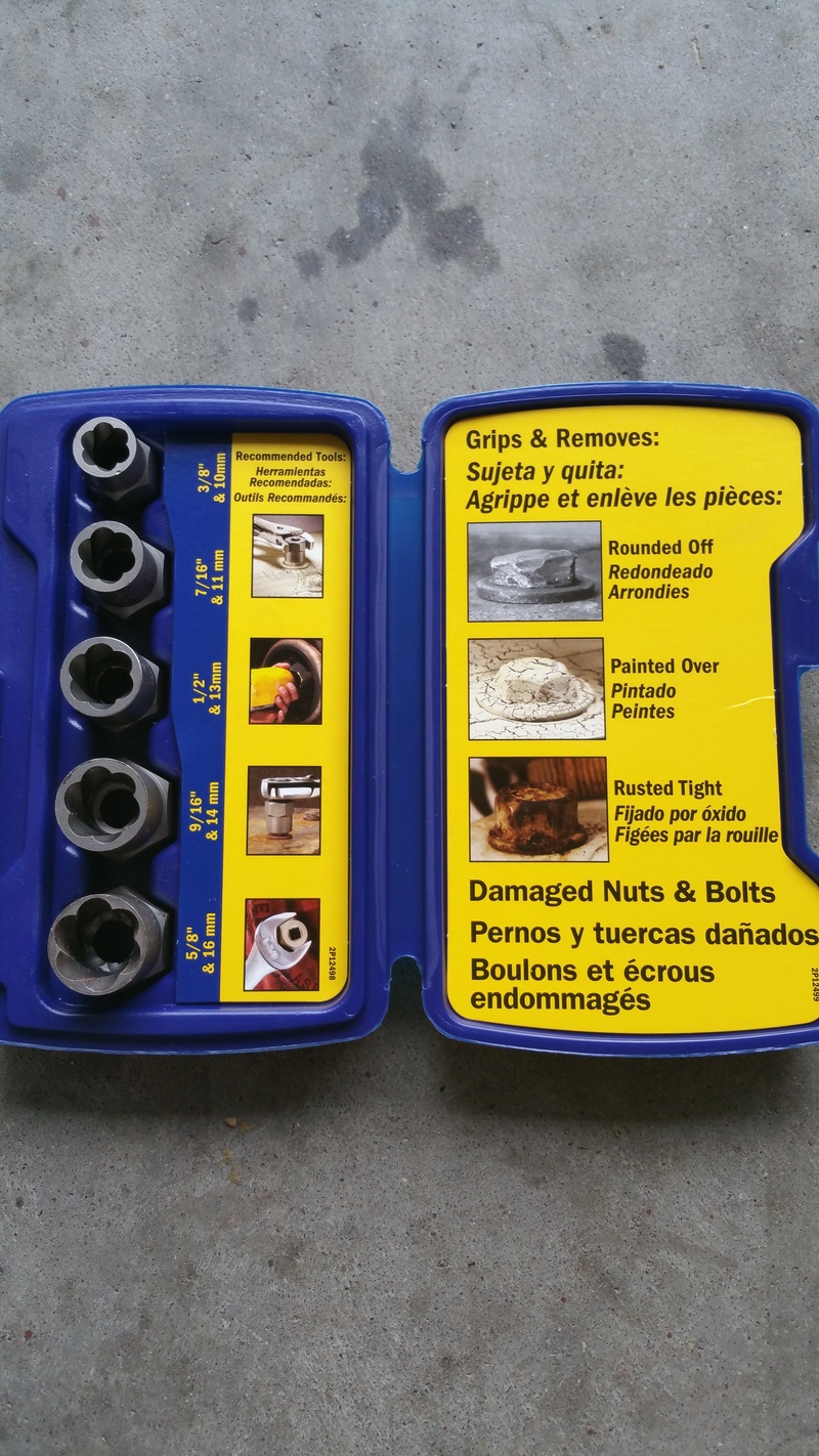

Here's my stripped torx bolt removal kit.
I'm not sure if you can get an easy out in there, but they have worked wonders for me.

Where did you get that Irwin kit from?
Even if it does not work on the front flange bolts I can use that on other stuff :rockon:
Cool thanks.

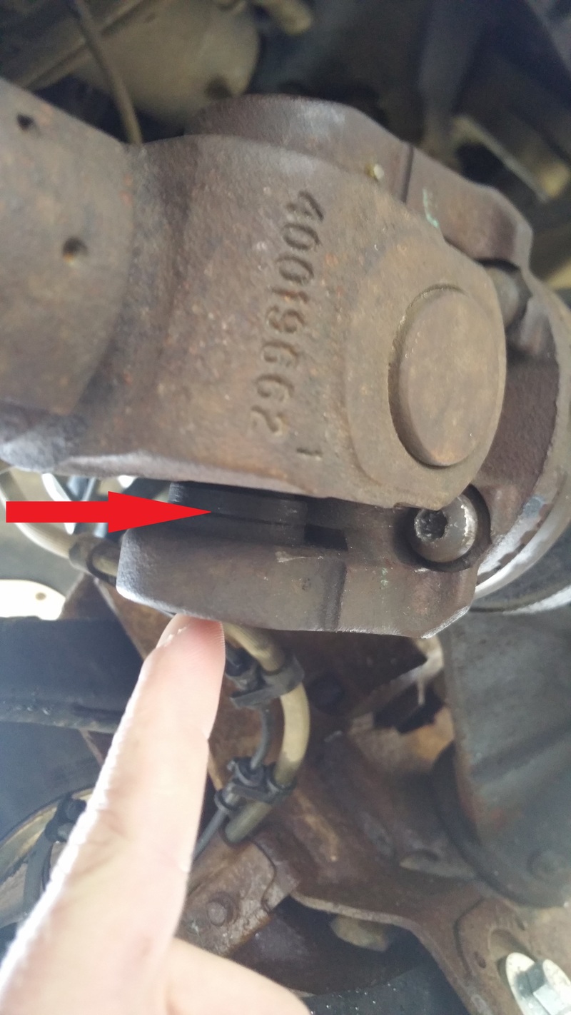

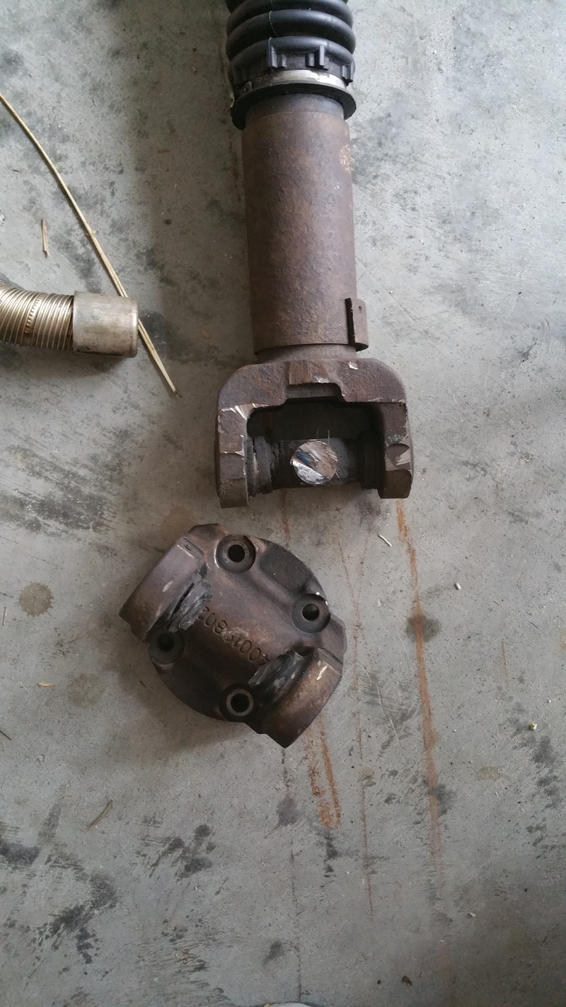

I think I will still need to cut the ujoint out where the red arrows are so I can have more room to get to the bolt heads.
ai19.photobucket.com_albums_b194_AQHACowboy_2006_203500_20Mega8ffc827b0fec9346491cbc336ed2e2f7.jpg
ai19.photobucket.com_albums_b194_AQHACowboy_2006_203500_20Megab8f0fcd388e9467e30be6f0ac8d5cc3e.jpg
You will have to apply heat to the yokes to back the factory nylon out that holds the caps in. The factory joints dont have C-clips.
Frank thank you for the help.

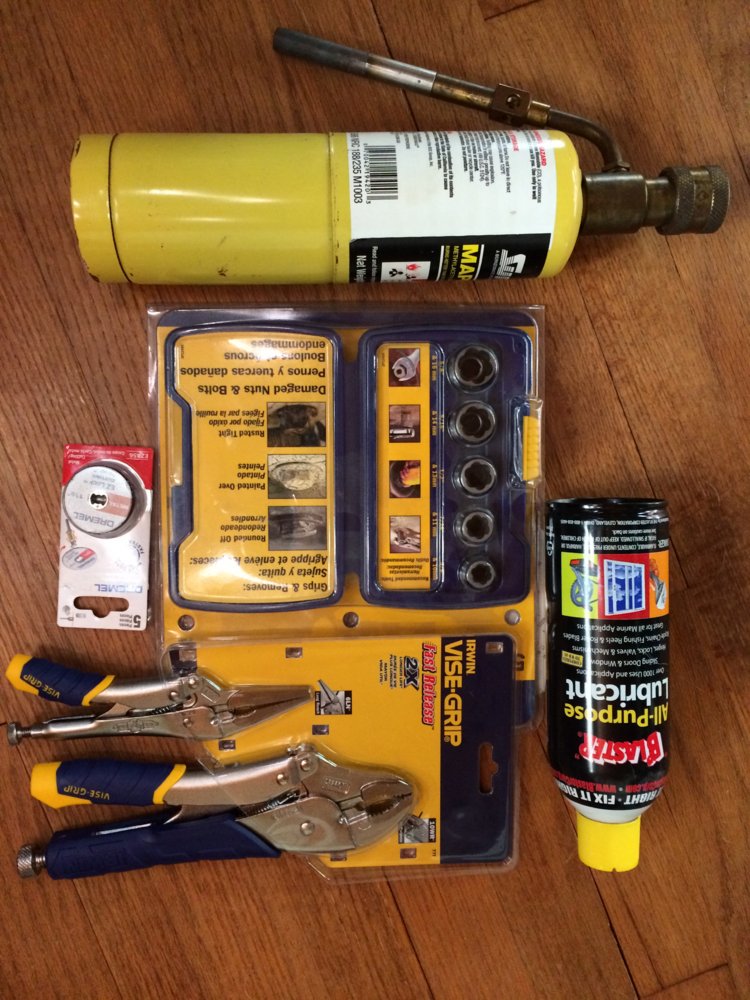

I got the drive shaft off and it only took 2 hours. Used a grinder, Hand held torch, Irwin Bolt Grip bolt head extractor and they were the best $20 I spent.
ai19.photobucket.com_albums_b194_AQHACowboy_2006_203500_20Megab3f6a8d346693c209b10fc0175374e85.jpg
Here is a picture of the Irwin Bolt Grips. Got them at Lowes.
ai19.photobucket.com_albums_b194_AQHACowboy_2006_203500_20Megae58c09c87faf241c8a6ccb4a6448c68a.jpg
