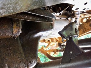

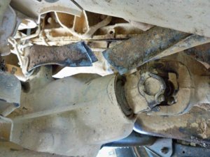

green cherokee- busted front windshield, broke both upper control arms causing oil filter to bust = no oil pressure for half the race thanks amsoil, busted rear taillight, still came in 1st, this was the toughest vehicle I ever owned, went out like a champ
silver cherokee- busted radiator support and radiator
That sounds awesome. Maybe one day I can run that race.
Dang I watched youre ride and you was a flyin, truly never let up congrats, did the motor lock

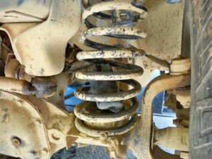

not so far, I went back to race camp and took the filter off, turns out it had dented the lip and caused the gasket to come out of place, I bent it back put the gasket back in, it fired back up with good o/p, but I didn't run it too long. It started to loose power on the back half of the track and by the last hill it was close to lockin up. I have no idea how the front in stayed under the jeep with both uppers broke
The axle will only roll back so far until the coil perches hit the lower control arms, and the track bar helps out a little as well as the shocks. I've broke both my uppers out crawling before and didn't know it until I got back to the trailer at the end of the day.
