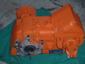

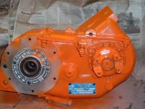

here are some pics of the bracket from ORD... i still havent put the 205 in yet.... :rolleyes:

oh yea, i keep forgetting there is a difference between our stuff. of course our tcases are swapped but the bracket could look the same, just reversed. also thats for the triple stick but since the third stick goes to the 203 i dont think that would change the bracket any. im not sure why there are two holes drilled in the bracket i guess for the different rotations of the tcases they offer. also note the little section of pipe with a piece of metal welded to it on the longer shift rail.

so how does that bracket work? it looks like it mounts to the rear output shaft, but then how could the front range rail pivot off of that? maybe i just need to see it in person. could i come by tomorrow at like 10 or 11am? you live near broughton right?
Because you can't reach the rear shift rail around the 203... so you need a lever arm to move the shifter outboard. The lever pivots off a mount bolted to the front output. The shifter attaches in the middle.
The shifters I built for my truck are similar, for the same reason. I originally thought I could build a shifter that sleeved over the front shift rail, but I got too much parasitic movement, so I came up with the lever idea. It looks like somebody else thought the same thing. ;)
