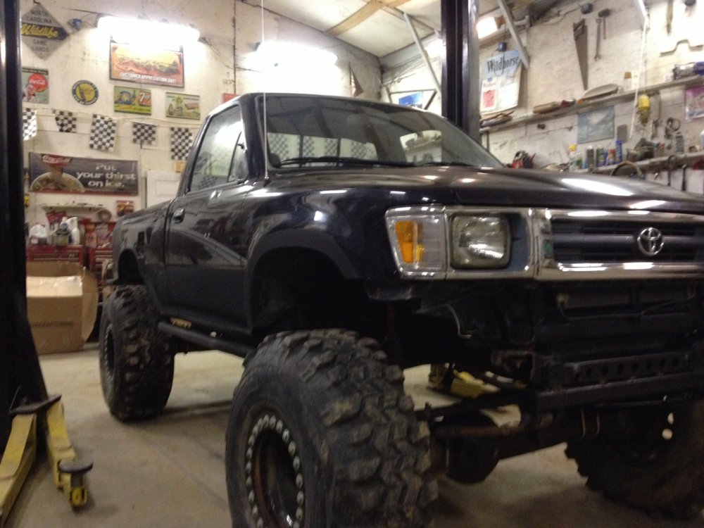

Cold start injectors working others are not
I know ecu is good and mass air flow wht else would cause it
1994 model
No help here just wanted to say that is a really sharp looking truck.
