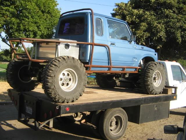

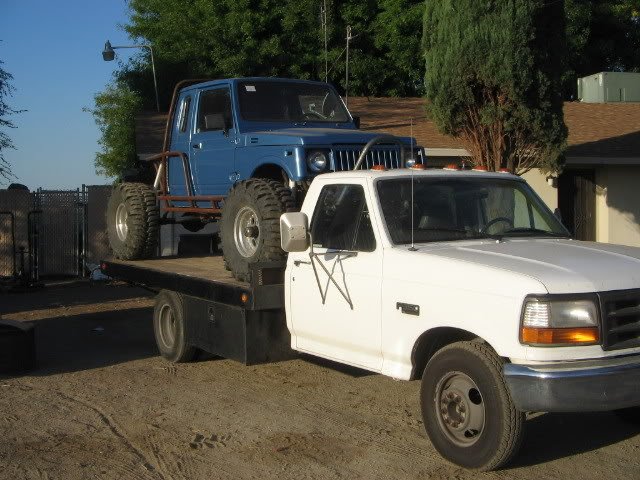

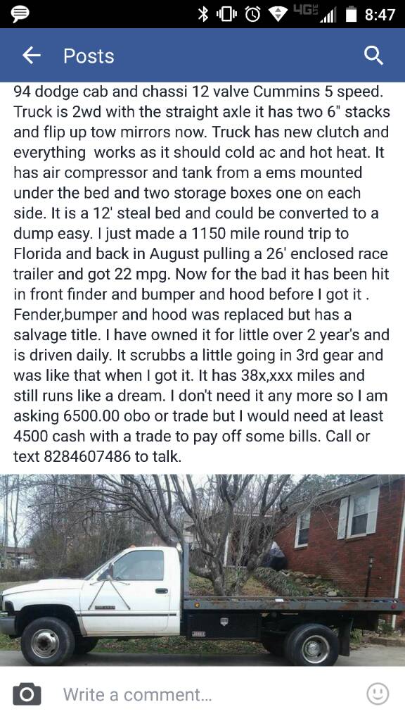

Oh, and side note, found this a few weeks back during my hunt (not for sale, just web surfing). I ended up stepping up my search for a 1 ton flatbed which was ranging anywhere from $2.5k - $5k. but most of them were in rough condition and high miles. I do think it would still be a great idea, quick load time, and smooth ride, but just not in the cards for myself.
But just for fun, here's some photos, I am sure some of you have seen this before....
