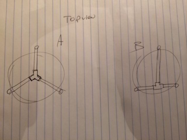

I have an alternate plan if I can find this. I can go with a "T" and have 1 long pipe and 2 short ones. I'm making plans for a brewing stand and want to hold my brew kettle at 3 points Instead of Option A I can do Option B.

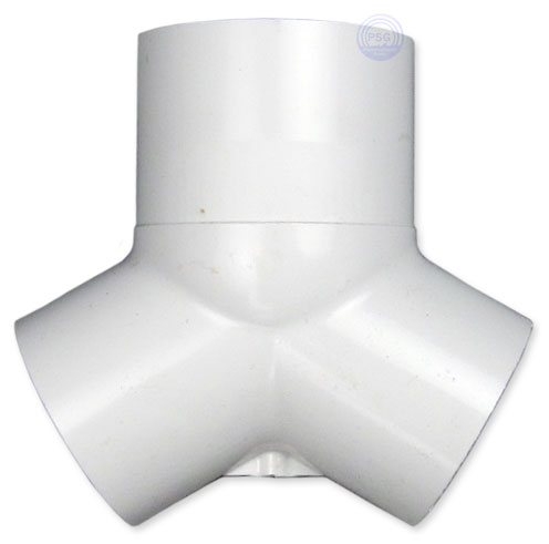

It is called a True Wye fitting and are readily available in multiple materials and connection type.

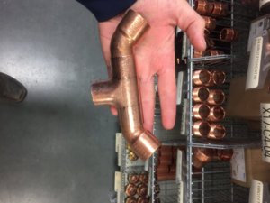

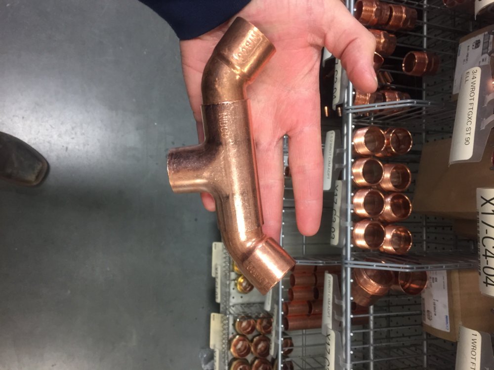

get a Tee and 2 - 45 degree steet elbows....
I just stuck this together real quick. It's not quite got the 120 degrees of separation, but close.
From a search, that's the one I'm looking for.
That'll work too.
