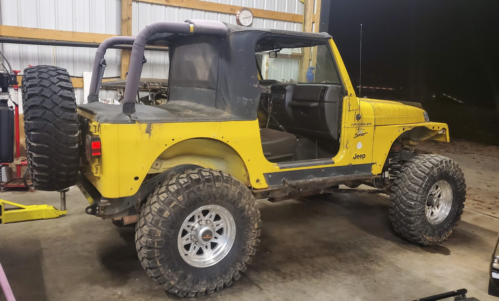

I ran a 35" MT on the rear of my jeep for years, then a 36" Irok, then a 38" TSL SX on heavy ass recentered Hummer double beadlock with rubber runflat (the combo weighed about 170lbs), then a 38.5 Creepy, and currently a 37" creepy. There was a period of time (maybe 1-2 years) where I had an aftermarket bumper with tire carrier, but the majority of the 20+ years it was on the stock tailgate, and I'm still using the stock tailgate and the stock mount. It does have a 2" aluminum spacer to accommodate the wider tires. I kept the rubber bumpers to prevent the tire from shaking constantly, and I have welded the top bend in the sheet metal of the stock carrier where it started to crack (like 15-20 years ago). But I see no reason to spend money on anything else.

Pic for interest.
Also, it doesn't quite touch the rubber bumpers. But the factory gate is more stable than the bumper/tire carrier I had on there. That thing was always rocking and vibrating, even though it was tight at the hinge and latch.

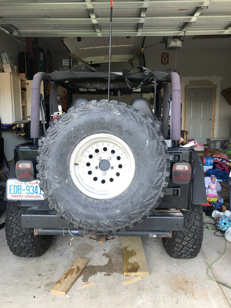

That's what I've got right now. If you have the stock bumper you need to have the angle tire mount also. There also isn't a stabilizer for the tire. 35x12.50 wiggles a little bit but nothing bad and no noise. I'll try and get some better pictures when I get home.
We are gonna be running some JK rims on it so I’ll have an adapter on the spare tire carrier to accept that bolt pattern, would I still need that angle mount?
The tire hangs down too low and may hit the bumper, especially if you're trying to tuck it in tight so it touches the rubber snubbers on the tailgate. Might could redrill or modify the carrier to raise the tire up. One of ours hits the bumper even though it has a spacer on the carrier and a body lift.

Not sure I thought about making a notch in the stock bumper to make it work. Ideally I'd like to take off the angle and put the stock mount back on with the large hinge.
