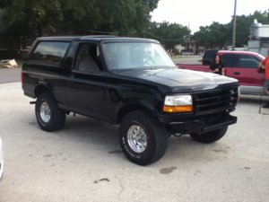

Hey NC4x4 group. New to the site and need some advice. Long story made short...I have to pull the motor in my '95 Bronco. I am replacing the water pump, timing case cover (b/c it broke) oil pan gasket, rear main seal and headers (again, bad leak and small crack...will use in project later), radiator, thermastat and some hoses. Summitracing sent the wrong parts, so I will have a bout a week with it out. I planned on replacing the motor with a stroker next August, so I'm not ready to drop serious money in it right now. So, my questions is/are...
1. What small things can I do to the motor buy me time and reliability till next year?
2. If I take the heads off to have them freshened up, what should I expect to pay for it?
If so, recommedations for someone in the WF/Raleigh area would be appreciated.
351W with 109k
stock everything
P/O said transmission was rebuilt, but I highly question that b/c the pan leaked like a siv (replacing this ,too)
Thanks in advance

Looks like you're already doing all the stuff that's a PITA to do with it in the chassis. Make sure you get the single piece pan gasket with the metal inserts at the bolt holes. I might pull the lower intake and clean and reseal it, too.
I wouldn't pull the heads unless you find evidence of a burned valve or something. There's really no good that can come from it without spending a bunch of money first. The stock ECM won't tolerate a lot of changes.
Do a search on Full Size Bronco for the six liter tuneup...and for the heads, to be reconditioned to stock you're probably looking at 3-4 bills.

Oil pan gasket? Yes, did that. Good advice on the heads.....was REALLY not wanting to tackle them, to be honest.
