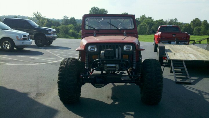

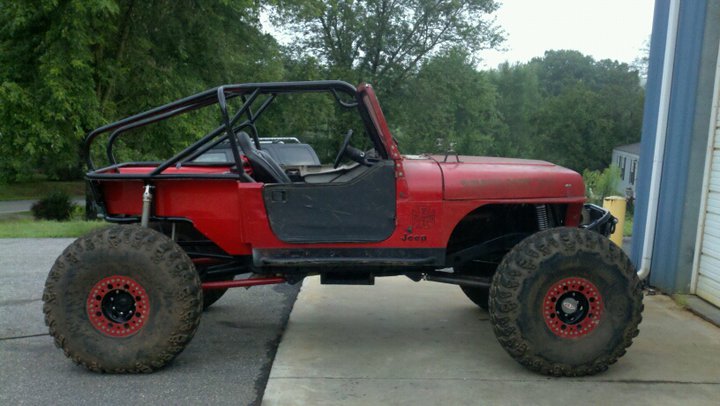

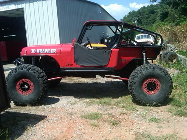

finished last week just in time for the toy run.

ori called and they are sending the other 2 struts out this week so i can have my air shocks back. well set up the final ride and it will be done.

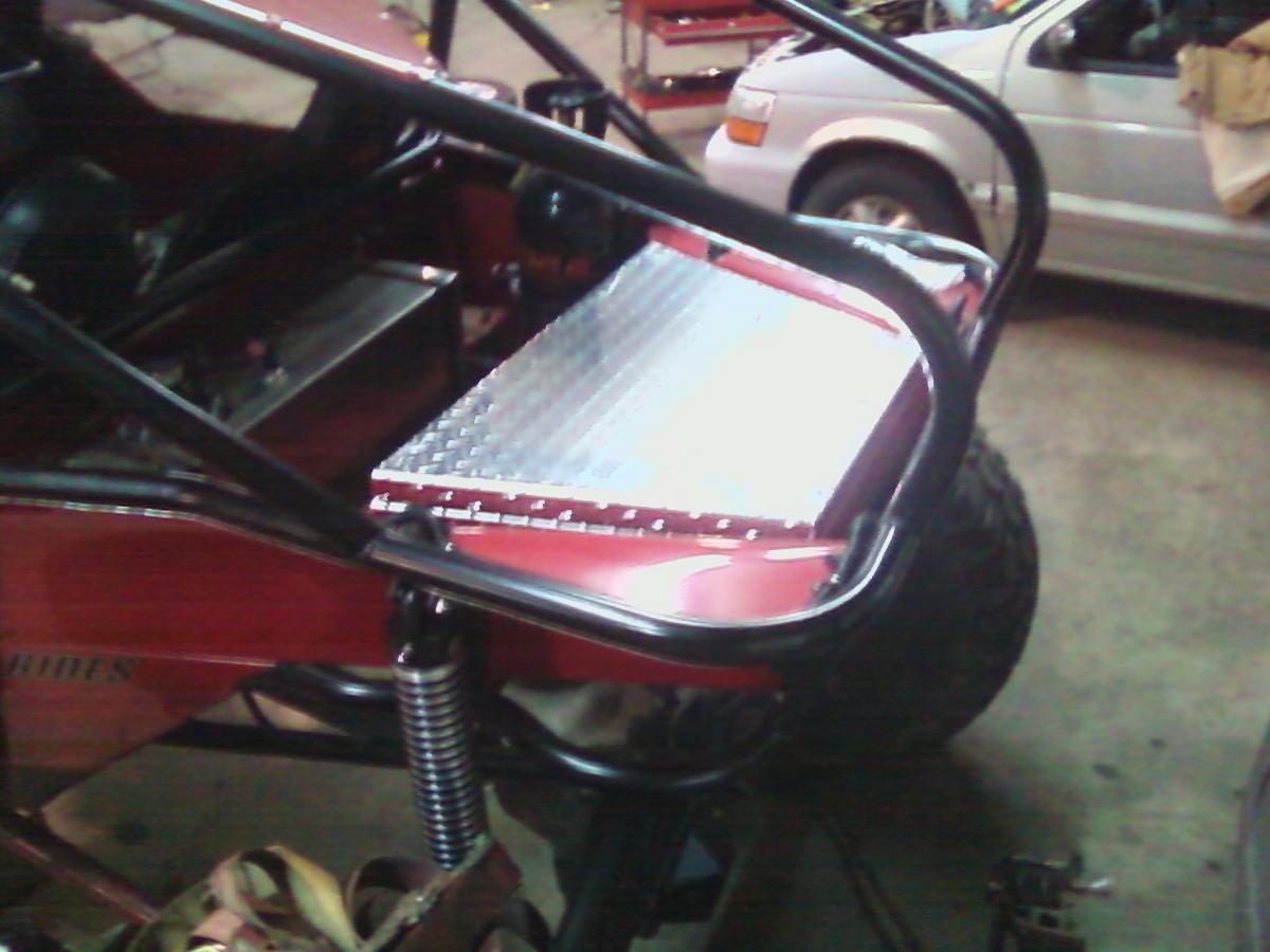

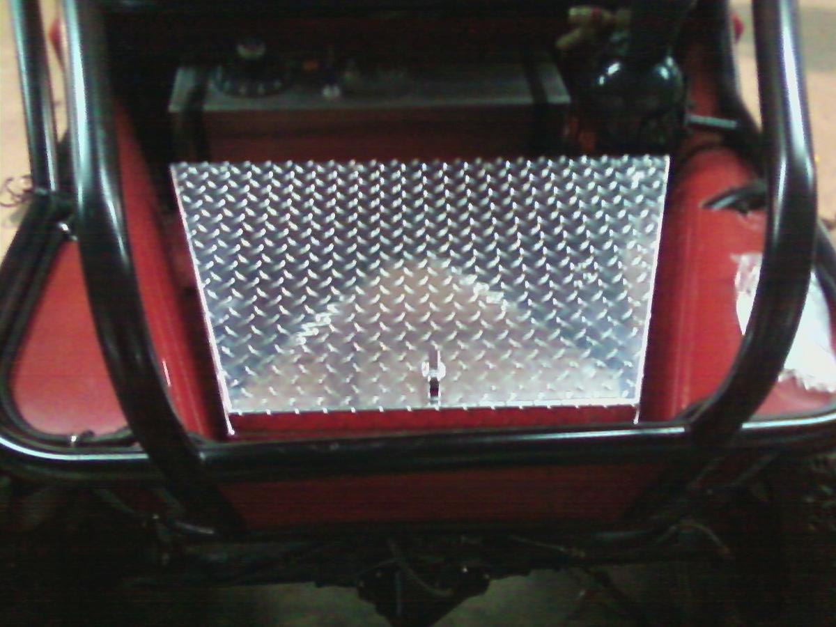

Was at Davids shop today and noticed some new Bling. Thought I would share.
Built by WARRIORWELDING. This box is custom made to fit the back of 3D Krawler.
It honestly looks better than the store bought boxes. No rattle, sealed, and it fits!
Great work Drew

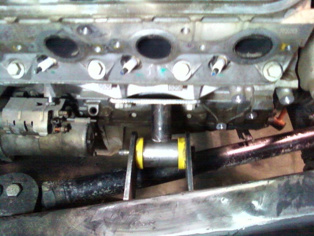

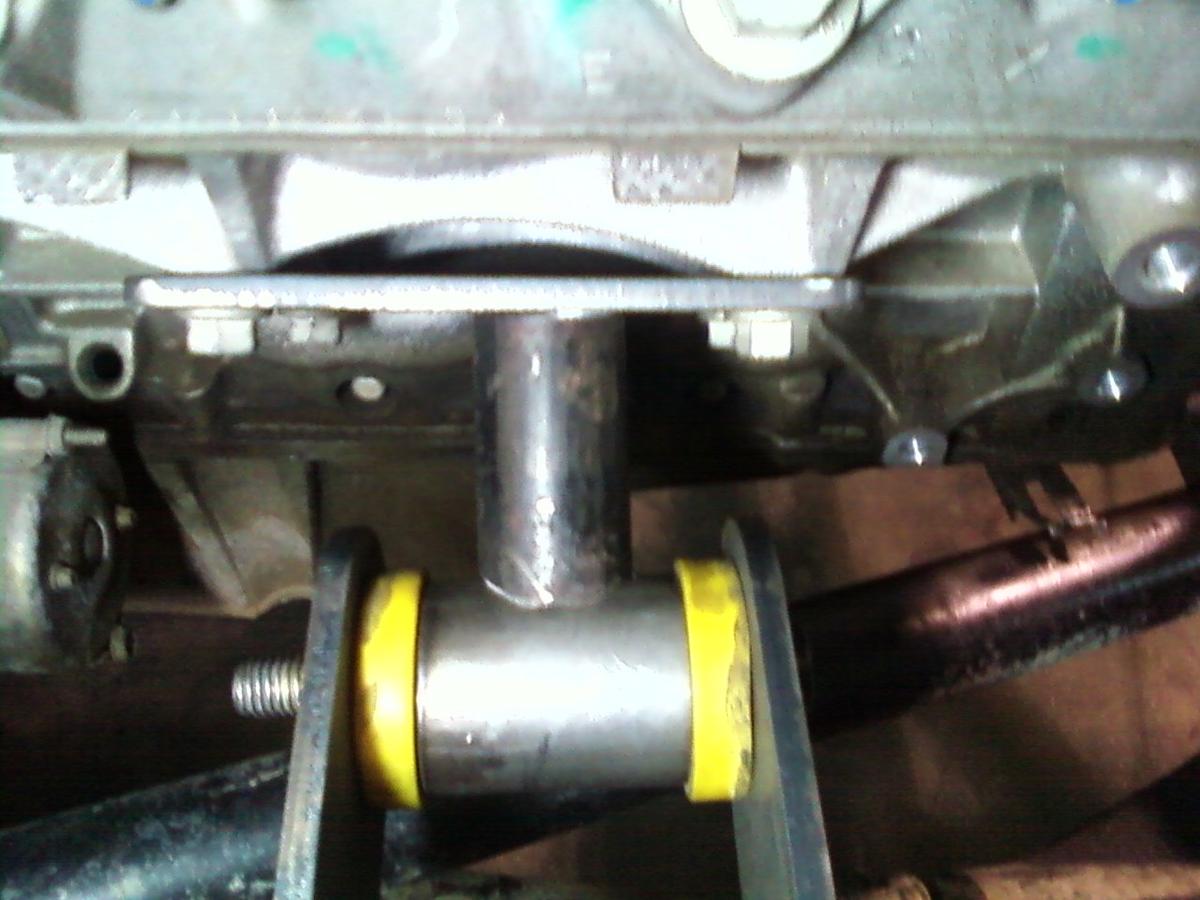

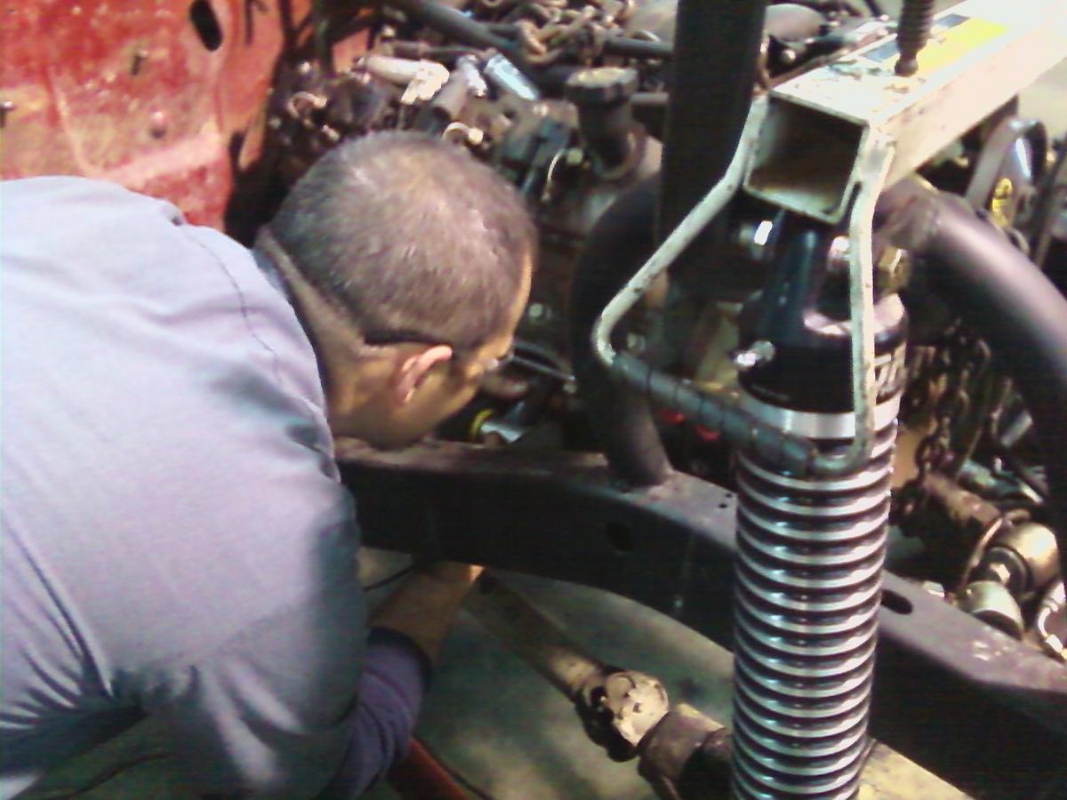

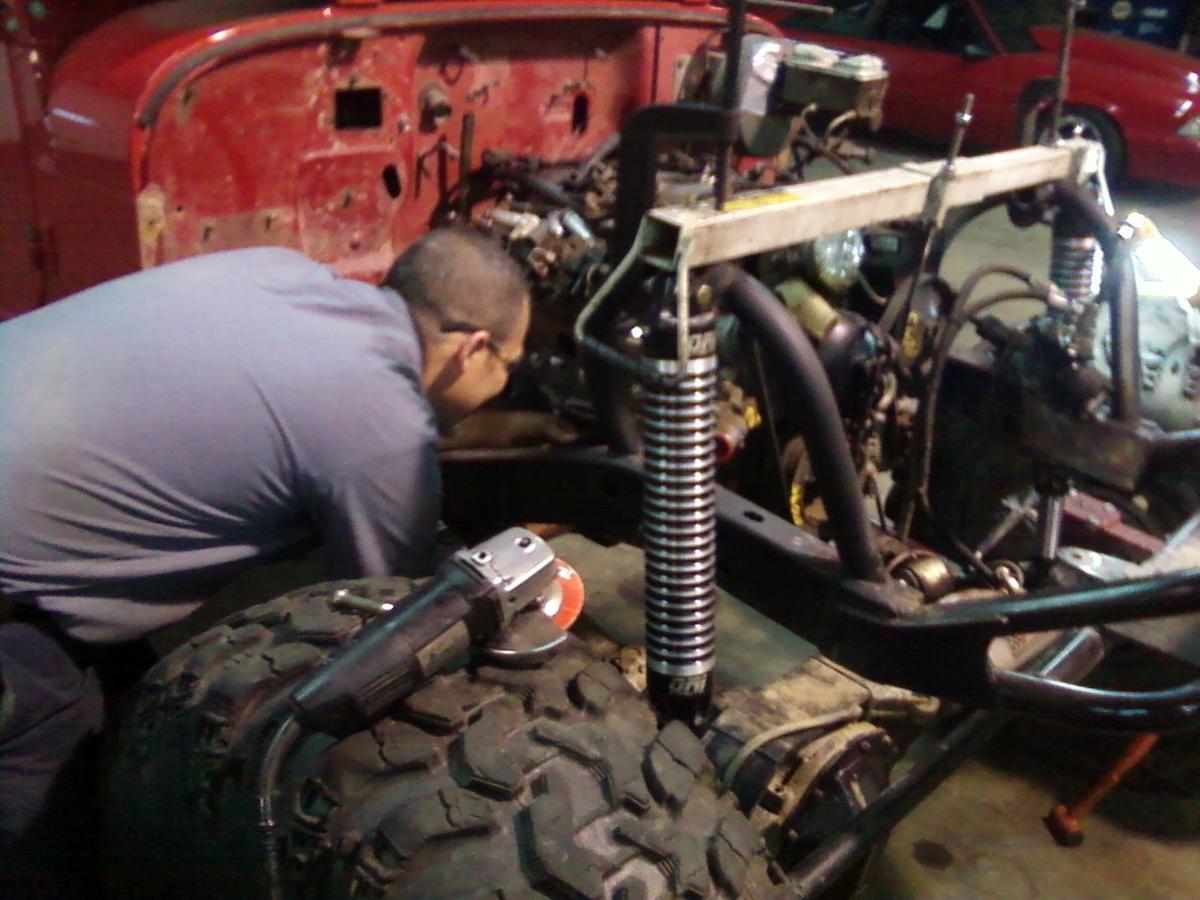

We worked most of the day Saturday making engine mounts. Engine in, engine out, engine in, engine out. ...you get the picture.
Here is a little of what we done. Sorry for the crappy cell phone pics. All I had with me.
We did get them welded up and painted, just not re-installed

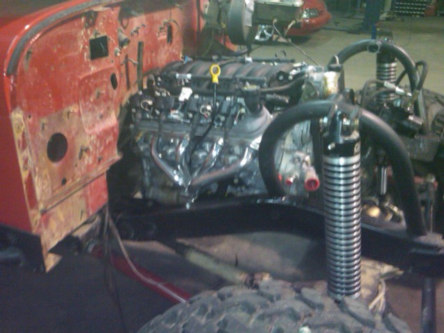

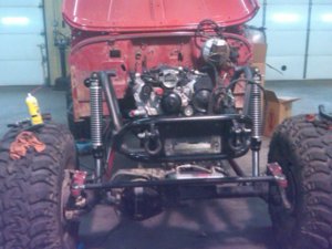

I didn't mention about the engine change. David pulled his 350tbi, that is going into my Jeep, and replacing it with an LS1 5.7..twice the power!

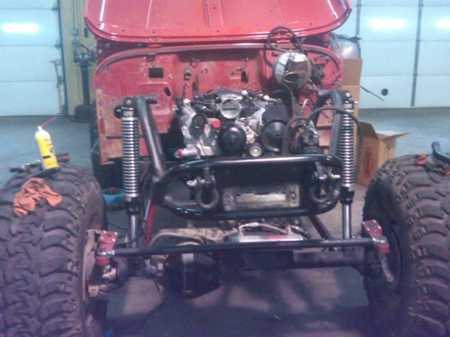

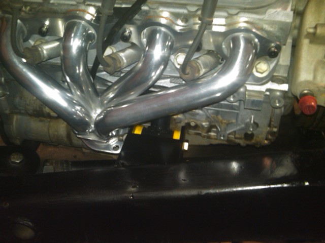

Got the engine in today and mounted. After checking clearances at full bump the LS is a inch or so wider than a SBC so moving the upper links out on the front diff and a alternator relocation is a must. The Sanderson block hugger headers fit great and should give plenty of room for exhaust routing.

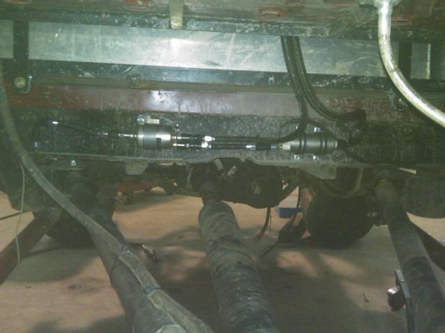

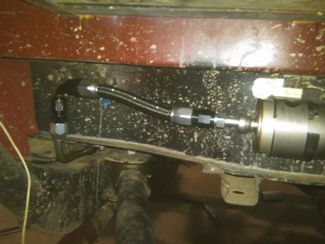

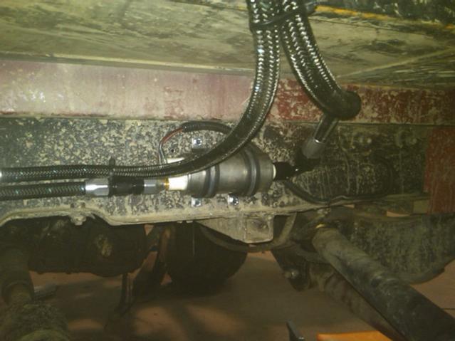

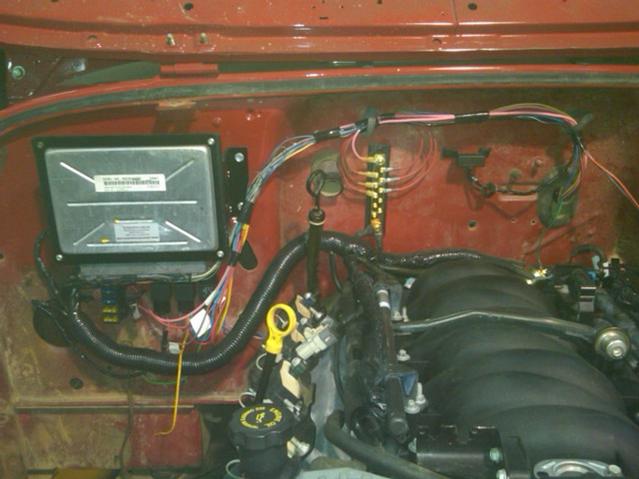

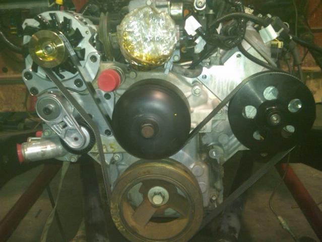

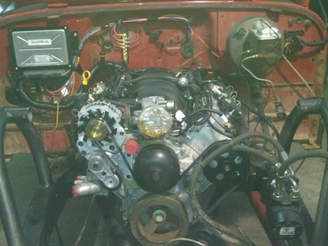

Few updated pics, ECM installed and wired..all relays for ECM, Fuel Pump, Cooling fan, Starter wired and the fuel system is complete.
