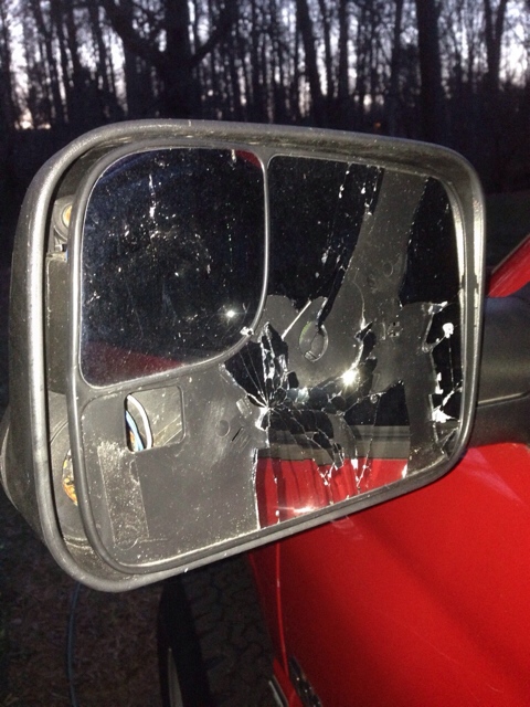

Does anyone know if you can buy just the mirror piece to a 3rd gen dodge power flip up mirror? Or am I going to have to buy the whole mirror? Anyone selling a driver side one?
On the way home tonight some one swerved in front of me and I had to swerve and I clipped a sign post and this was the result

Rock Auto sells them. $50-60/side, depending on who made it, whether left or right, etc....
It looks like I also need the backing plate the glass sits on, mine must have some broken clips on the back. I can't seem to find the glass and backing plate, besides rockauto, anyone have any other places to try?
Somebody I was talking to about mirrors bought one from Rock Auto, and they said it vibrated at vehicle speed making the image blurry. Apparently it was noticably lighter/thinner/cheaper than stock. I'm not sure what I am going to do. Mine has been broken for about 2 yrs or more now, but I would like to replace it.

Well just to wrap up this thread; I couldn't seem to find the right piece of glass online so I went to my local auto glass shop and they ordered the right piece and installed it, came to a total of $40, which is cheaper than buying a whole new mirror.
