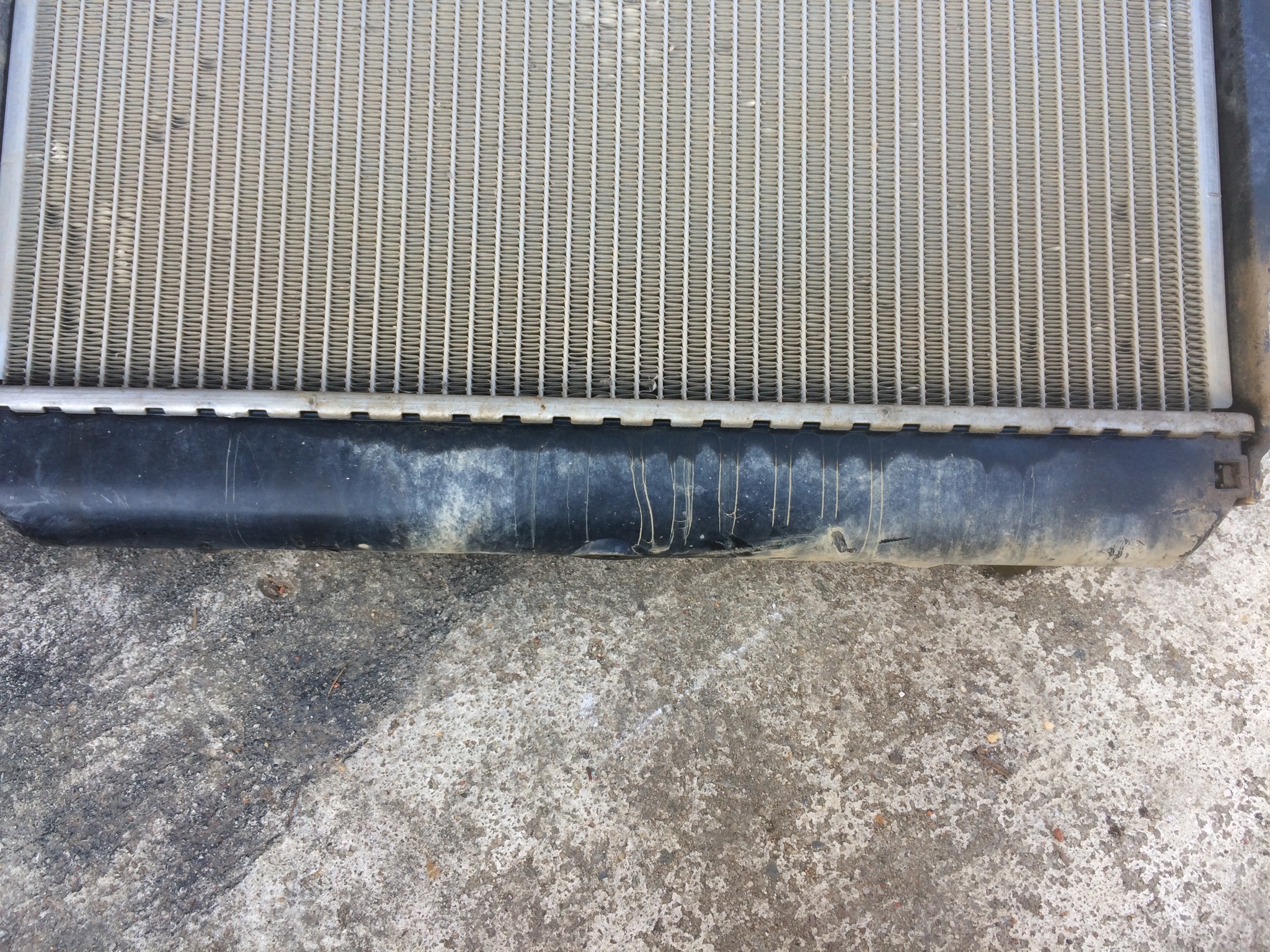

I drove the YJ to Greensboro and back on Friday (45 min each way)
I noticed while going through a drive through on the way back that it was getting really hot.
Once I got back on the road it cooled down, but when I got home, the radiator was spewing coolant out of the bottom.
I had just replaced the radiator, cap, water pump, thermostat, and both temp sensors.

Could be a faulty radiator cap, or the cap doesn't fit properly on the new radiator, so not building cooling system pressure. Or, faulty radiator that is leaking and not building cooling system pressure. Actually, where is the radiator leaking from, and do you support it split from overpressure?

Now about that radiator, its been my experience that the type with plastic tanks crimped to an aluminum center section will fail at some point, and can be really tricky to ever find an exact leak point. They just leak all the way around after a while. That may not be the case with yours being under warranty still, just throwing that out there.

It leaked from the bottom where the aluminum crimps to the plastic.

Autozone radiators are the crappy style, but with a lifetime warranty, it's hard to beat.
They told me they would pay for new coolant too... We'll see.

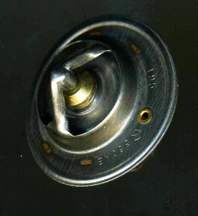

Did the thermostat you replaced or put in have a little weep hole at the top? The difference between a parts store thermostat and a dealer part is that tiny hole at the top. That small weep/breather hole stopped an overheating condition I had in a 99 xj.
It was interesting my current WJ 4.0 which I bought off of a friend had a small hole drilled into the thermostat when I replaced it the other week. I could tell it was not a factory thermostat too. From now on I always remember that if that small hole isn't there that I carefully drill one and sand down anything sharp leftover.
You can see the small weep/breather hole on this dealer t-stat. Most parts stores t-stats don't have that. (sorry the pic is huge)

I drilled it before I installed it. I just want to sure I didn't do something wrong before I have to warranty another radiator. Thanks for all the help guys.
