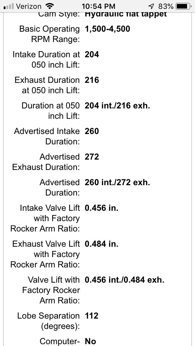

Not sure about other brands comparing to this, but I have a crane 753905 in my stroker. Can look at duration at .050” to easily compare other brand cams to this cam card. Heavily ported head. Can’t remember which injectors I have, whether mustang or dodge v8. No other computer mods other than vacuum line pulled off the fpr to get 46 psi IIRC. Factory yj intank pump with remove corvette tpi filter that doesn’t have return line/fpr built in.
Runs fine with the computer, still good idle signal to map sensor, was told anything more would cause it to load up at idle due to low idle vacuum signal.
Only thing I had to do mechanically to run this cam was to add a shim under the valve spring to bring the spring pressure up to 105 lbs with the valve closed. Replaced springs with new ones to reuse all the stock retainers and keepers.
