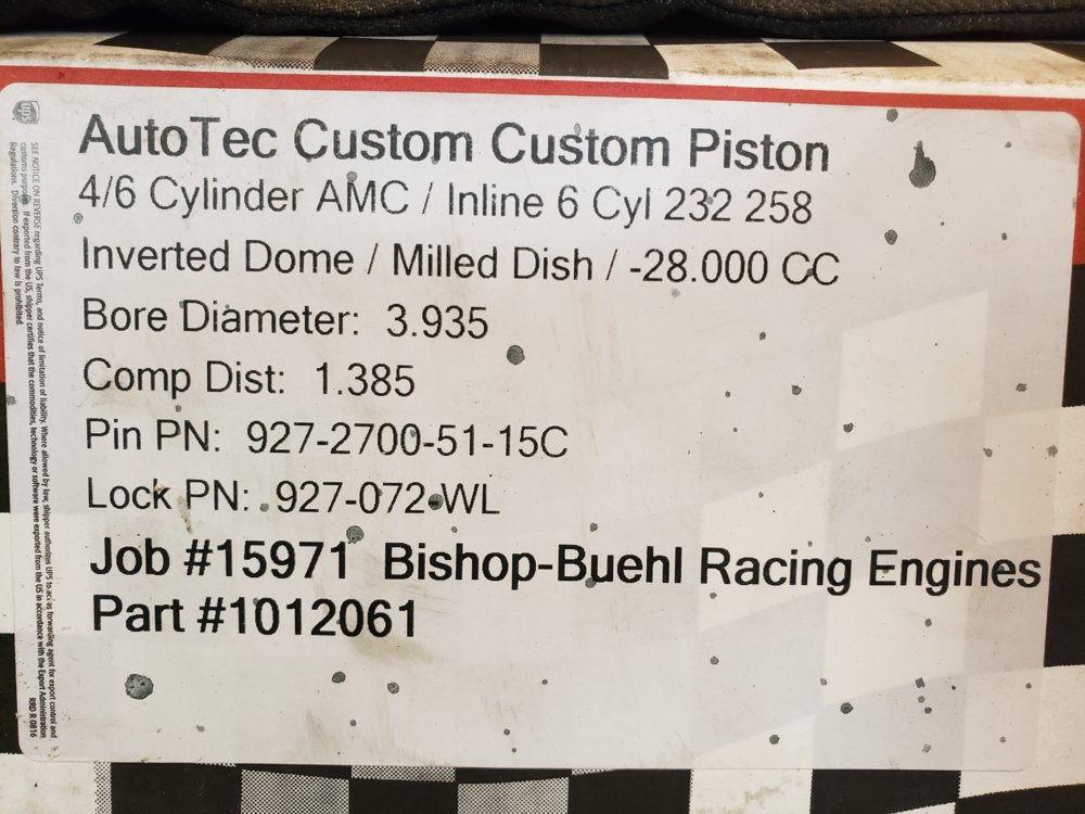

I am at 9.6:1. I'll be running 89 octane. Also floated the pistons on this one. 7120 head at 55cc
60 over
Did you deck the block, or did I fuck up my math?
No, virgin deck. .043 crush gasket. I followed direction of Russ.
Dam, dem is "Custom Custom"! I dont even wanna know how much that mod cost. Probably to match up with the RV cam.
custom grind cam too..
