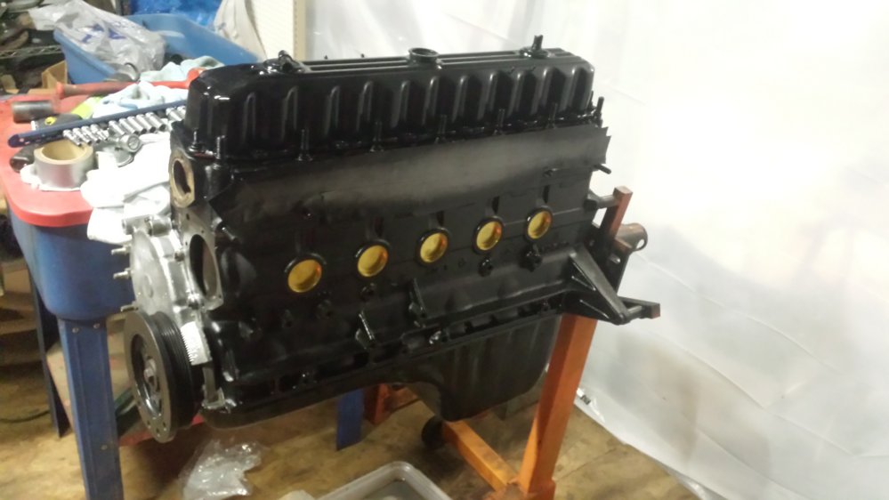

After a conversation with Mr Treadway and looking closer at my main clearances I decided it would be ok. Spent today doing final assembly on the bottom end

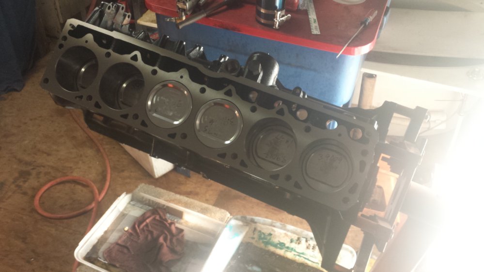

Worked on it some yesterday. Not as much as I would have liked, but wife and kid had other plans for me yesterday afternoon.

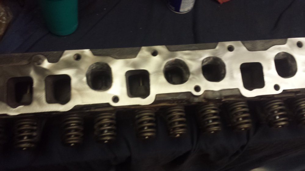

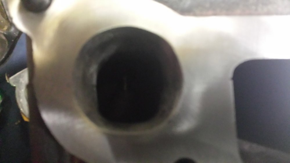

Did get the cam degreed and finished up port port matching the head to the gasket. Exhaust side of the 4.0 head was ridiculously smaller than gasket and header ports. Intake side was left alone as they are pretty close. I could have done alot more porting but got lazy. ..lol. I am not building a race motor, just a reliable torque monster
I do plan to dyno it after it is installed. I have a friend that happens to have a dyno and a bone stock 4.0 cherokee both. We plan to dyno his and my jeep both.

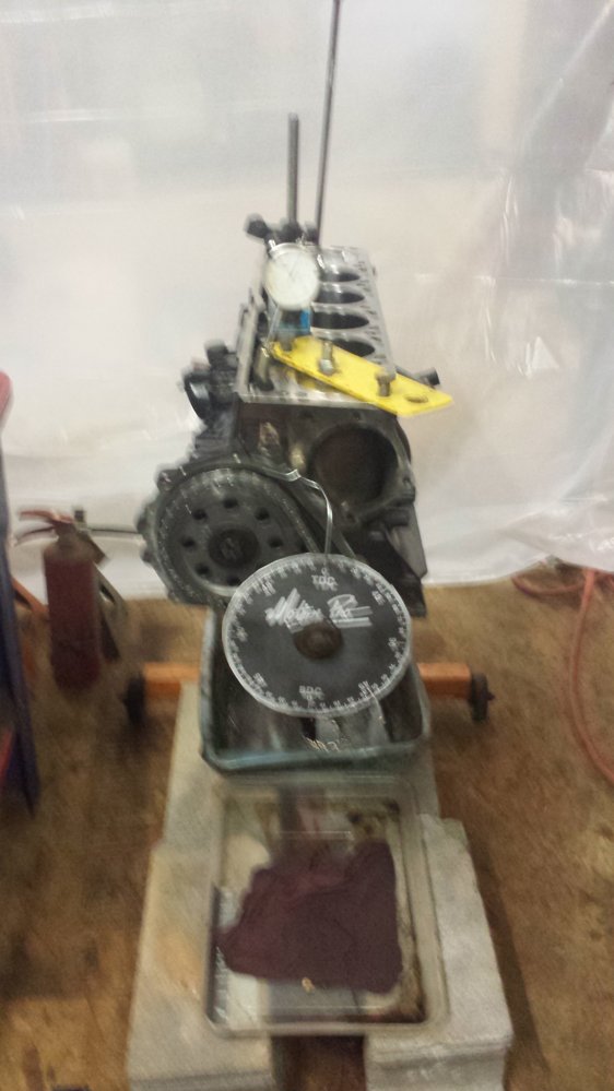

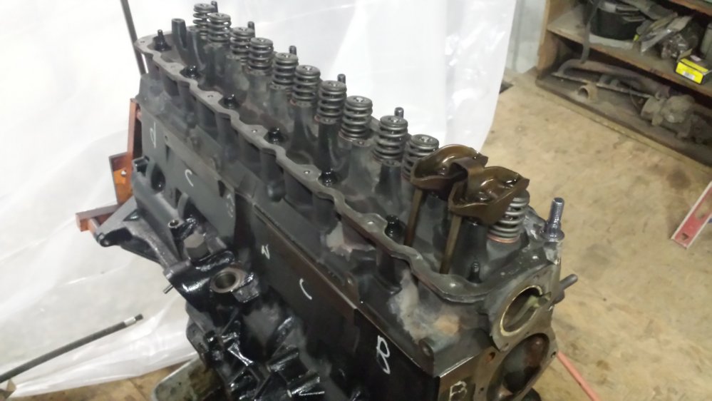

Had a little more time today to work on it. Got the head bolted on. Started checking pushrod length and as I figured the stock pushrods are to long. I have a checker tool that I will go back one night this week and determine the correct length to order.
Another interesting note is after degreeing the cam my timing marks on the gears do not line up. I had to retard one tooth on the cam gear to get everything in spec
Probably should have turned this into a build thread. But Anyways, a few updates. Measured for pushrods and figured out I needed around a 9.550 pushrod. I did get lucky while looking on Summit and find out a set of Olds 455 pushrods were 9.543 long and worked out to give me .035 lifter preload. Had them in quick and for about $6 each. Alot less money than custom lengths.

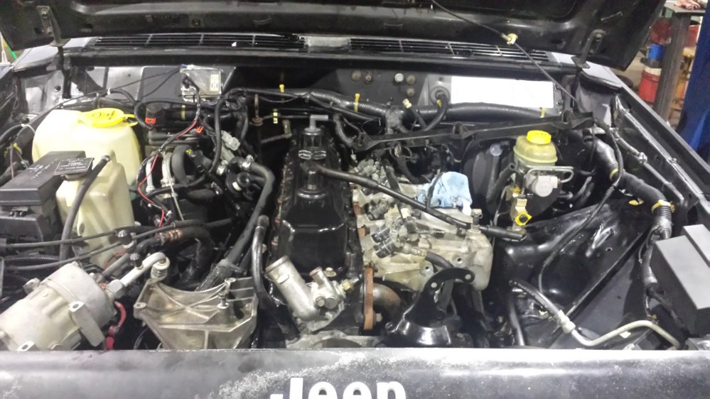

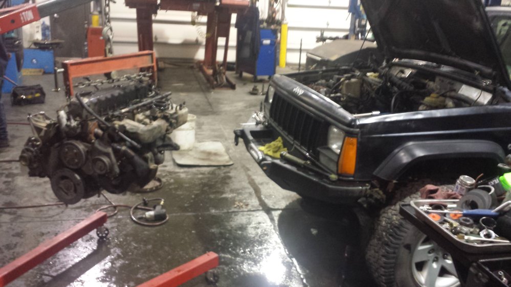

Pressure washed the engine bay and dropped the engine in after work tonight. Hope to have time this weekend to finish it up and break in the motor. Unfortunately I an not sure I will have my throttle body back from being bored out by this weekend so that may be a hold up. Also picked up a set of ford blue top 24lb injectors for it.
