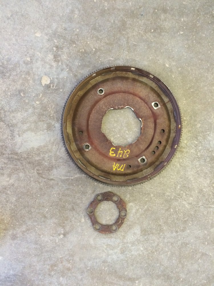

So the more I have listened to the knock it is right at the back of the engine. I'm wondering if anyone has heard of the trans (AW4) making a strong sharp clacking/knocking noise. I'm thinking maybe the pump is broke or???. FWIW when the jeep is cold it is barely audible. Once is warms up it gets Loud. It still engages R and Drive although I'm afraid to drive it for fear of a catastrophic melt down. The trans was out 2 years ago for a new torque converter and I had the pump replaced and all the seals. They said the rest of guts were good to go so they buttoned it up and I put it back in the XJ. I had driven it quite a bit after without issue. The Jeep then sat a while during the 1 ton swap. It seems this issue has all happened very quickly. Looking for thoughts.
Torque converter bolts tight?
Yessir. Checked them yesterday and reapplied red loctite. I have been watching some YouTube videos of cracked flex plates and the noise is the identical but the rythm is different. Mine is very methodical and directly related to engine RPM's while most of the videos have more of a lope or irregular pattern to the knocking.

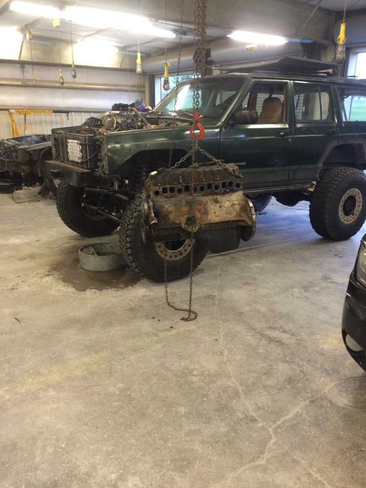

So @Blaze is getting me a great deal on a long block shopped down here. Yesterday I took my XJ over to the car shop here on post and pulled the motor. It was definitely the flex plate!! Only took a light tap with the hammer for it to fall into 2 pieces!!
