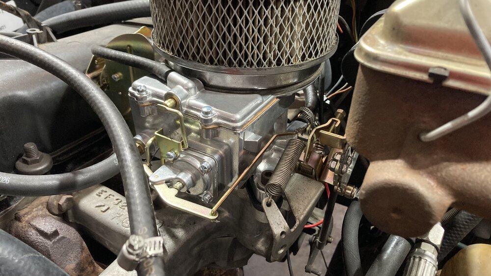

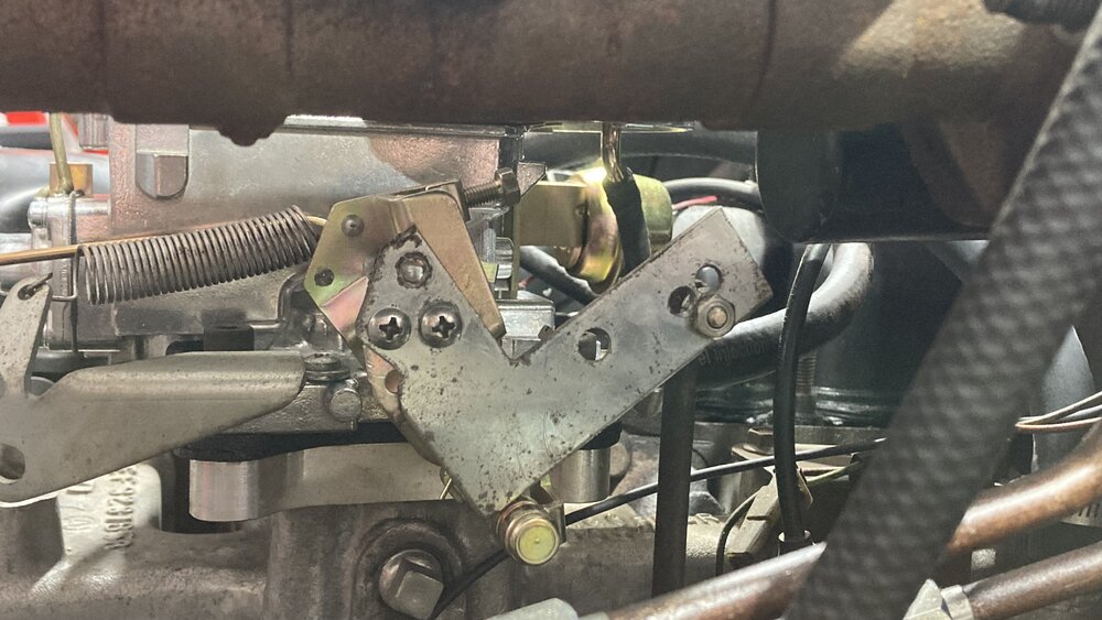

Thinking about the 2100 swap.
The adapter plate is a Mr Gasket part. No problem. Then there’s the throttle linkage. Mc2100 pulls back to the firewall, while the BBD pulls down. Need to sort that.
There’s also the heat rise tube on the 2100. Does that really matter? I feel like I plugged mine off on an old AMCv8 I had.
Anything else to think about?
It’s a pretty easy swap. I made a little bracket for the pull down cable and blocked off everything else.
FWIW I’ve been daily driving on one of those Amazon 2150s for about a year now without a hitch. Only thing I did (and would recommend) is to jet it for your needs and put a decent power valve in it.
It was back in 2001 I swapped a 2100 on my 87 YJ. So I may be a little off here. But I swear I used a throttle cable off a early 80s Ford van with a carb. It was really long and fit the YJ gas pedal too.
May wanna look into.that.

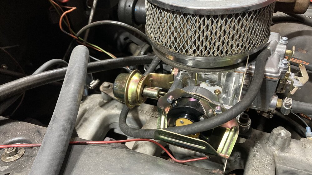

@orange150 In this picture:
Is that plug in the manifold below the carb where you brake booster was sourcing vacuum? Mine is there and interferes with the throttle linkage. I’m guessing you moved the brake booster to the big port on the back of the base of the carb?
Edit: that won’t be low enough for brake booster. I need manifold vacuum, and off the carb would be ported.
I'll take a Pic tomorrow where my booster vacuum is pulled from. It works with my weber and to my recollection, comes nowhere the carb linkage.

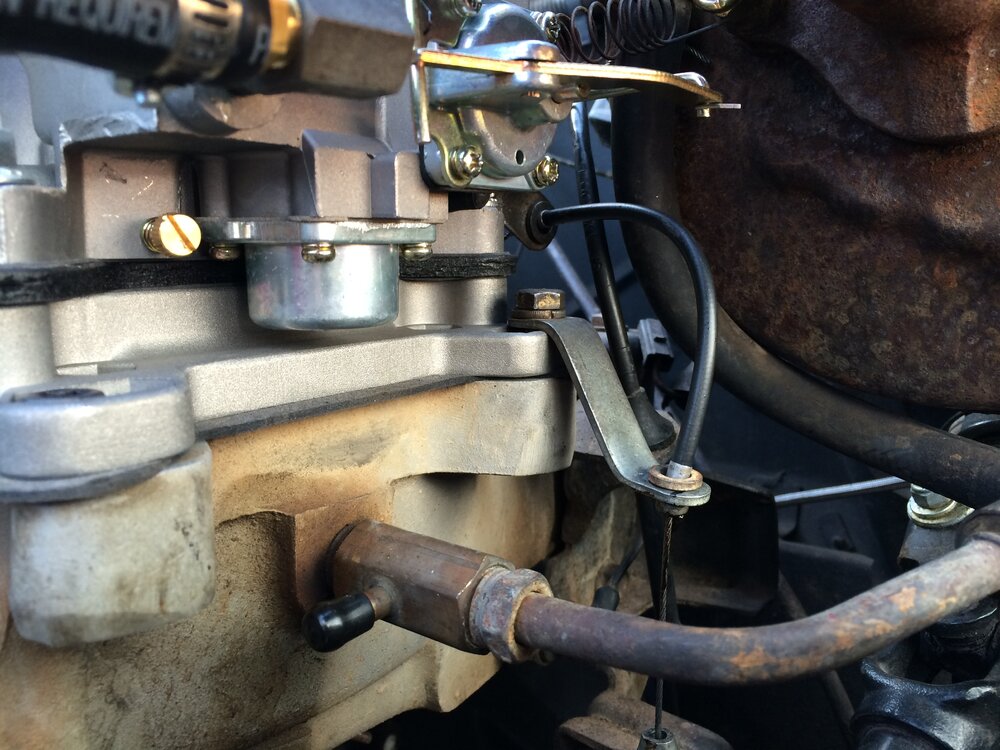

That is where my brake booster was hooked up. This picture is old so the setup is a little different.
