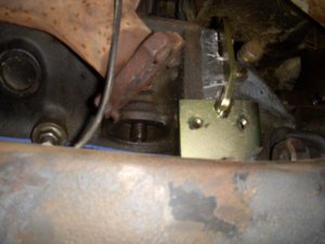

I am doing a V6 4.3 chevy swap into my FJ40 and on the drivers side the exaust mainfold is dumpping out right into my slave clyinder mount. What headers or mainfolds can I use to fix this so I am not dumping into this area. See pic below. The pic shows the slave clyinder bracket on the bell housing and the exaust dumping into it. Thanks

The Sanderson Block Huggers come out a good bit farther forward than that.
I also read that Howe racing has a hydraulic throwout bearing to allow using a remote slave cylinder ...no personal experience, just read that...worth checking into...
I'd go with the headers
