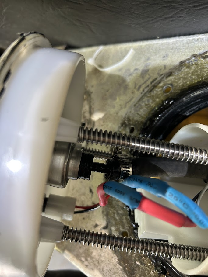

Looked in the tank while it was trying to run and saw what looked like a sprinkler spraying everywhere. Cracked the fuel line and routed it back into the tank and it was very, very weak flow. Pulled the pump out and found this.
Put a new pump in and a new piece of fuel hose and she fired right up and held idle. Drove it around the neighborhood and it did perfect. Much more responsive, held idle easily. I'll drive it around a bit more to set ECM fuel trims etc but I think she's ready to go.
I had the same issue on my 4.0. I replaced my line with 5/16 fuel submersible from Summitt. I believe I may have been using 3/8 or it broke down from the gasoline and would not stay connected.
